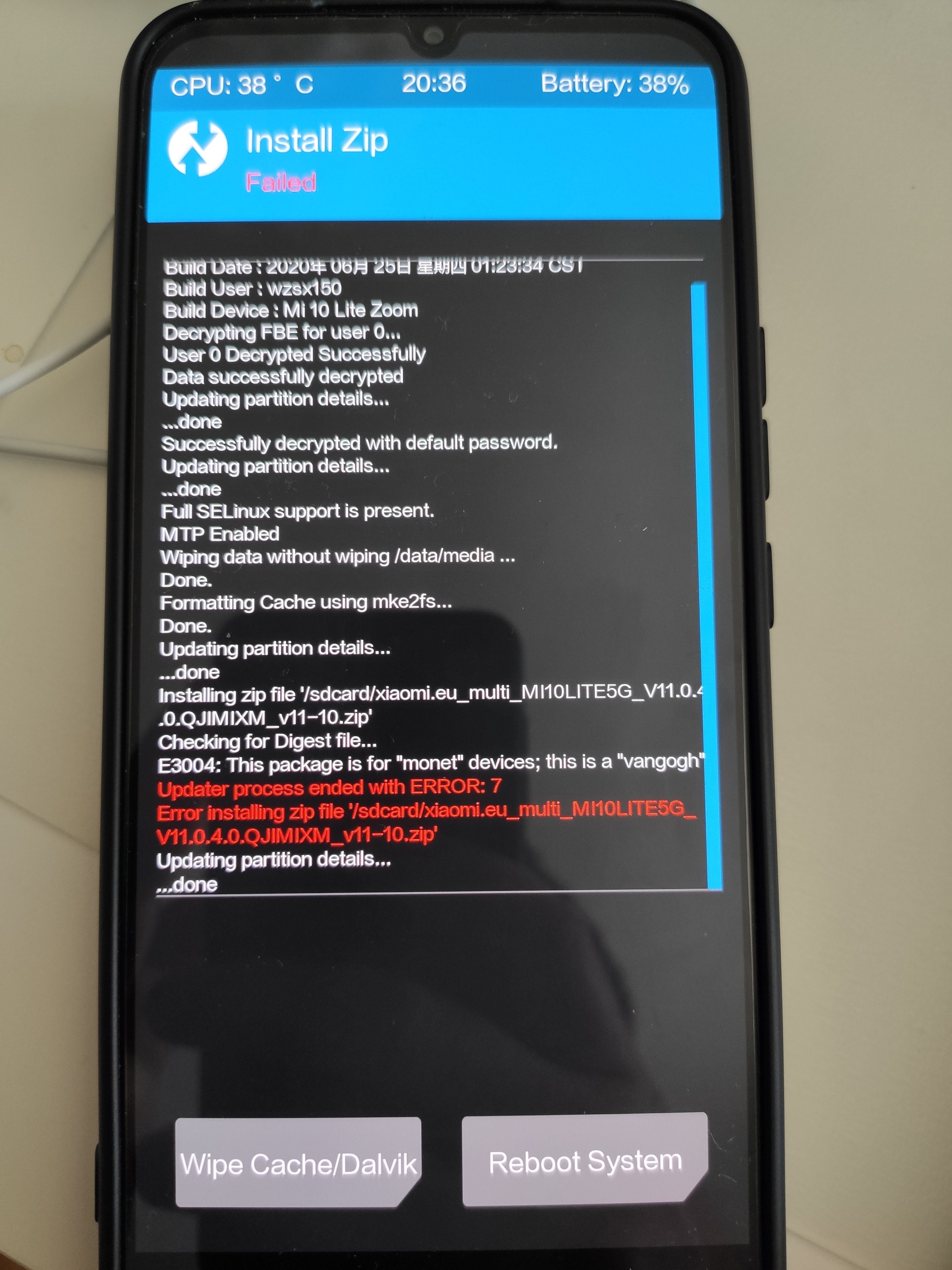

Where can I find TWRP_monet? Can you help me?
fastboot getvar product
clearly results in monet

That's normal because your vangogh TWRP is built with digest check for vangogh and should reject any other different updater script (eg: monet).I solved the problem and made xiaomi.eu V11.0.4.0.QJIMIXM work.
1. You need to unpack the zip-archive "xiaomi.eu_multi_MI10LITE5G_V11.0.4.0.QJIMIXM_v11-10.zip"
2. Then open the folders "META-INF" -> "com" -> "google" -> "android" -> "update-script" (open it with wordpad or similar)
3. Delete within the updater-script following text in the first row:
getprop("ro.product.device") == "monet" || abort("E3004: This package is for \"monet\" devices; this is a \"" + getprop("ro.product.device") + "\".");
4. Save the text and compress everything of the unpacked file to a new zip-archive.
5. Flash the new (changed) Xiaomi.eu-Zip on your phone.
After I did that, my phone started only in TWRP. So I made an advance wipe (Dalvik, System, Cache, Data, Internal Storage). After that, I additionally Format Data.
Thats it, the boot took some minutes, but now I am on xiaomi.eu with my Mi 10 Lite 5G (Monet).
Another question: I used the TWRP-3.4.2b-0625 by wzsx150, which is for "vangogh".
Will this be a problem for OTA-Updates or do I have to modify the updater-script every time from now on?
