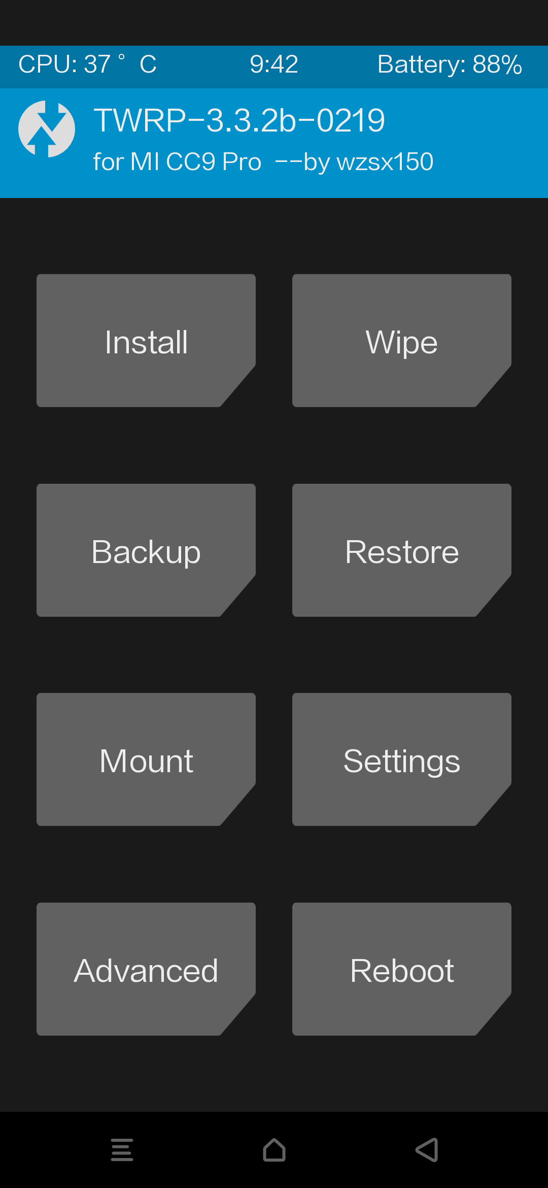

Which twrp version are you using? The latest twrp on the first post of the rom is working fine for me.
If you are using an older or different twrp. Just flash the latest twrp with twrp.
1. Go to Wipe, select Format Data, and type yes.
2. Go back and factory reset in twrp.
3. Sideload or use an otg drive with the rom.
4. Flash rom
5. Wipe dalvic and cache
6. Reboot and wait about 10 minutes for phone to boot up.

Thanks a lot men, i solve my trouble with your method, the real failure is a twrp version, work nice twrp 3.3.2b, i flash the revos rom with no problem.
