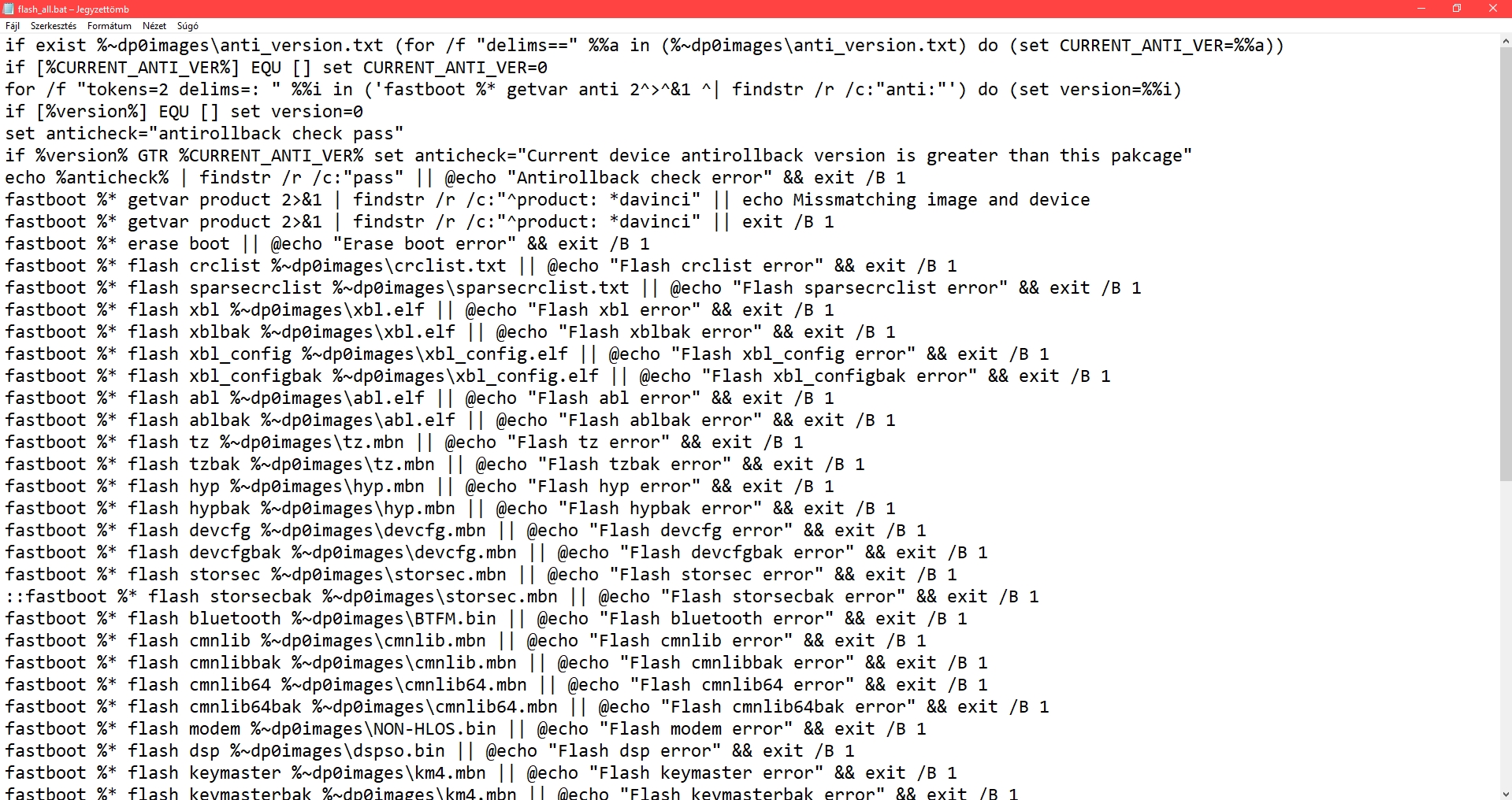

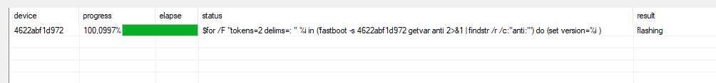

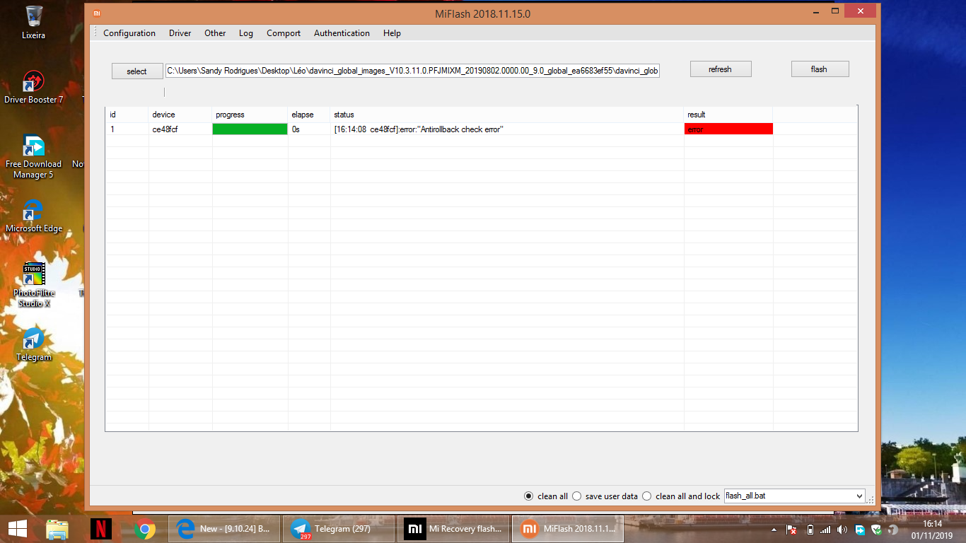

Sure. The way you mention it, it seems to be simple. It wasn't for me because I tried that a lot of times. Every fastboot ROM that needs to be flashed via Mi Flash has those installation scripts coming with it. Those script perform a anti rollback error check and that kept returning the error "Anti Rollback check error!" everytime I tried to flash the ROM on my device.
I have fixed this issue by editing those script, removing all rules on the top of the script that performed the anti rollback error and runned the flash again. It returned an error after the flash but my phone booted up finally and everything works fine now!

Hy,
I have just deleted the part of the script that performs the checks. Remove that part until the fastboot commands begin.

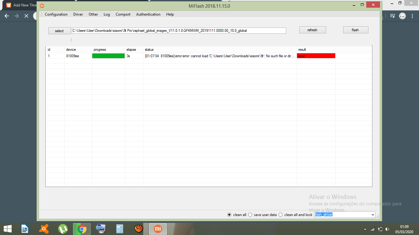

I'm confused. Should I edit flash_all.bat script, or something outside of ROM files, in MiFlash? I could really use a screenshot or exact details. Many thanks!
I delete more than 2 lines in this and MiFlash tells me there is no such directory. Makes no sense.
[23:18:29]:1 21b3045b 0,6530995s [23:18:28 21b3045b]:error:error: cannot load 'C:\Users\MasterOpus\Desktop\MI-FLASH': No such file or directory

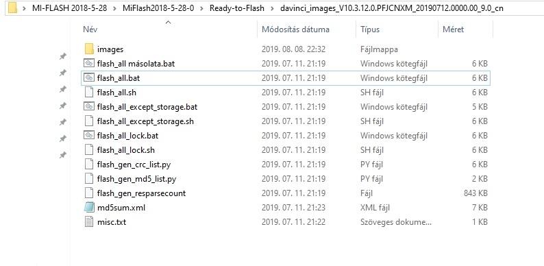

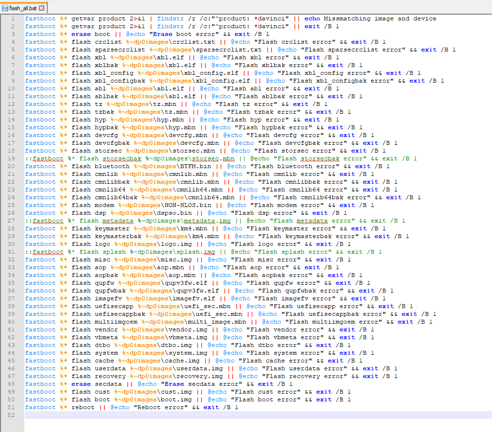

Hy,
You should remove all commands except the one that explicitly start with fastboot. Check my attached screenshot for the edited file.
About the error of the file that does not exists: I faced the same issue that MIFlash tool couldn't find my flash_all.bat after I had edited it. I solved this by moving the whole package directly on my E: drive. So the path had become "E:\davinci_global_images_V10.3.6.0.PFJMIXM_20190603.0000.00_9.0_global\flash_all.bat" instead of "E:\*********\Desktop\adb\MiFlash20180528\davinci_global_images_V10.3.6.0.PFJMIXM_20190603.0000.00_9.0_global\flash_all.bat".

Use the last version of Miflash
Unzip the ROM to C:\
Open the file flash all.bat in the unzipped folder
remove all commands except the one that start with "fastboot"
Save the file
And flash this version
