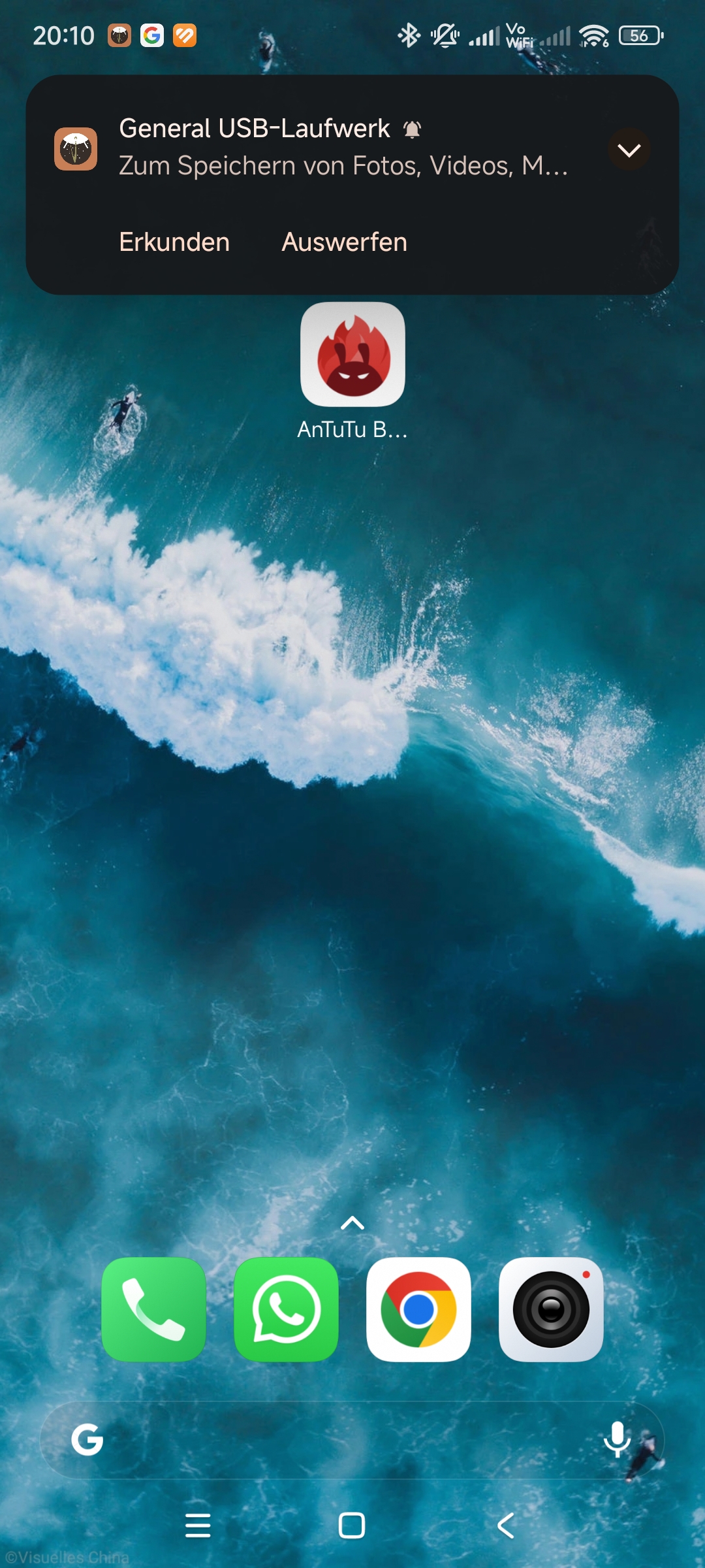

When I connect a USB device nothing happens...There is no need to have OTG option in the menu.
Just connect appropriate devices.
Are you sure the device can be powered by your phone ? Did you try it on another phone ? What type of device is it ?When I connect a USB device nothing happens...
It seems that there is no power in the USB device the led does not turn on...
It should. i try to connect regular disk on key and a camera both does not work... nothing happens when i connect them....Are you sure the device can be powered by your phone ? Did you try it on another phone ? What type of device is it ?
