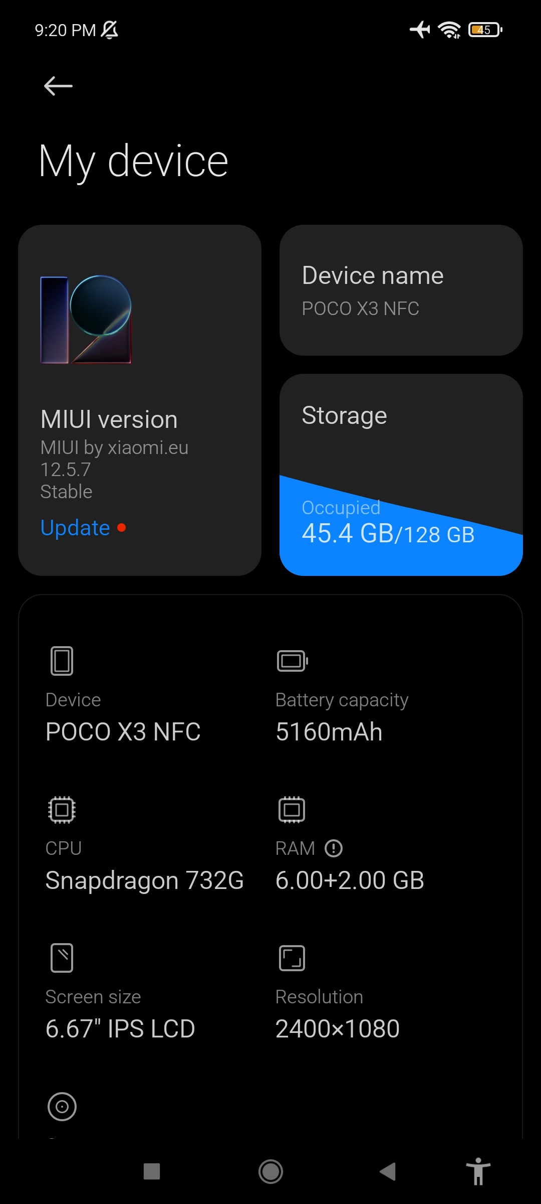

EU ROM but my MIUI version is RJGMIXM

And what is your problem?
You have a custom ROM from xiaomi.eu built on Global ROM (RJGMIXM) in your phone. That is right.

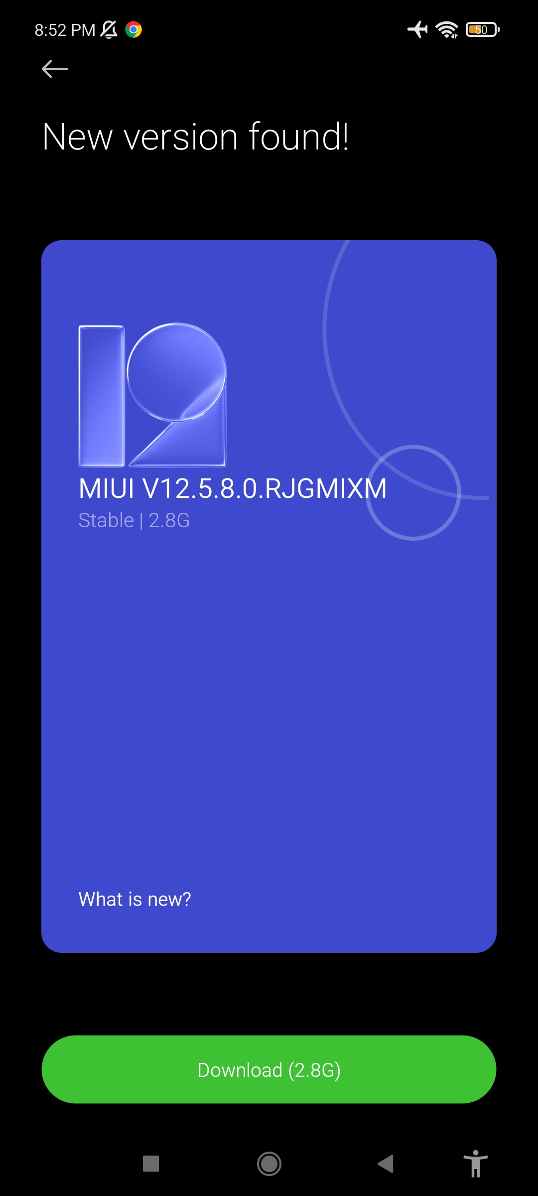

And whem I'm trying to update this is the outcome, RJGMIXM which is global miui version but im eu rom

That is right. It is an update of the xiaomi.eu ROM
I don't understand what you want. Do you want to install xiaomi.eu ROM?
Or do you want to install the official ROM?
I want to stick on EU Rom, I only want is to downgrade from 12.5.7 to 12.0.9 but still eu rom

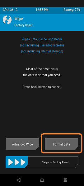

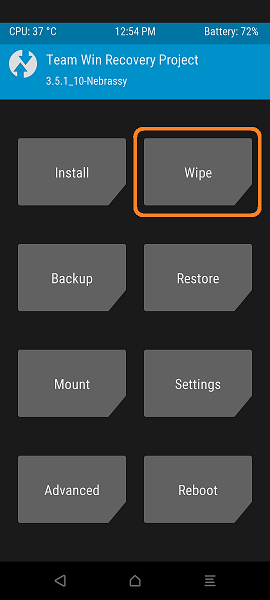

After installing in recovery (TWRP) you need to do Format Data!
- reboot to TWRP (recovery)
- Install ROM
- wipe / Format Data / YES
- reboot system
- Done
