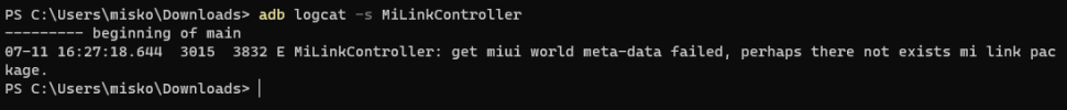

OK, that's odd. I need you to try something. Connect the device to PC and reboot it, as soon as it's booted, run this command:
Code:
adb logcat -s MiLinkController
Write the output here.
Code:
--------- beginning of main
07-11 16:27:18.644  3015  3832 E MiLinkController: get miui world meta-data failed, perhaps there not exists mi link package.

Code:
The message indicates that the Cast app (MiLinkService.apk, package: com.milink.service) is missing.
I checked the ROM, it's not missing there.
