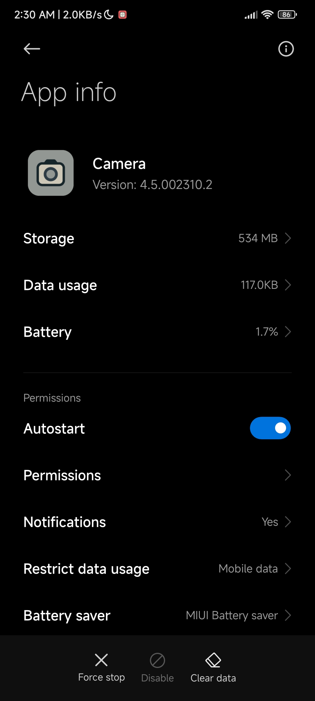

Bruh wth is wrong with my Redmi K60? Can u check what version your camera app is running on?

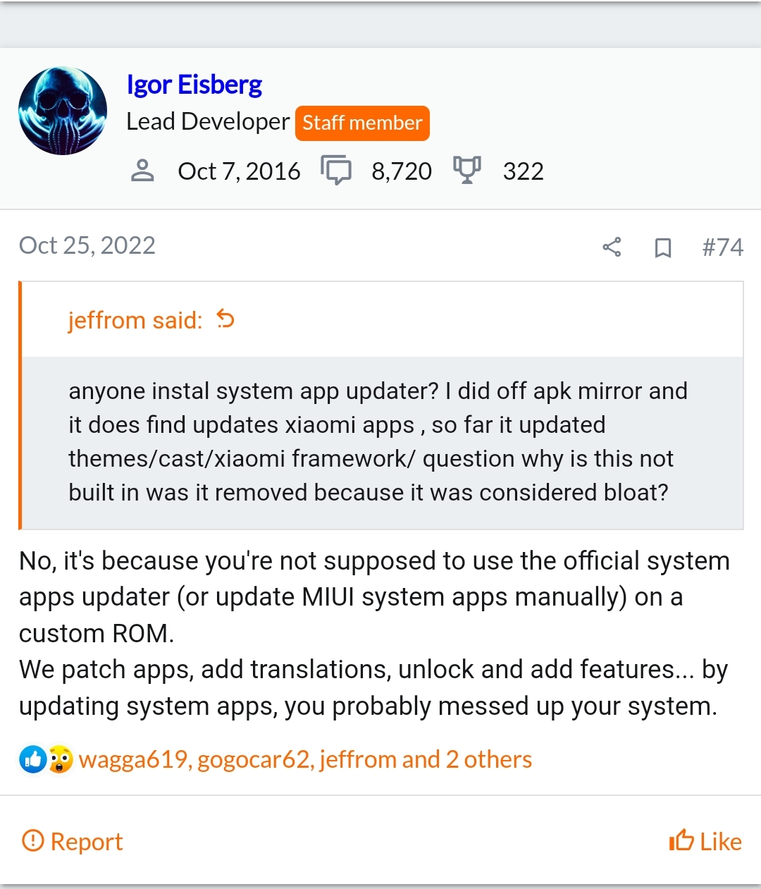

A gentle reminder, please do not update any system apps ya. If you have accidentally update the system app, it might be some problems or bugs will appears. You can uninstall the update in app info

I don't think I updated any system apps. I noticed this bug almost immediately after I did a clean install of the Xiaomi.eu ROM. Also, I did try to clear the cache and delete the data of my camera app, but the bug is still there. I cannot find any way to "uninstall updates" for the camera app in app info.
And thanks for providing ur version number. But it doesn't help coz mine is exactly the same as yours, with the only difference being that ur camera app icon is different from mine. But u probably just installed a skin that's all. Mine is the default theme. So, idk what is wrong with my camera app and if it will ever be fixed :c

I did answered your question
Please check back the previous conversation.
Or you may refer to the screenshot attachment below.

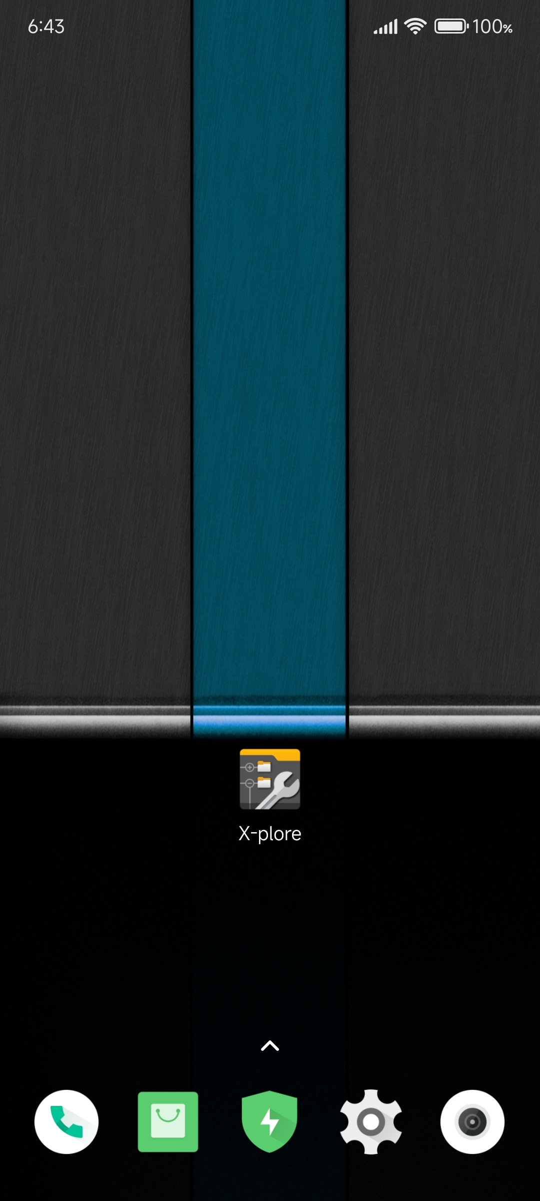

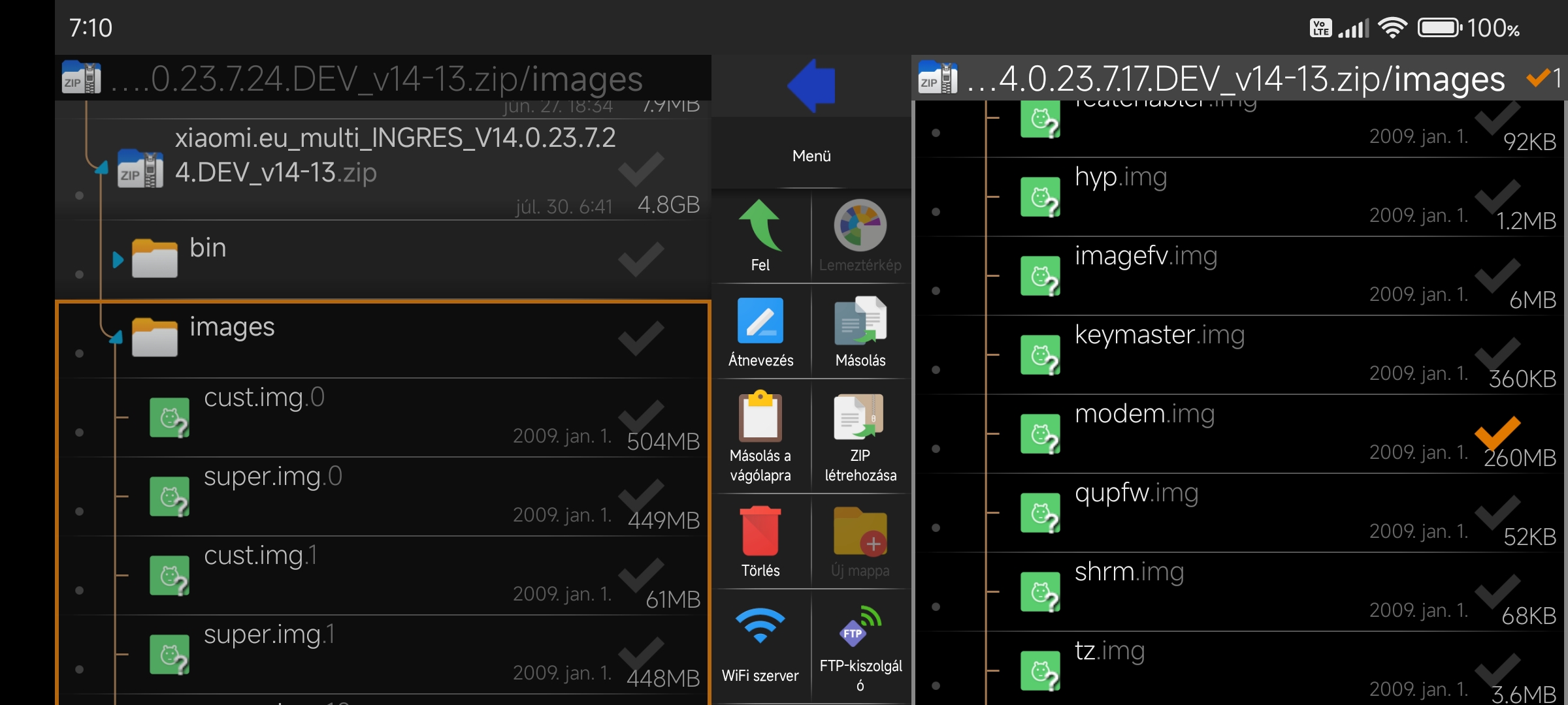

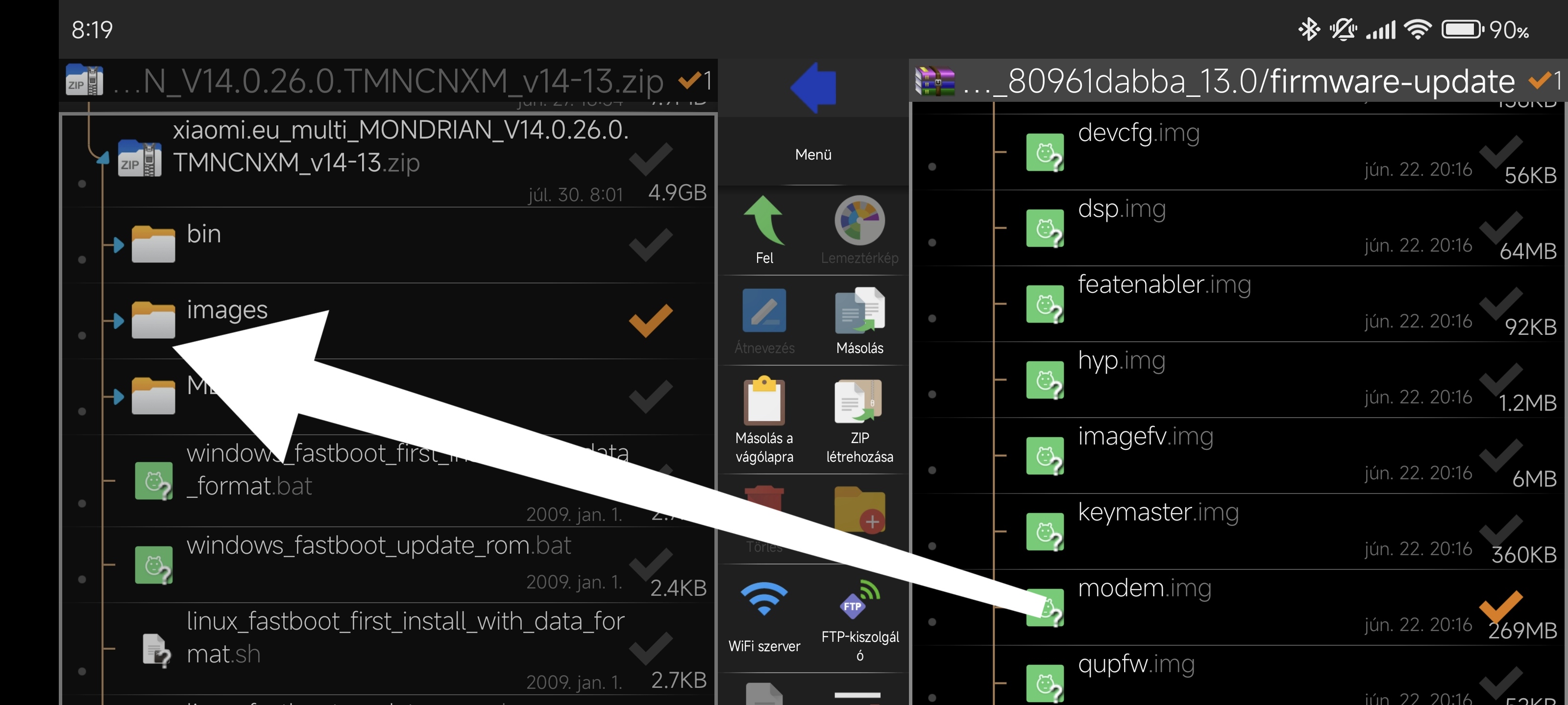

I tried it with Poco f4 gt.
X-plore file manager makes it very simple.
I copied it from last week's dev to the latest weekly.
First I opened the new zip. (it should not be unpacked)
X-plore file manager and many similar two-window file managers allow you to delete modem.img from the images folder.
Then, in the other window, I accessed modem.img in last week's dev in the same way.
I simply moved/copied this to the new images folder.
The file manager does not modify it, just copy from the folder to the folder.
Ready. Then I tried it with TWRP. Success.
The same procedure from Global /EEA
I also tried it with Poco f5 pro. Managed!
