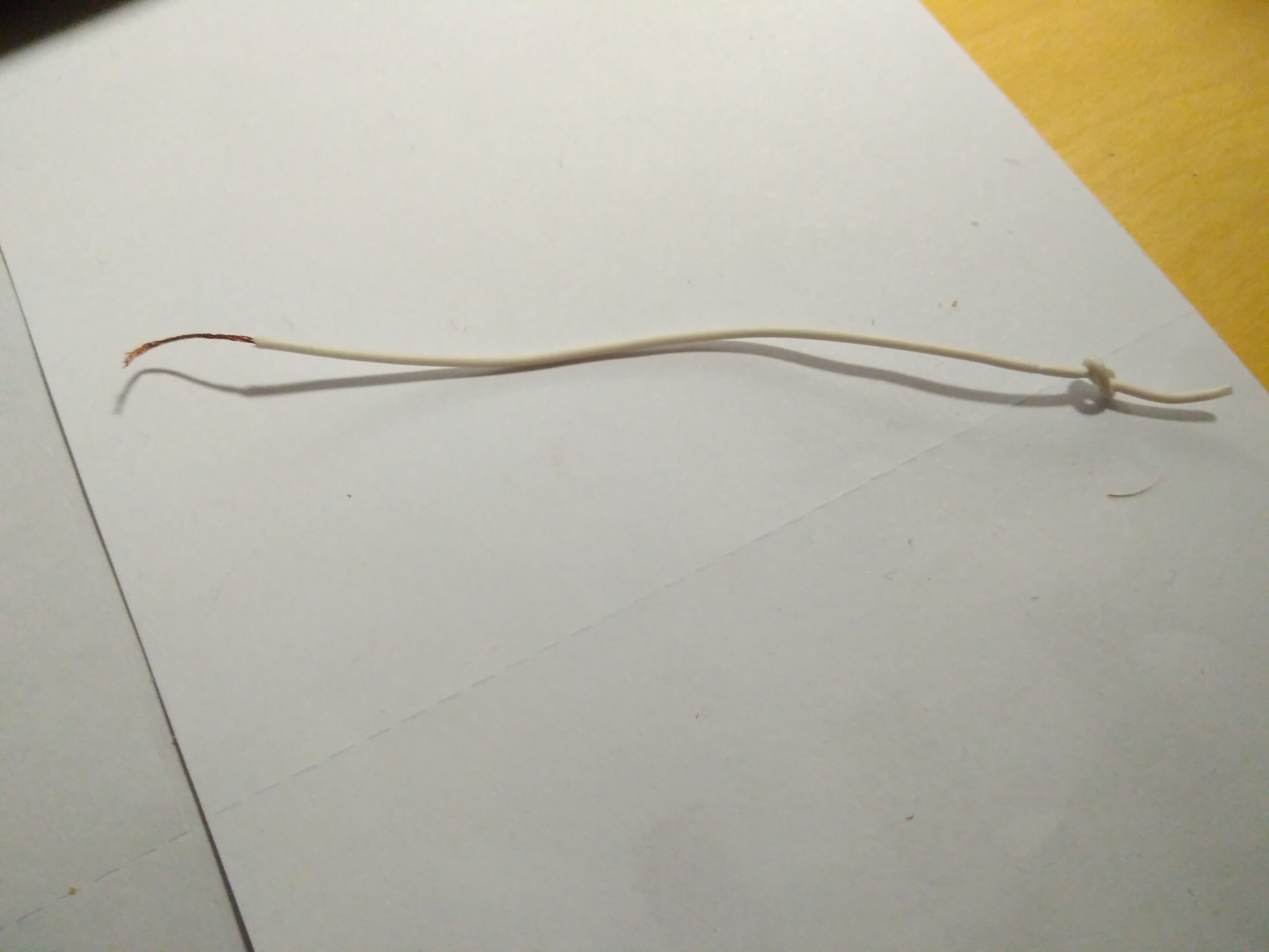

Hi there,
I also couldn’t wait to get the real unlock code from MI or my Redmi 4 Prime so I bricked my phone quite fast.
So I saw for a second the MI logo and then my screen went black. In the device manager of my PC I only saw a 906E device. To get it to 9008 I followed this instructions:
en_._miui_._c_o_m_/_thread-310325-1-1_._h_t_m_l
y_o_u_t_u_b_e_._c_o_m_/_watch?v=xFeNSj3ngXY
For realization I just used a wire of a network cable which did it pretty well, see attached picture
After I got my device in 9008 mode I flashed it with MiFlash 2010.08.30.0.
Then I could flash the Chinese firmware and now I am trying to be patient to get the real unlock code from MI…
