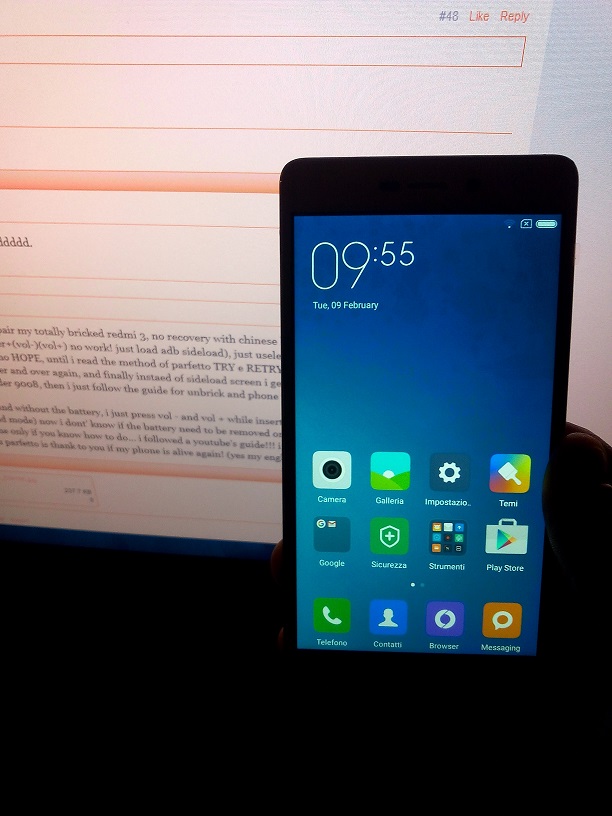

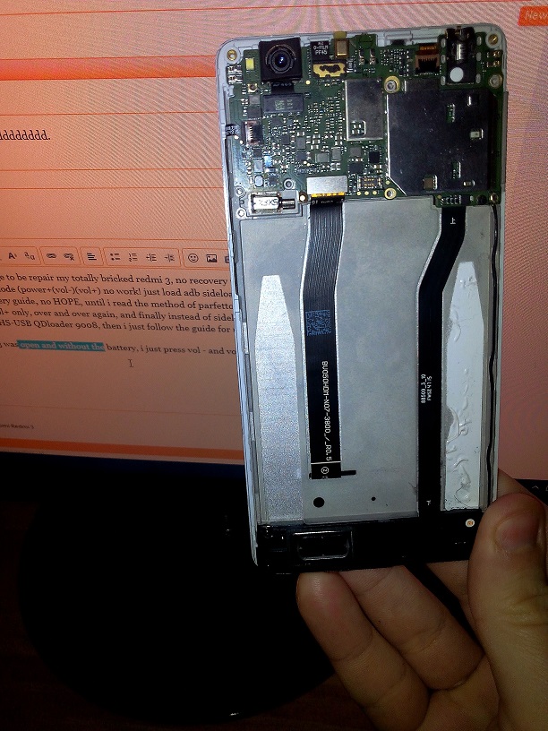

HI i was follow this page to be repair my totally bricked redmi 3, no recovery with chinese language (pressing power+(vol+) no work), no download mode (power+(vol-)(vol+) no work! just load adb sideload), just useless fastboot with his stupid locked bootloader, i tried every guide, no HOPE, until i read the method of parfetto TRY e RETRY , so i start to reboot the phone pressing vol- and vol+ only, over and over again, and finally instaed of sideload screen i get a black screen and O_O phone was recognized in HS-USB QDloader 9008, then i just follow the guide for unbrick and phone work again with miflash ^^!!
Note: my redmi3 was open and without the battery, i just press vol - and vol + while insert and remove usb to reboot phone until black screen (download mode) now i dont' know if the battery need to be removed or you can just use power to reboot, try yourself and open the phone only if you know how to do... i followed a youtube's guide!!! i hope to help somebody in my situation! really thank you parfetto is thank to you if my phone is alive again! (yes my english sucks it's not my language :D)
