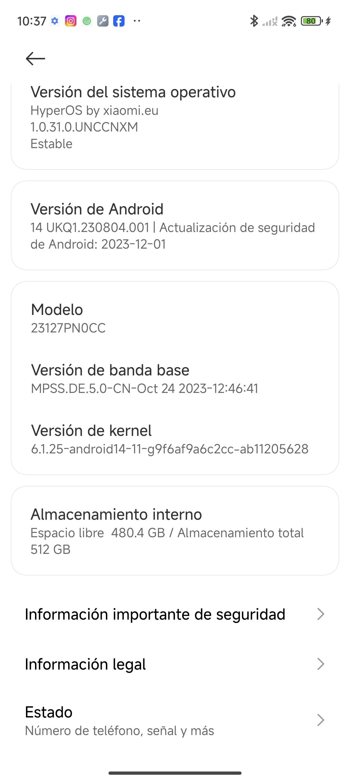

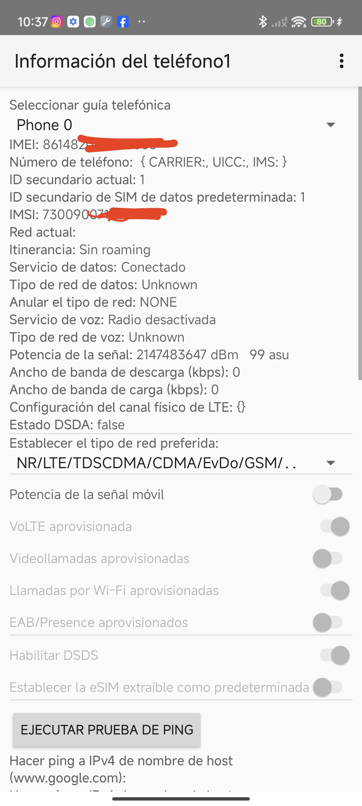

I need help with my Xiaomi 14, after install Xiaomi.eu ROM, i lost radio mobile, i put my simcard and recognizes, but i cant call. Before this rom, the phone has a HyperOS "global" rom and all works fine.
Sorry for my english
Thank you
Well, we have a tester from Europe with a Xiaomi 14, and everything works fine.
And i tried to flash others MODEM but it doesnt work :( (cn version and Xiaomi eu modem)
I tried with different versions and doesnt work :(

Can someone help me please? :( i don't know what can i do and my phone is dead (no calls, like a tablet)

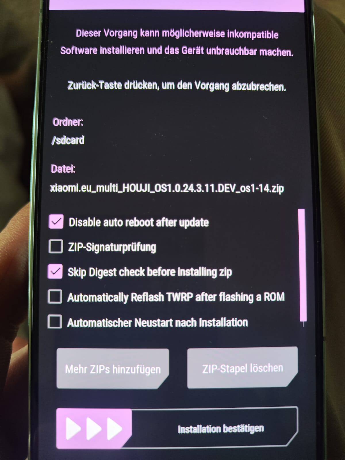

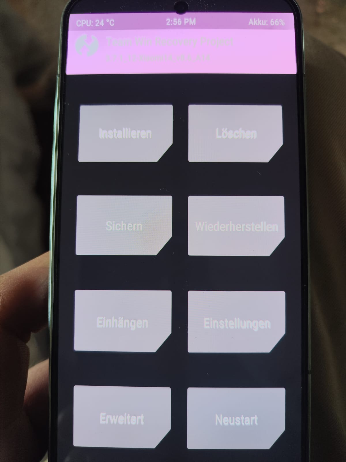

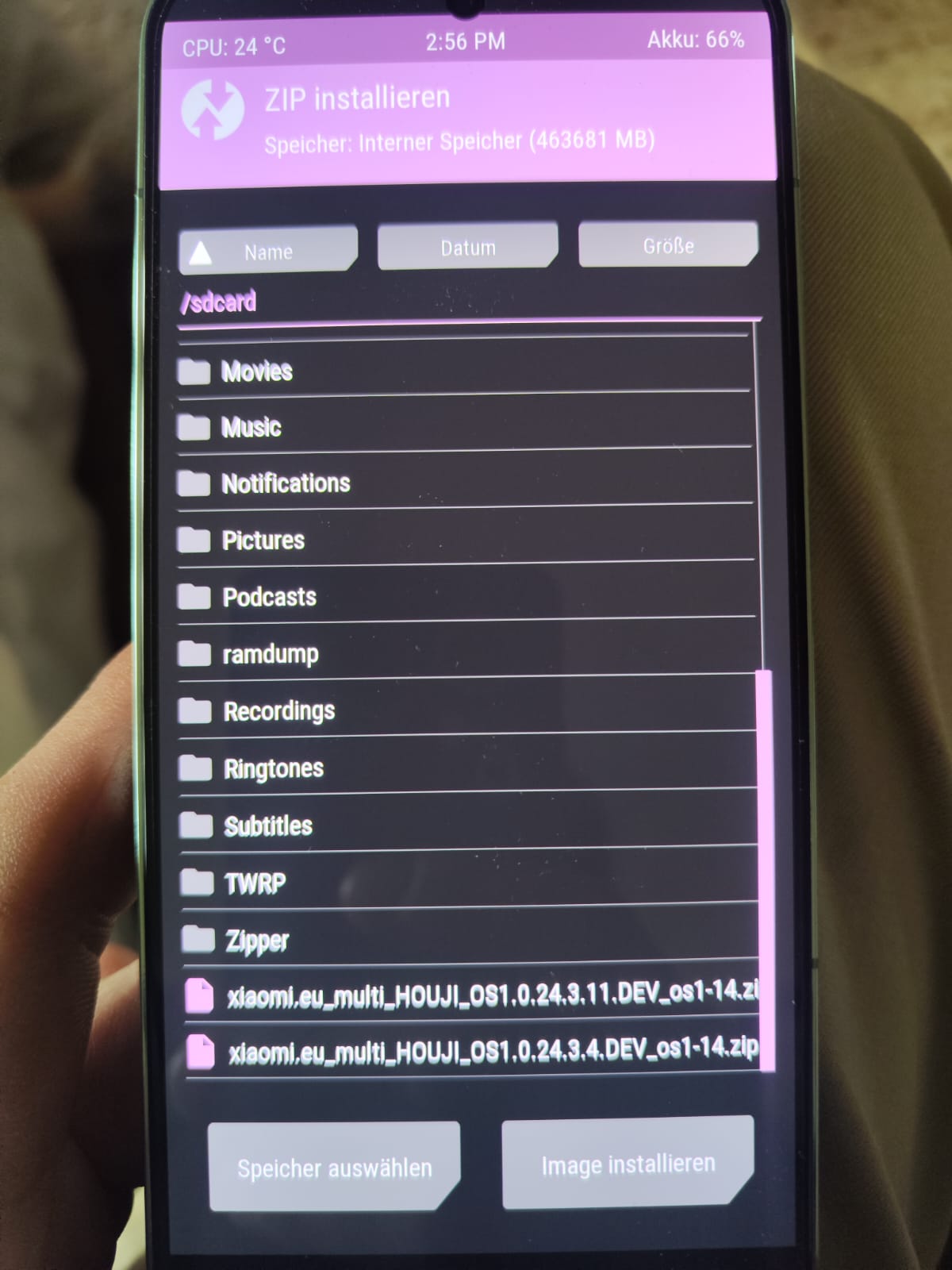

is it possible to flash modem/modem_firmware via TWRP? wich Partition/folder to choose in TWRP?
The Twrp... 8.6 from sourceforge list, what i use, is all decypt, i install weekly second time from there...
TWRP asks in wich partition i would flash the Image but i dont know which, vendor,... etc.
Are you a magician or do you have not a Xiaomi 14 series device and write in the wrong forum?
As I said, TWRP for this series can't decrypt data. It's not possible to flash ROMs with TWRP, except you use OTG. Look here in this forum and you will find this clarification many times.
Reactions: gogocar62
Do you have a functional decryption in your TWRP for Xiaomi 14? I don't want to believe that.:emoji_thinking:
If you call magic the fact that you canceled the entire encryption of the mobile no verity opt encrypt , then yes. But that's not what I want.
