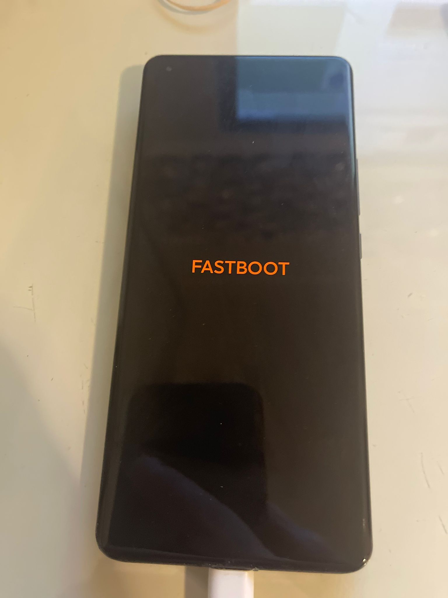

I changed the twrp long name to twrp.img and put it in the adb file. I connected the phone to my pc in adb mode ,logged off my phone and pushed him to fastboot mode,then i l wrote the command you tolď me and then dark,nothing. I didnt panick,i hold together the power button and the up button and i logged into my phone like nothing happened,but im still on twrp teamwin.
@jackyle So you can still boot the phone to your current TWRP and you are be able also to boot phone into Fastboot mode - only System doesn't start?
ok guys , ive flashed your twrp , but till now the phone is in dark mode and nothing is seen . is dead ! i disconected him from the cable from the pc and nothing

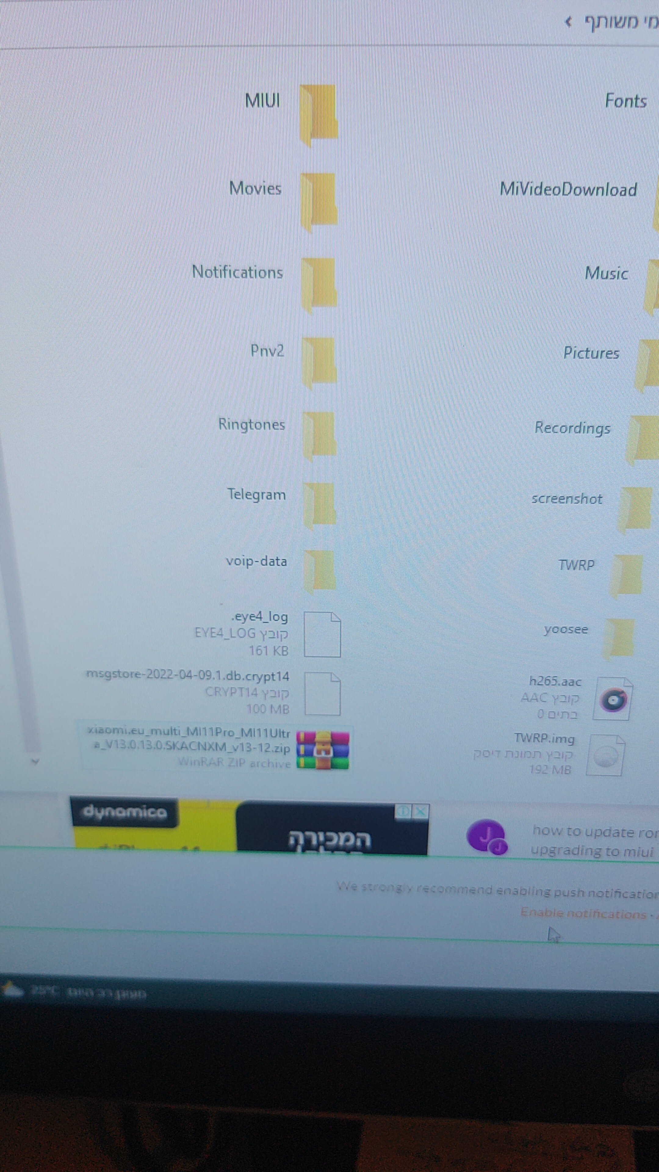

Copy the Rom zip file as it is to the internal storage:
https://sourceforge.net/projects/xi...1Ultra_V13.0.13.0.SKACNXM_v13-12.zip/download
Reboot your phone into Fastboot mode, use the command:
fastboot boot twrp.img
Phone should reboot to the new TWRP (let the whole process the USB Cable connected to PC, don't disconnect the cable).

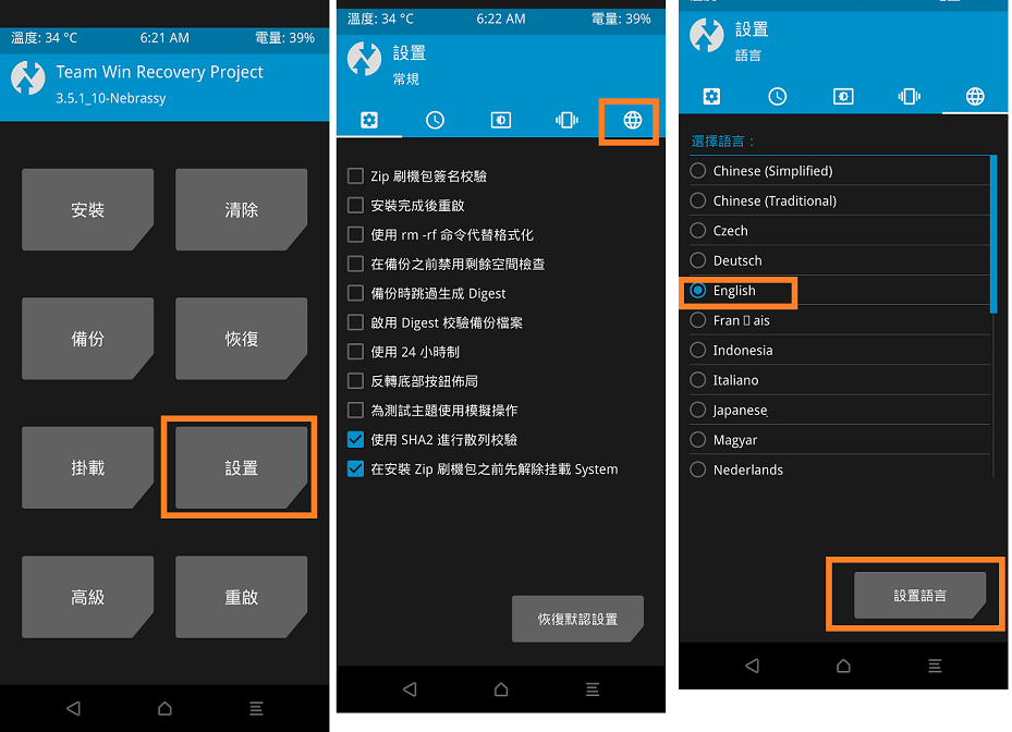

TWRP should start in Chinese Language, change language to your language.

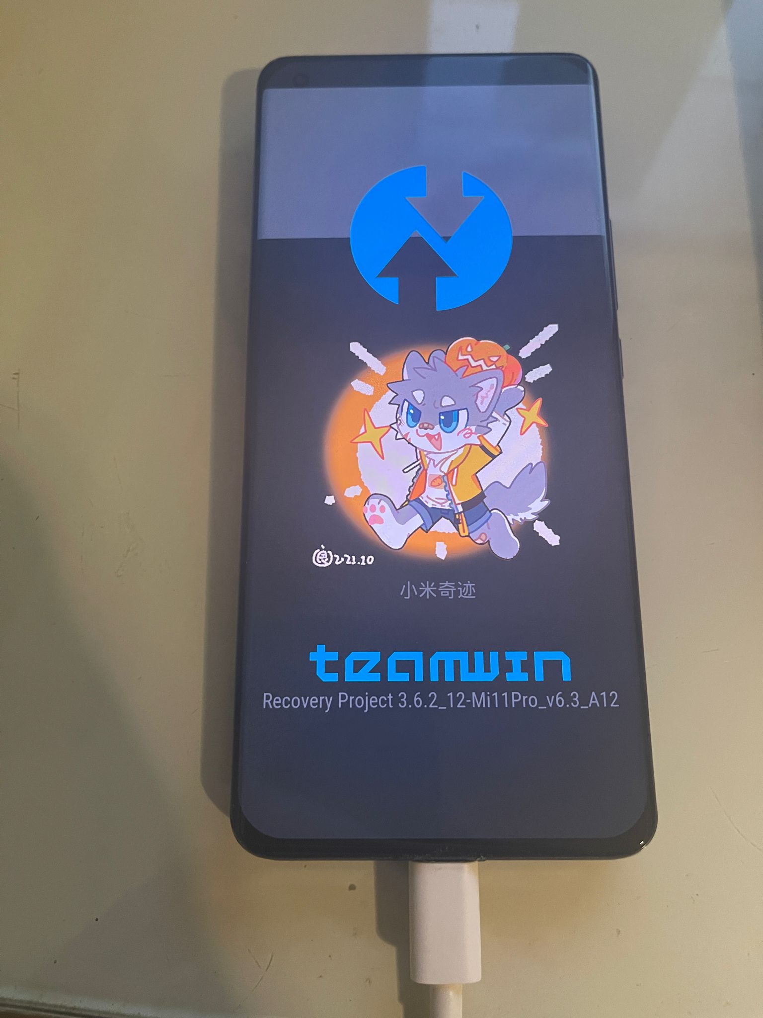

ok , seems like the teamwin twrp took over my phone and i cant install the "twrp ramdisk" , your twrp .
im trying over and over but nothing , i cant flash the rom and i cant change the twrp .
i attached few photos from the all process maybe youll find a solution , hopefully .
and again , sorry to disturb you guys , im following your command

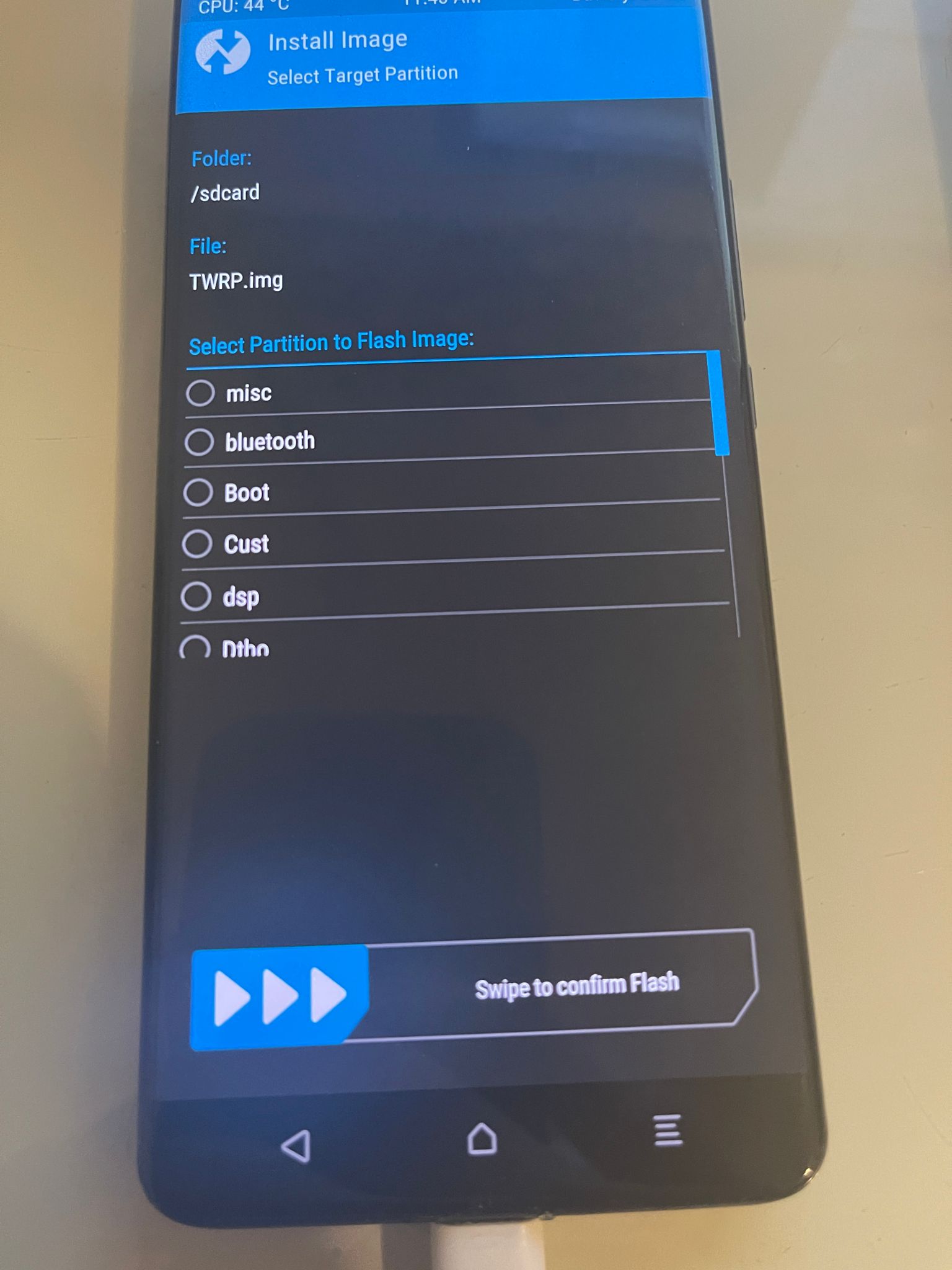

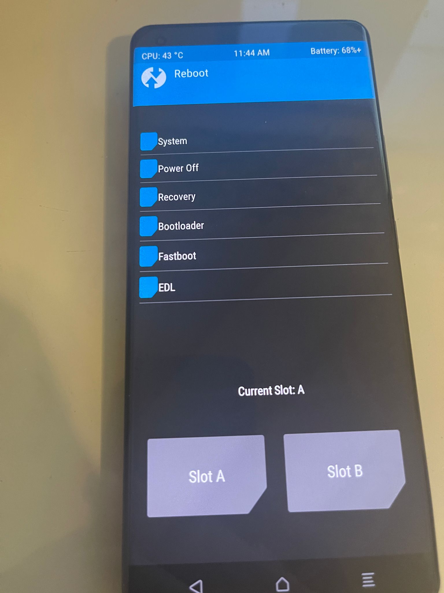

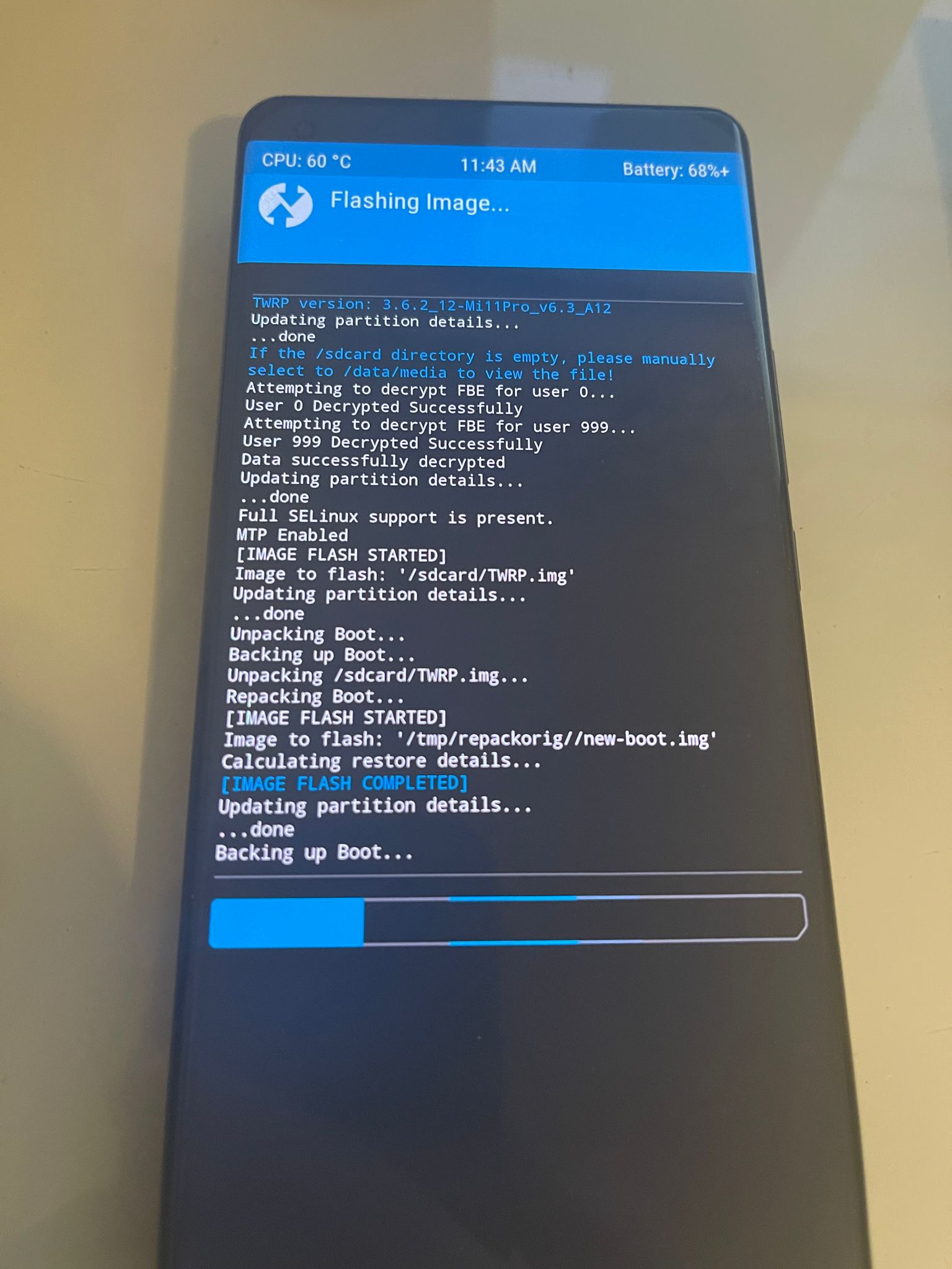

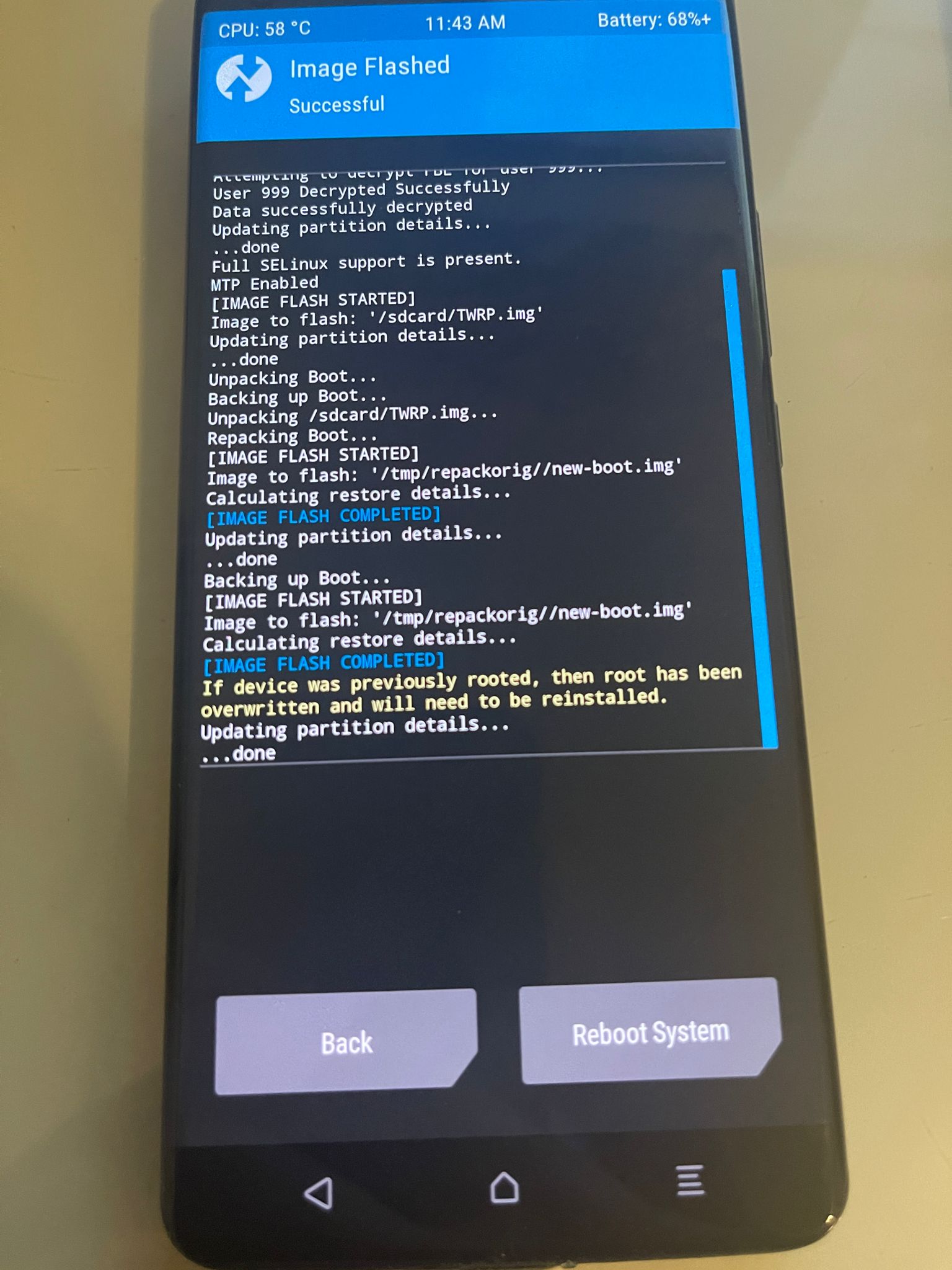

@jackyle On this "window" (see Screenshot) - you must use the blue line on the right and move it down - then you will see "Recovery_Ramdisk" (if you want flash TWRP)
You must flash this TWRP to this partition "Recovery_Ramdisk" and not to another place.
Soon it's flashed, go back to the main menu and use "Restart" Tab and select "Recovery"
This will reboot to the fresh installed TWRP.
Then try again to flash the Rom.
By the way - the Screenshot from the TWRP you have posted - this is the right one.

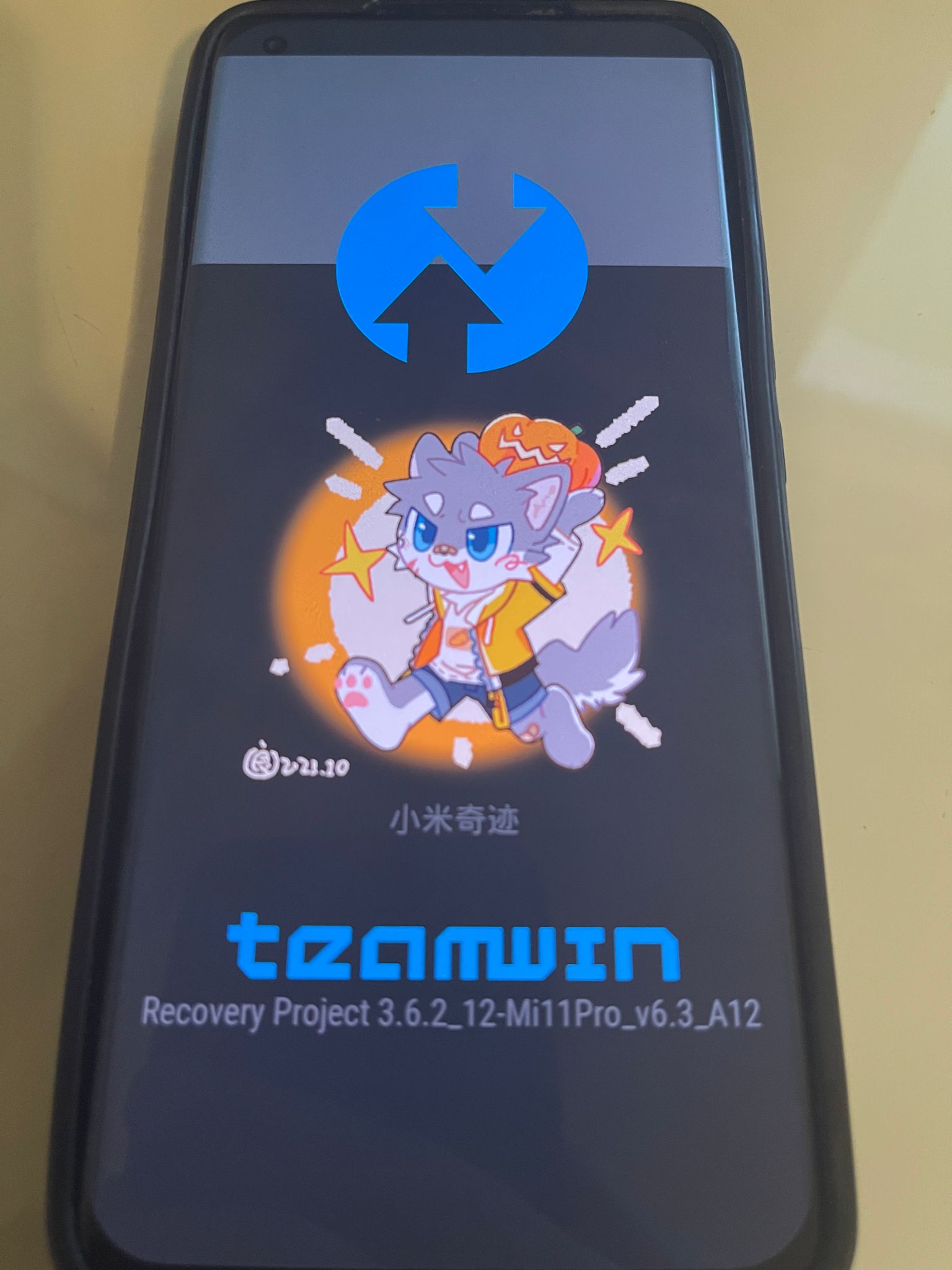

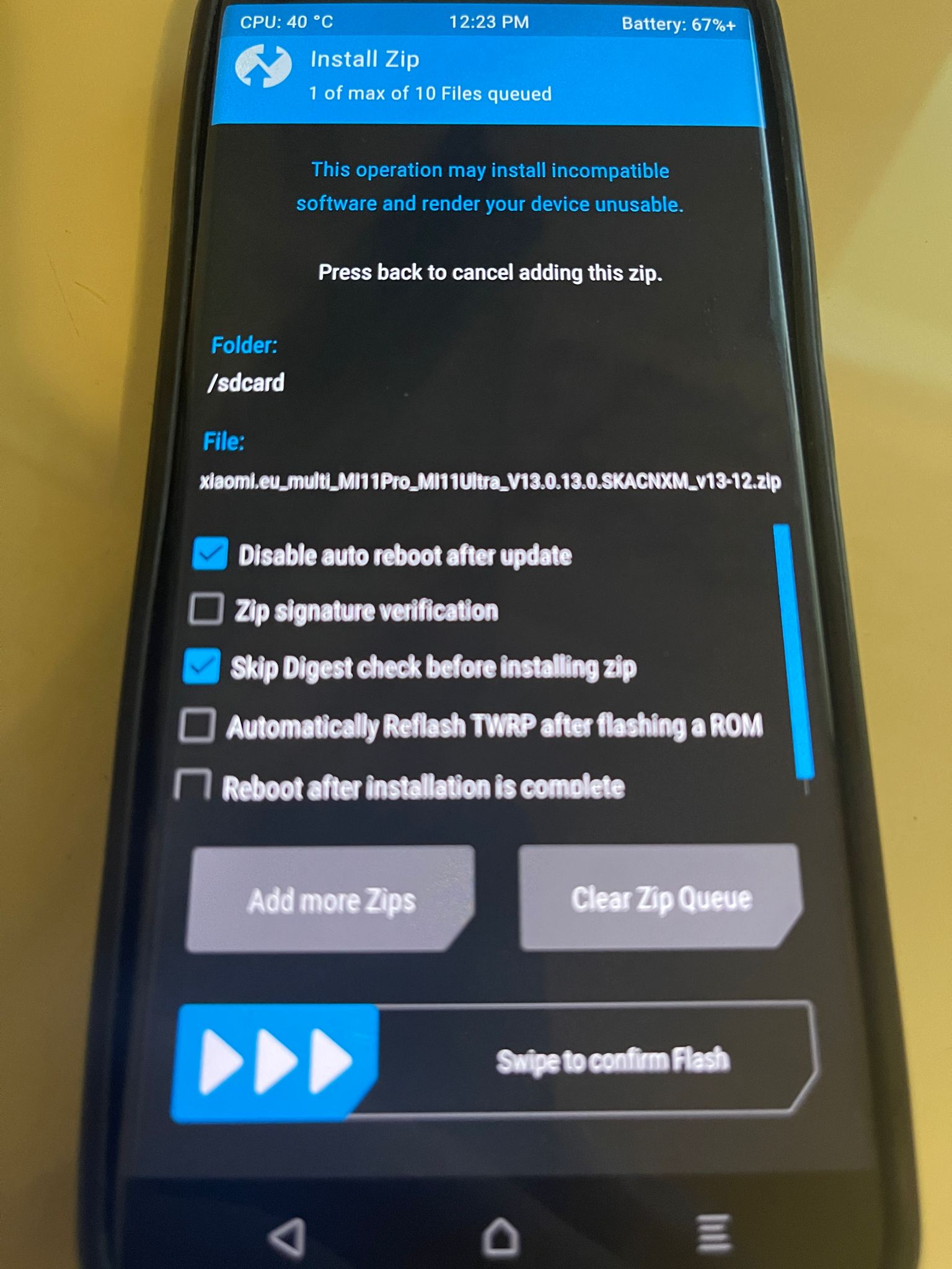

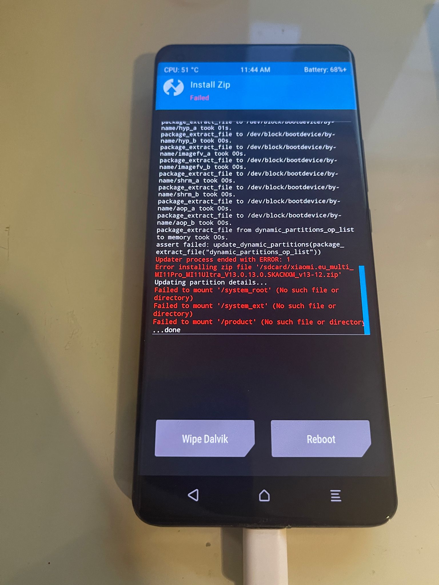

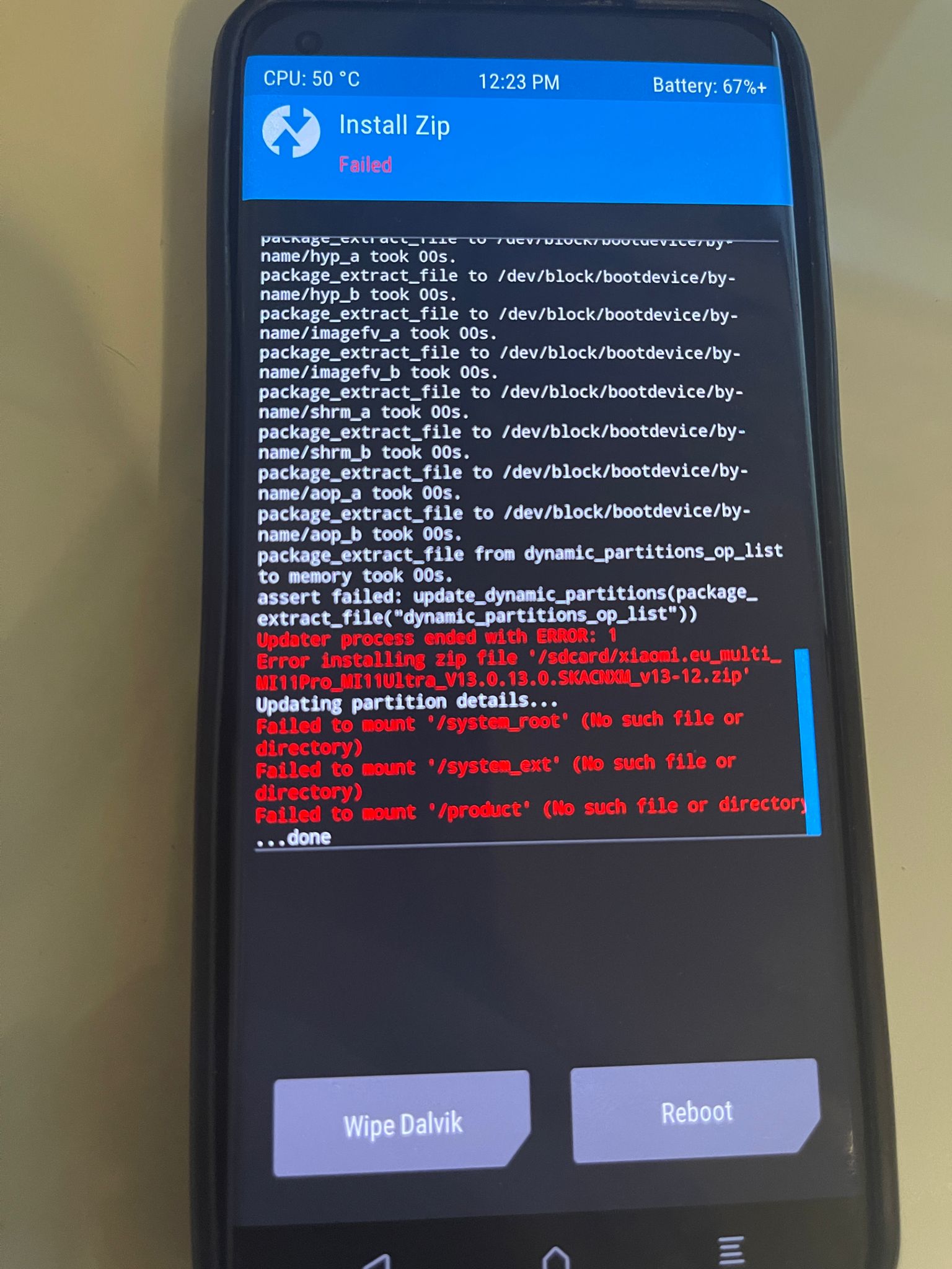

my friend , i did it now what ive done before - flashing the "twrp.img" (your twrp) to the recovery partition which called ramdisk .
then i clicked on the button from the menu- "restart" and then choosed -"recovery" , and i arrived to the same place before and i dont know even if im still on my old or on the new twrp , i took a picture .

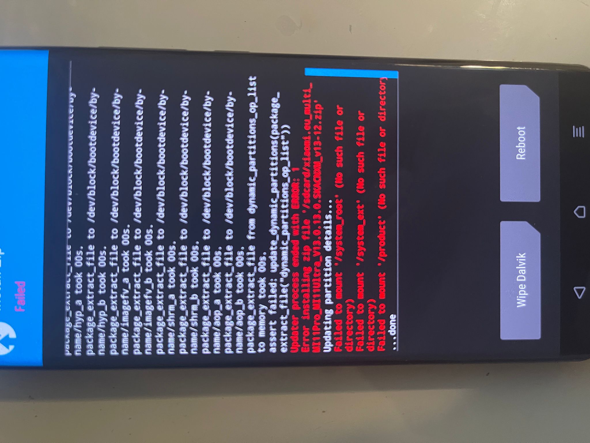

after all i choosed the zipfile of the rom , flashed it , but "failed" .
believe im doing well according to your instructions .
according to the pictures ,am i on the new twrp? your twrp?
if yes , why cant i failed in flashing the rom?

@jackyle Yes, this is the new TWRP.
I must think about it and will reply later.
but its not written anywhere "ramdisk" , so how do you know that this is it?
if imon the right twrp , then , why cant i flash the rom? maybe something wrong with the rom file?

2.i didnt understand why the rom that ive been flashed is failedd? whats the reasson if the flashing is by the new twrp?
@jackyle I don't think it could be the reason.
There's a workaround, posted by @katerpanne here:
https://xiaomi.eu/community/threads/howto-install-recovery-image.66211/post-662483
"TWRP update shows ERROR: 1 / can not mount system ...
- this error can occur if you try the update with updater app or if you started TWRP manually
- Solution:
-> while you are in TWRP reboot your device in recovery mode
-> try to install the rom again
-> if it will fail, reboot in recovery again
-> or use "fastboot boot twrp.img" again
-> sometimes you need more then one try
-> if it will not work choose another twrp version"
(reboot Recovery means to restart TWRP Recovery from TWRP "Restart - Recovery")
The last point means, you can try it with one of the the previous version of Android 12 TWRP, for example:
https://dl.akr-developers.com/?file=skkk/TWRP/A12/v6.2_A12/[BOOT]3.6.2_12-Mi11Ultra-Mi11Pro_v6.2_A12-star-skkk_6acd7c92.zip
(You use/have v. 6.3 and this link is v. 6.2 from same TWRP)
And you should check the md5 checksum of the downloaded Rom file. It must match the number, which is written on the download website under "i" (information).
Sometimes downloaded zip files are corrupted.
You can check the zip file for example with 7-zip, right click on the file - check archive file.
If zip file doesn't match the one from the download website, download the Rom again.

The second Link is a very wrong ROM file!
It's called "
xiaomi.eu_multi_HMK305G_V13.0.1.0.SGICNXM_v13-12-fastboot.zip and has nothing to do with your device!
Of course, if you try to flash this wrong ROM, it couldn't work!!
You said, you have a Mi 11 Pro - the right Rom name for this device is:
xiaomi.eu_multi_MI11Pro_MI11Ultra_V13.0.13.0.SKACNXM_v13-12.zip
I posted several times the right direct Link to this Rom in this Thread.
It seems to be you are very confused.
Again: if you own really a MI 11 Pro, then the right direct Link is:

my friend , if you click on the second link you arrive to this page - https://androidfilehost.com/?w=files&flid=331502
on this page you choose this file - xiaomi.eu_multi_MI11Pro_MI11Ultra_V13.0.13.0.SKACNXM_v13-12.zip
i dont know how you get to a wrong conclusion ...
its obiousslly that you wont choose a file with fastboot when you want to use the twrp ...
in the end , i have in my hands this file of the rom - "xiaomi.eu_multi_MI11Pro_MI11Ultra_V13.0.13.0.SKACNXM_v13-12 " , and right now im waiting for the rom file that going down from this link page - https://sourceforge.net/projects/xiaomi-eu-multilang-miui-roms/reviews/ ...its very slowwwwwwww , but the name of the file is the same like in the other link - "xiaomi.eu_multi_MI11Pro_MI11Ultra_V13.0.13.0.SKACNXM_v13-12"
sooooooooo , the both links page has the same rom . is it matter from where you download it if they are the same???
i think we have here more serious problem then the source of the rom
im waiting for a solution like the others on the other thread
