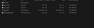

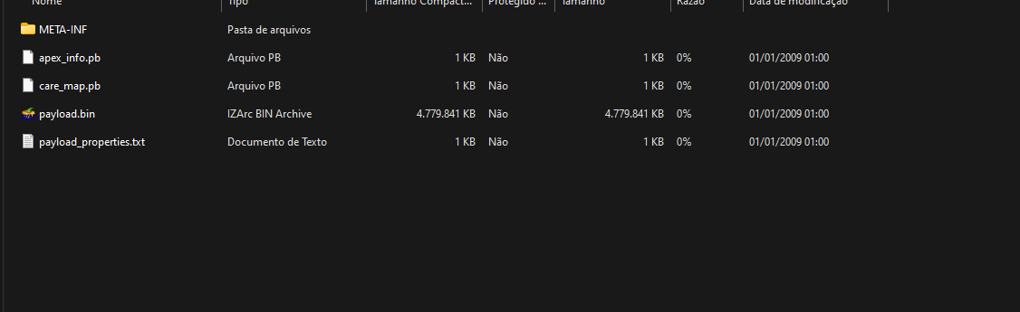

I downloaded the global version on this site, but when I unzipped it I couldn't find the file, how would the unzipping process be?

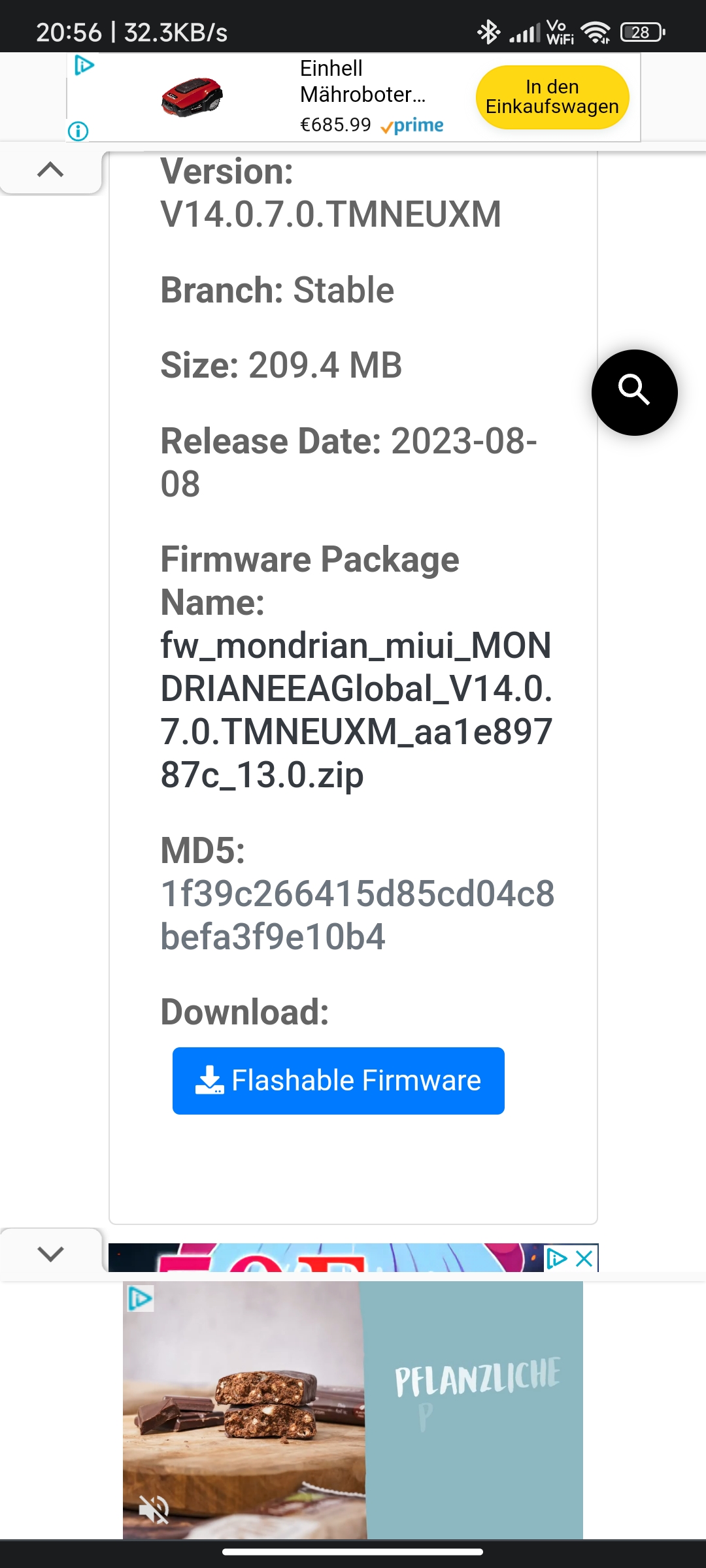

@JeffSantP You need to download the FIRMWARE not the the entire Rom.

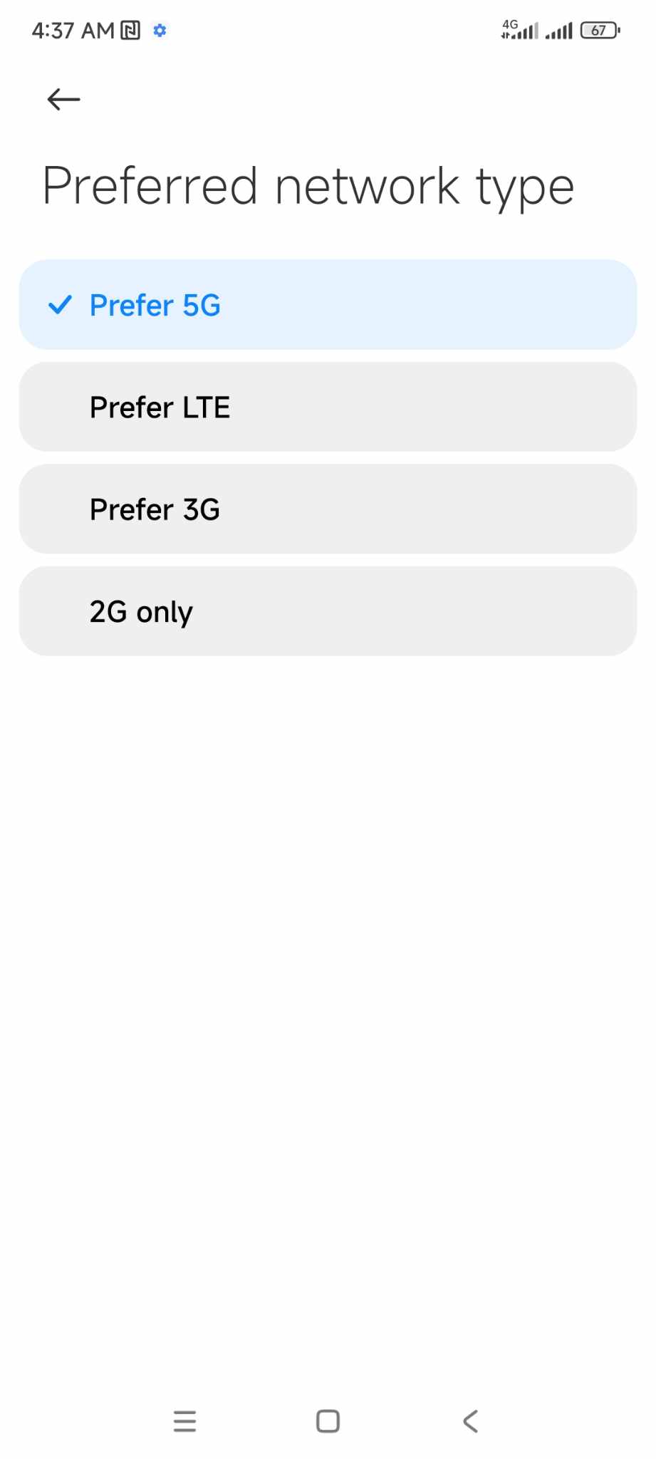

Hi Guys, Im from PH sorry for my bad english. Anyway, before i flash EU Rom i can easily get 5g and now i just flashed xiaomi.eu stable all works and its good its my new experience i can get calls, messages etc. but my only problem is that I have 5G in my settings but cant get the literal 5G just 4G+ is the max, already tried the guides Flashing modem.img either from EEA or Global but none of them works any solution for this? Getting 5G is my only problem Please help.
PS: it also seems like my battery draining so fast any solution? in stable rom battery drains 100 - 97% overnight but in eu rom 100 - 90%

With a payload .bin dumper. You swap it in the "images" folder in our ROM's ZIP.
Thanks.
I took from sourceforge these two: payload_dumper-win64 and payload-dumper-go_1.2.2_windows_amd64 because I don't know how relialble they are.
Extracted modem.img from stock Global EU ROM miui_MONDRIANEEAGlobal_V14.0.7.0.TMNEUXM_aa1e89787c_13.0. Both modem.img size (282.316.800 Bytes) (282.316.800 Bytes) are identical, file binary comparison too, so it should be fine to flash or put in .xiaomi_eu.zip after the unlock is done. The .img provided here is smaller.

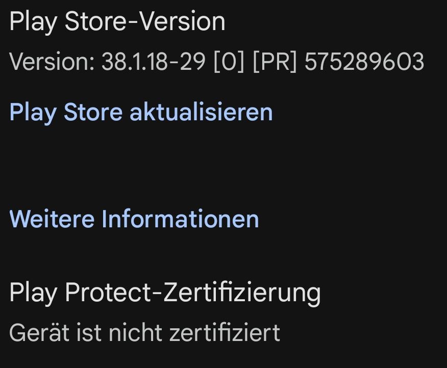

Your Play Store still certified? With Global EU modem, my F5P is not.
To me it also appeared as not certified at first but after two or three days I can't remember exactly it appeared as certified, even now that I've rooted it, it's still certified so give it a couple of days ;)
Reactions: wolden

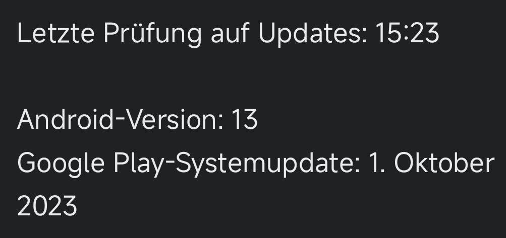

Still not certified, although my f5p received the recent Play Store update. No root. So, which apps should one not disable, or is Xiaomi Account login or Xiaomi Cloud mandatory?
edit: The funny thing is I could set up Google Wallet/GPay with a credit card and Paypal, too. WVL1 exists, Safetynet basic ok, CTS profile failed, HDCP 2.3 ok.

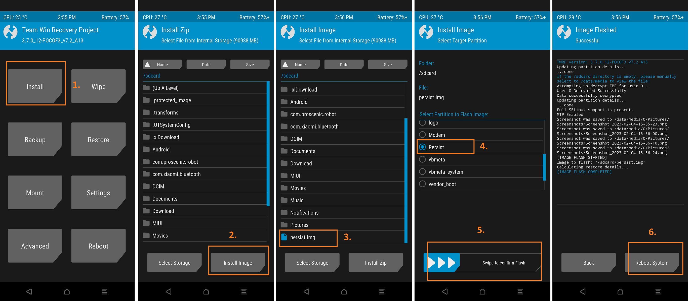

Follow the illustration (picture is illustrative). Replace the persist.img file with the modem.img file and install it in the "Modem" partition.

The reason it is not certified is because it does not pass SafetyNet. The most feasible solution would be to root the device and install Magisk, activate Zygisk, and then install the module "Universal SafetyNet Fix"
