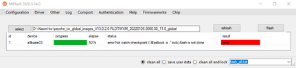

Hi there,
Unlocked bootloader & use miflash tool to flash TW rom on 12X, while it went smooth, until the very end it came up with error:Not catch checkpoint (\$fastboot -s .*lock),flash is not done then the phone boot up itself & it seems all right afterward.

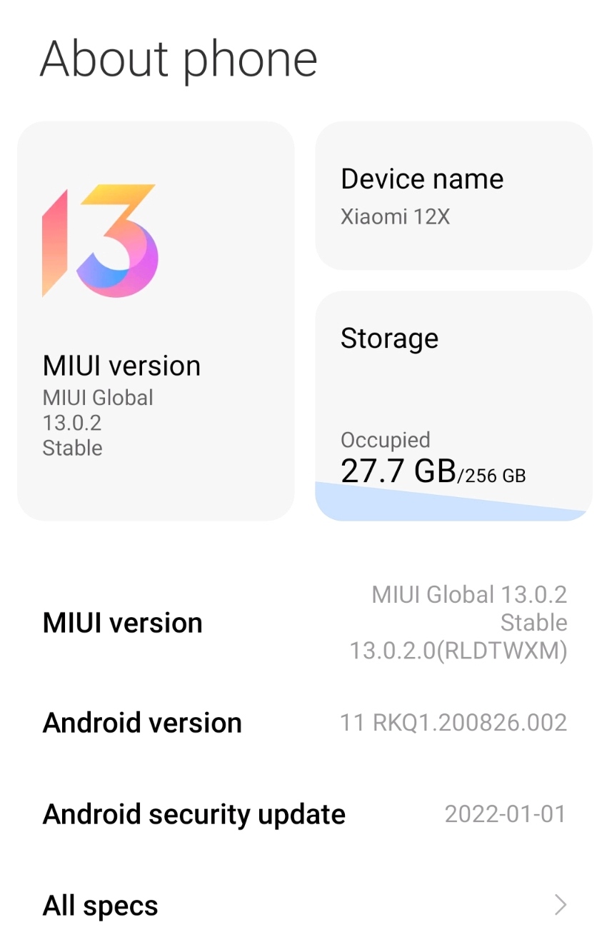

Verified 12X now with 13.0.2.0 RLDTWXM version, can browse internet, can make/recv phone call, can send/recv sms, etc; seems all good.
In that case, can I just ignore that error in miflash tool and conclude my TW rom flashing is completed?
Many thx! :emoji_pray:
