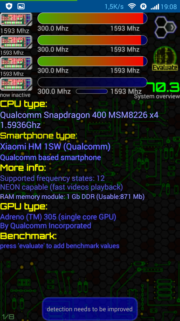

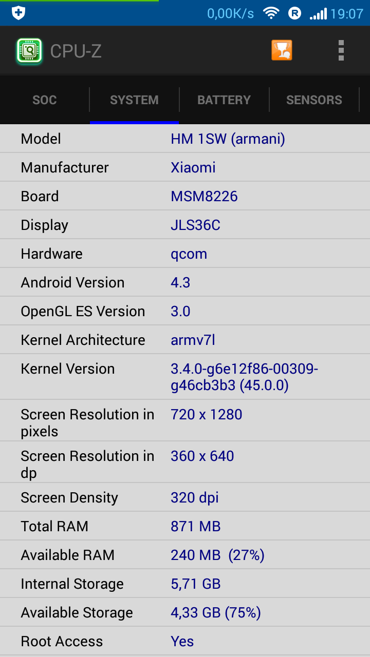

I have the same problem. My Xiaomi Redmi 1s has also a MSM8226 type processor.
So basicly it is an overclocked 1.2 ???
These wrong indications from various apps has everyone of us. Only Antutu system information is showing the right processor. Why don't you trust the foto?:rolleyes:
