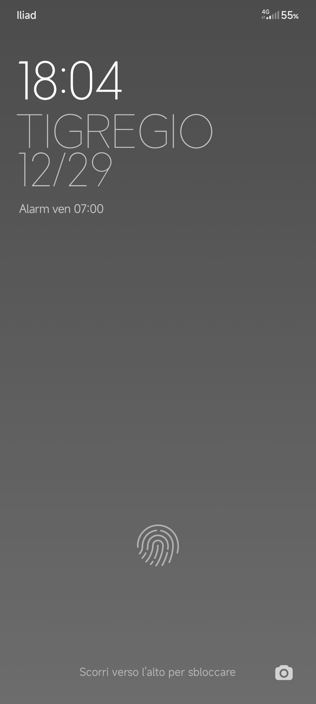

with the language set to Italian, the word "tigre" appears on the lockscreen before the day, why?

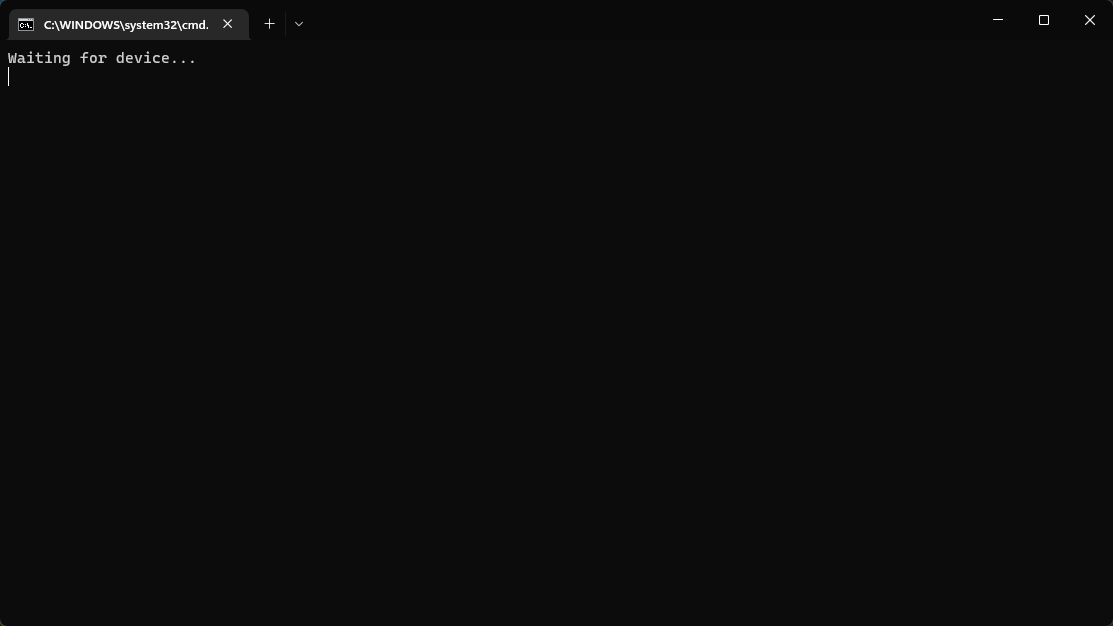

Hi.
Have a Xiaomi 12s Ultra and trying to install MIUI 14 Stable (from MIUI 13 stable).
Each attempt ends as the picture shows.............................
The phone is in Fastboot mode, have tried with 2 different PCs and 6 different USB cables. It pings in the PC when the cable is connected, but nothing happens afterwards.
What am I doing wrong ?

keep the 13 my friend, 14 is crap at the moment.
Else open a CMD with Administrator rights, then browse to the Folder where the image is .. CD C:\Image\....
then execute from there window_update****.bat

I have to agree with everyone else.its probably better to stick with 13 for now.
But If you really want to upgrade, then make sure that you have fastboot and android usb drivers installed on your pc. If you already have them and you're still getting this issue, then do the following:
1-boot your phone to fastboot and connect it to your PC,
2- go to device manager and find your connected phone. It should be unrecognized under "other devices"
3- right click and press update driver
4- then press "browse my computer for drivers"
5- then press "let me pick from a list..."
6- choose "android device"

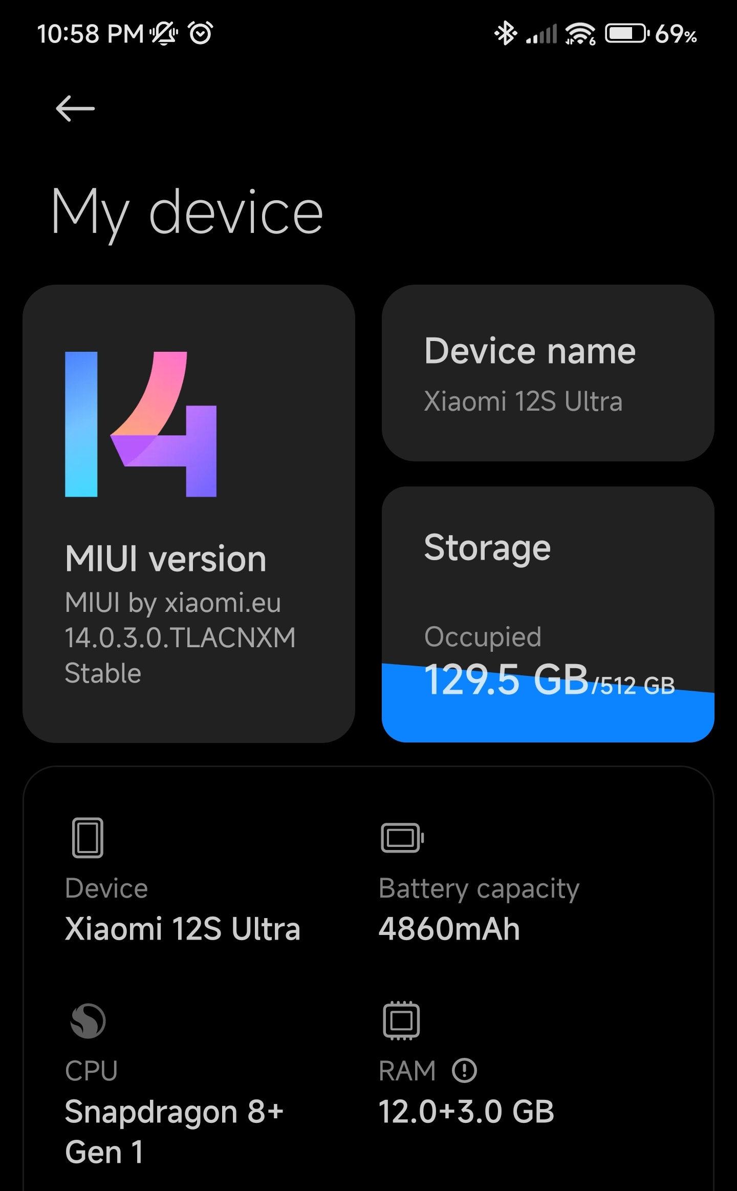

Nice this time v14.0.3.0 working fully message app no longer crashes .
