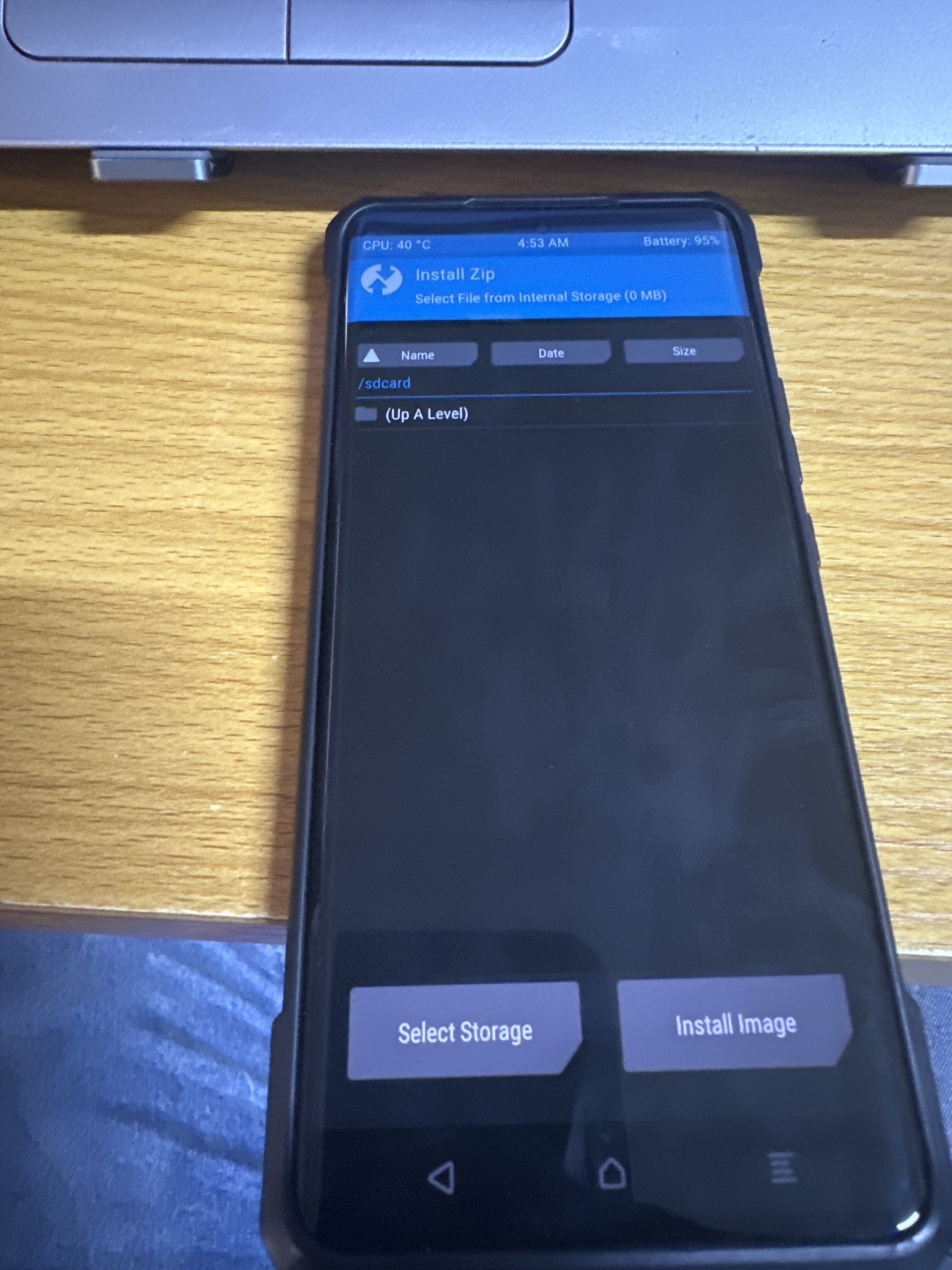

Believe me, I've had a lot of problems that I don't understand. Twrp does not see my memory, it does not install the ROM when it sees it. I took 1 day off, but I couldn't do it. What happened happened to all my deleted data. Please post the fastboot method :(
What version of Android is currently installed on your device? I'm guessing you have MIUI 13 (an android 12 based rom) so if you used the A13 recovery, then that's why you couldn't see your internal storage. You should have used the A12 version -- then once you flashed the newer rom it would have installed an A13 compatible recovery with it. Where you were upgrading, you shouldn't have had to wipe the data.
Miui 14.0.22.12.26 DEV Android 13 is installed. I will apply it again tomorrow as you say. Thank you very much, my friend, for your help
With that version you should already have an A13 compatible recovery installed, so updating to this version should be as simple as downloading it and flashing it via TWRP or using the built in updater. Be aware sourceforge is having issues with their San Diego mirror right now, so it may take hours to download.

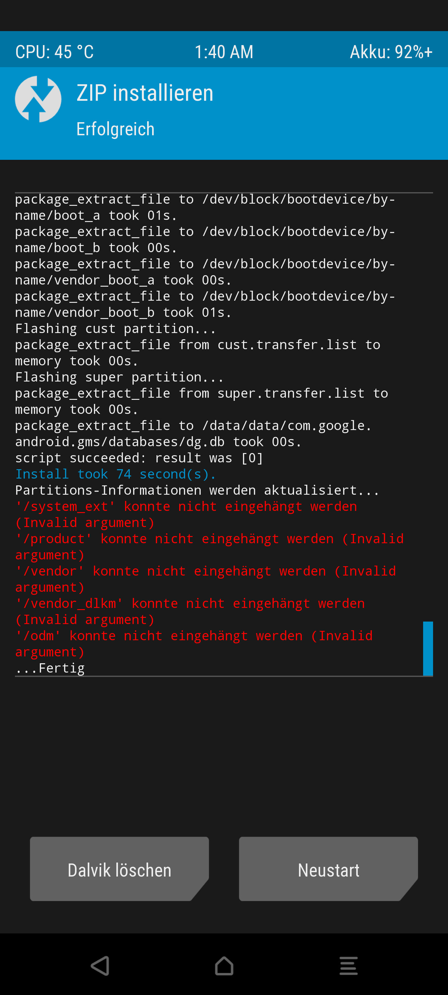

Hi guys I wanted to do a trwp update of my 12Pro with the newest available Version "xiaomi.eu_multi_XM12Pro_V14.0.8.0.TLBCNXM_v14-13.zip"
Sadly I got an error on the end of the update. I will attach a picture with the problem. Mabey someone can help me. Thanks in advance for your help.
Sadly screenshot is only in German the when I change the language the screenshots cant be opened. It says failed to mount.
Your rom is installed. This is a twrp error. Reboot the system and enjoy
