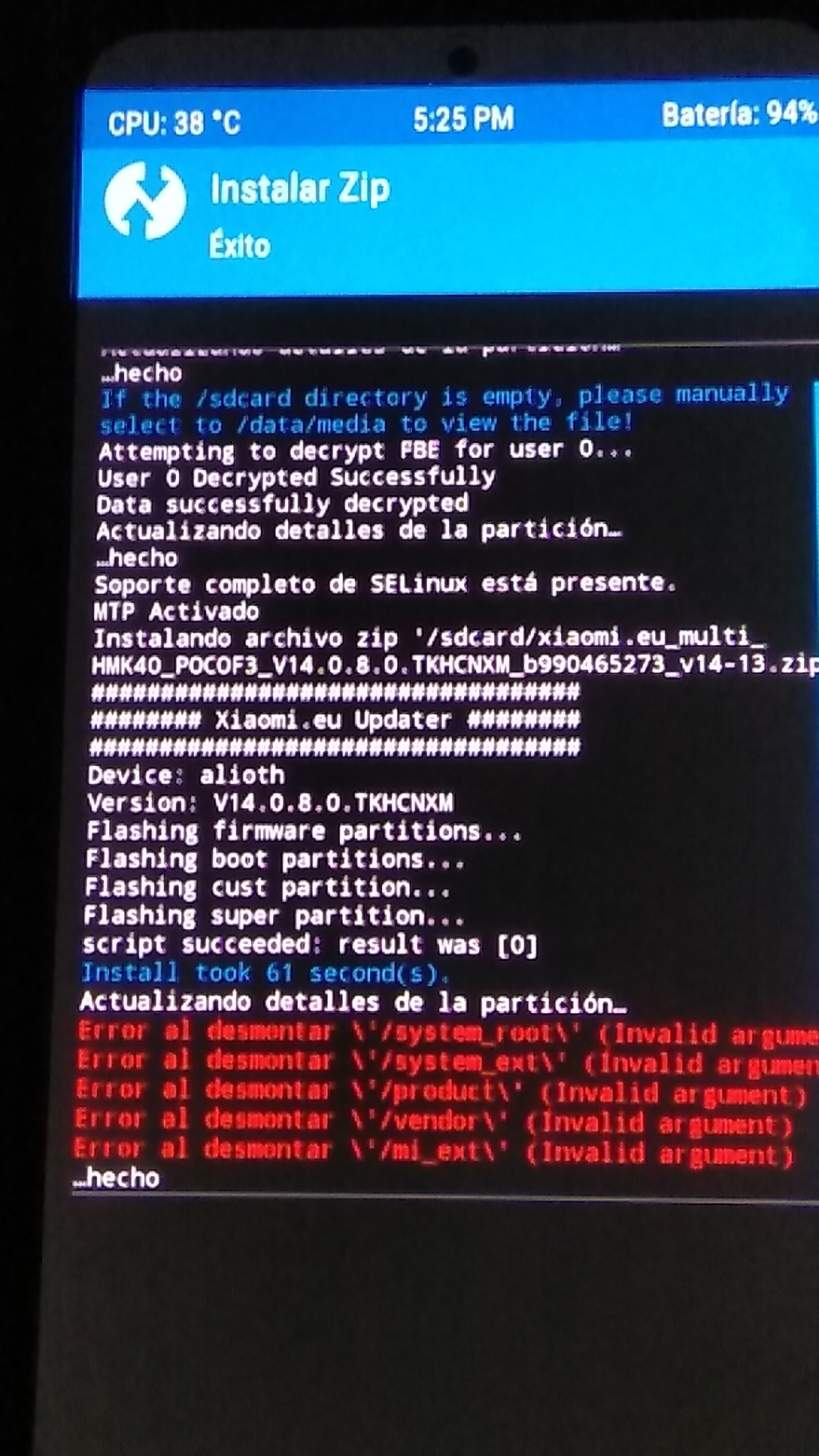

Hello everyone, since I have been updating version 14 on the F3 bit, TWRP shows me a series of errors, yesterday I updated the stable 14.0.8.0 again and copied the screen in case you can tell me the reason, I always have Magisk 26.4 I update without deleting data. Thanks in advance, you do a great job.
