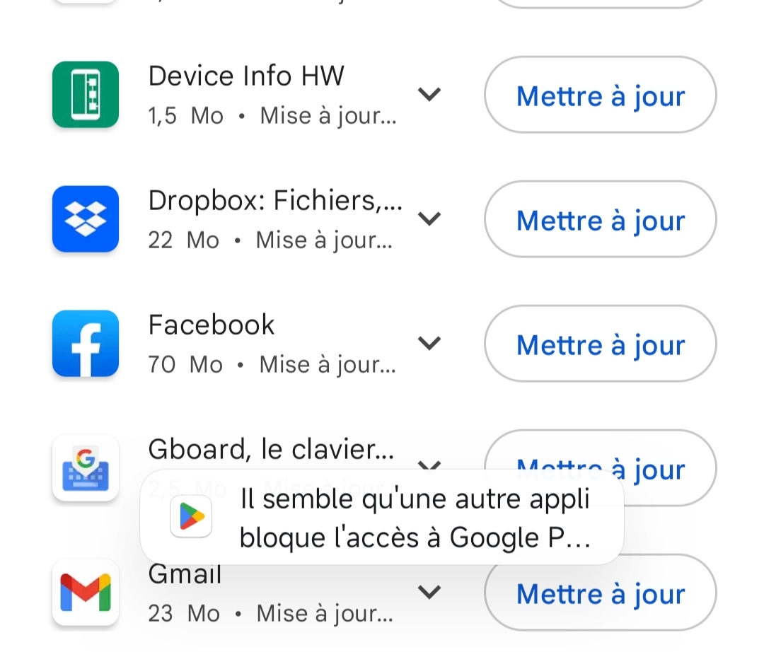

I have some issues to updated application on Redmi note 11 pro 5G. Running last build MIUI 14 and Android 13. Thx

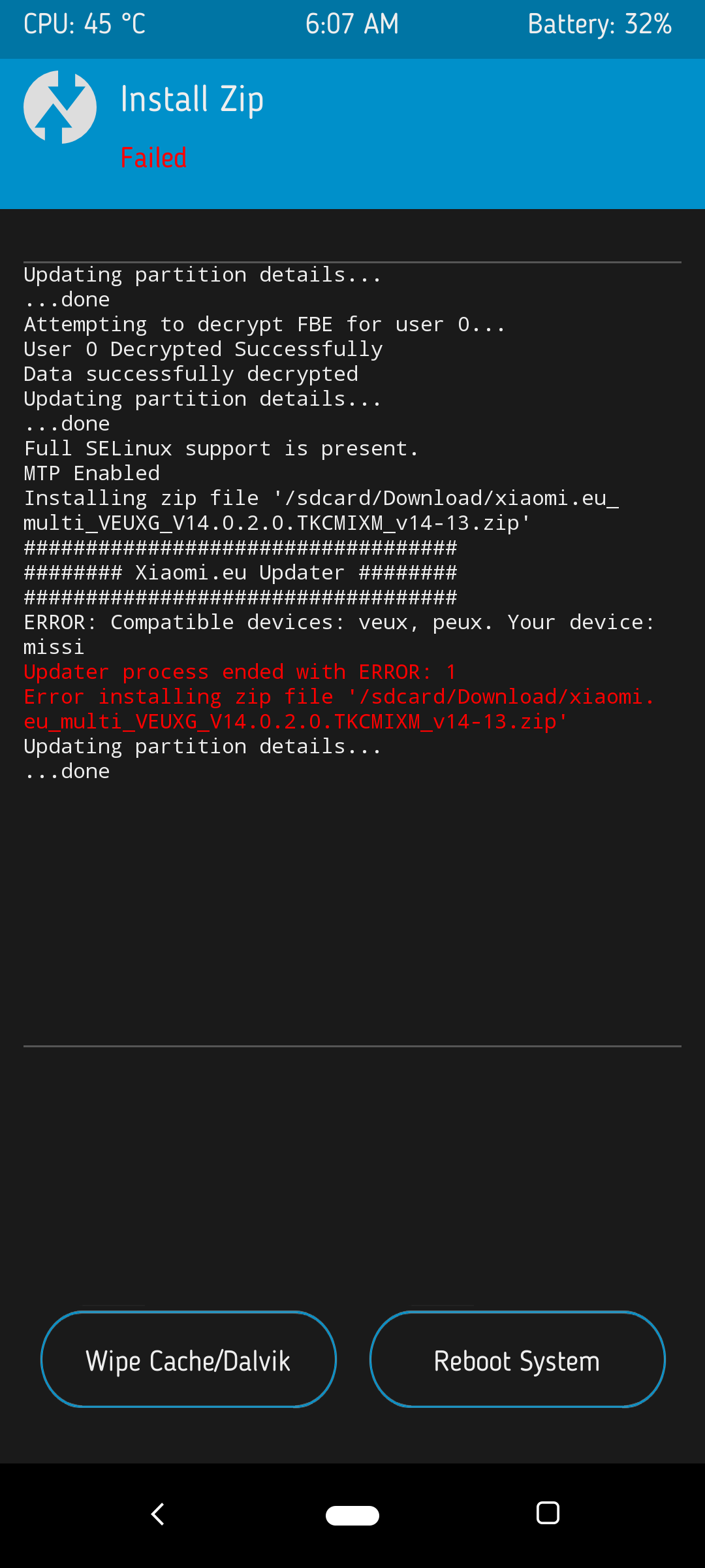

Hey @Igor Eisberg , I wanted to reflash the rebuilt ROM for VEUXG MIUI 14.0.2.0 and it says that my device is MISSI. That device doesn't even exist. I even extracted the ROM with CRB Android Kitchen and it recognized it as the same thing. What do you think is going on?
missi = Mi Shared System Image. TWRP is supposed to handle props correctly, but it doesn't in your case.
If your TWRP is outdated then flash using Fastboot.
Reactions: Spookie
Well the CRB Android Kitchen application for Windows also recognized it as MISSI after it extracted the ROM
