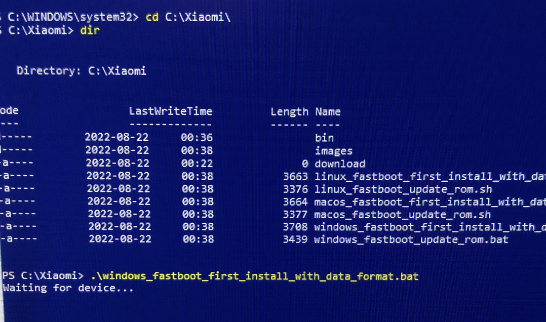

I found a video m only coming this far and nothing happends.
What am I doing wrong.
i think your device is not in fastboot, not connected or no/wrong drivers
look here

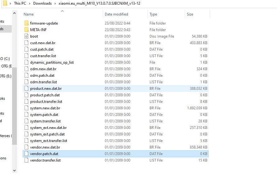

Hello, I wish to inform that on MI 10 Umi latest zip, after unpacking the fastboot installation scripts are nowhere to be found (attached a picture) Can anyone confirm? Does that mean the latest update can be flashed via TWRP instead @ingbrzy ? Thank you for all assistance
look here and try to use the search function…
Fastboot or Recovery rom
- xiaomi.eu_multi_MI10Ultra_V12.5.10.0.RJJCNXM_v12-11.zip -> no fastboot in filename -> recovery rom / twrp
- xiaomi.eu_multi_MI10Ultra_V13.0.4.0.SJJCNXM_v13-12-fastboot.zip -> fastboot in filename -> fastboot rom
