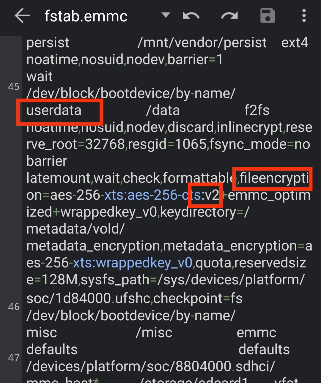

@ingbrzy Which encryption type does Android 12 based Xiaomi.eu ROM use? FBEv1 or FBEv2?
For the phones originally deployed with A11 and higher, FBE by default should be v2
Google documentation describing FBE:
With root, open /vendor/etc/fstab.emmc (read-only, textual file) - on your phone it might be fstab.<something-else-than-emmc>
Alternatively, with TWRP copy that file to /sdcard/Download and later from Android open without the need for root
Inside, that file search for /userdata (filesystem definition):
Code:
/dev/block/bootdevice/by-name/userdata /data f2fs noatime,nosuid,nodev,discard,inlinecrypt,reserve_root=32768,resgid=1065,fsync_mode=nobarrier    latemount,wait,check,formattable,fileencryption=aes-256-xts:aes-256-cts:v2+emmc_optimized+wrappedkey_v0,keydirectory=/metadata/vold/metadata_encryption,metadata_encryption=aes-256-xts:wrappedkey_v0,quota,reservedsize=128M,sysfs_path=/sys/devices/platform/soc/1d84000.ufshc,checkpoint=fs
Actually, inside that line look for fileencryption definition:
Code:
Eg, flag :v2 as above, describes that you would have FBE v2.
Here it is also emmc_optimized with hardware-wrapped keys
IMO - FBE (all together, filesystem definitions) is not up to Xiaomi.eu, but defined by the baseline Xiaomi firmwares
