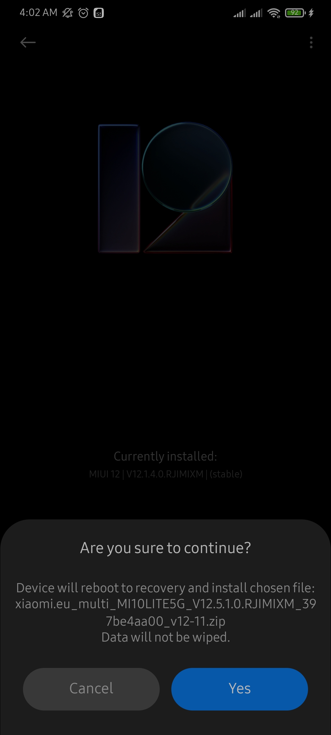

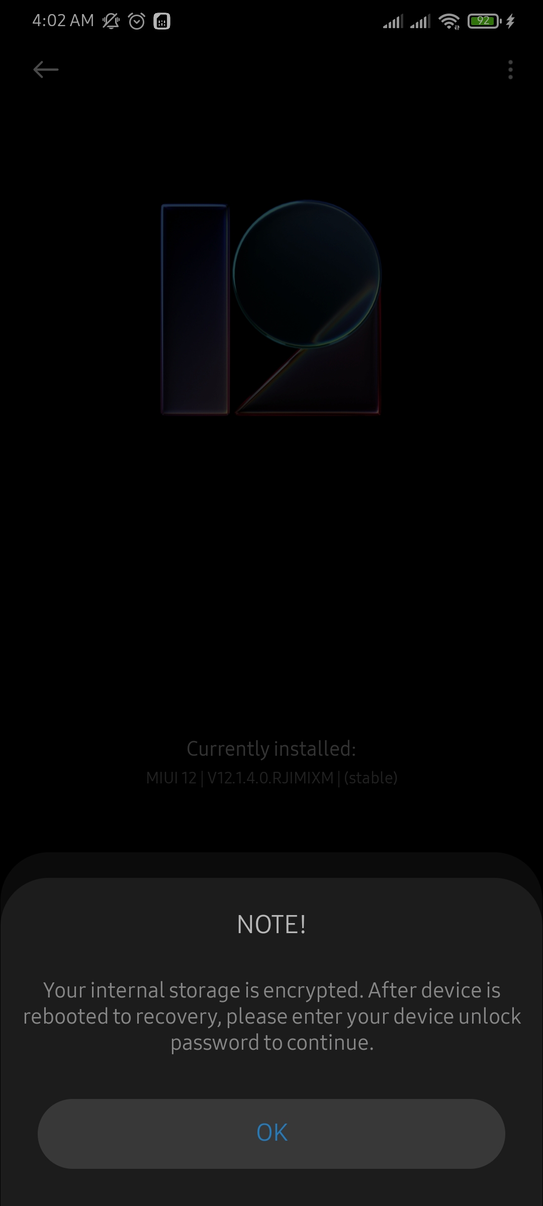

I am not successful in updating OTA. It's not booting to the recovery. What to do?
Click on "Yes" button do nothing?
Anyway, you can manually boot in TWRP (try via 3-dots menu in Updater => Reboot to Recovery), decrypt your /data partition, go in "Install" menu and find the downloaded ROM in "/sdcard" to install it. Reboot your device after that. ;)
I've got the exact same issue after hitting the yes button nothing happens. And my recovery doesn't have an install from zip option either
