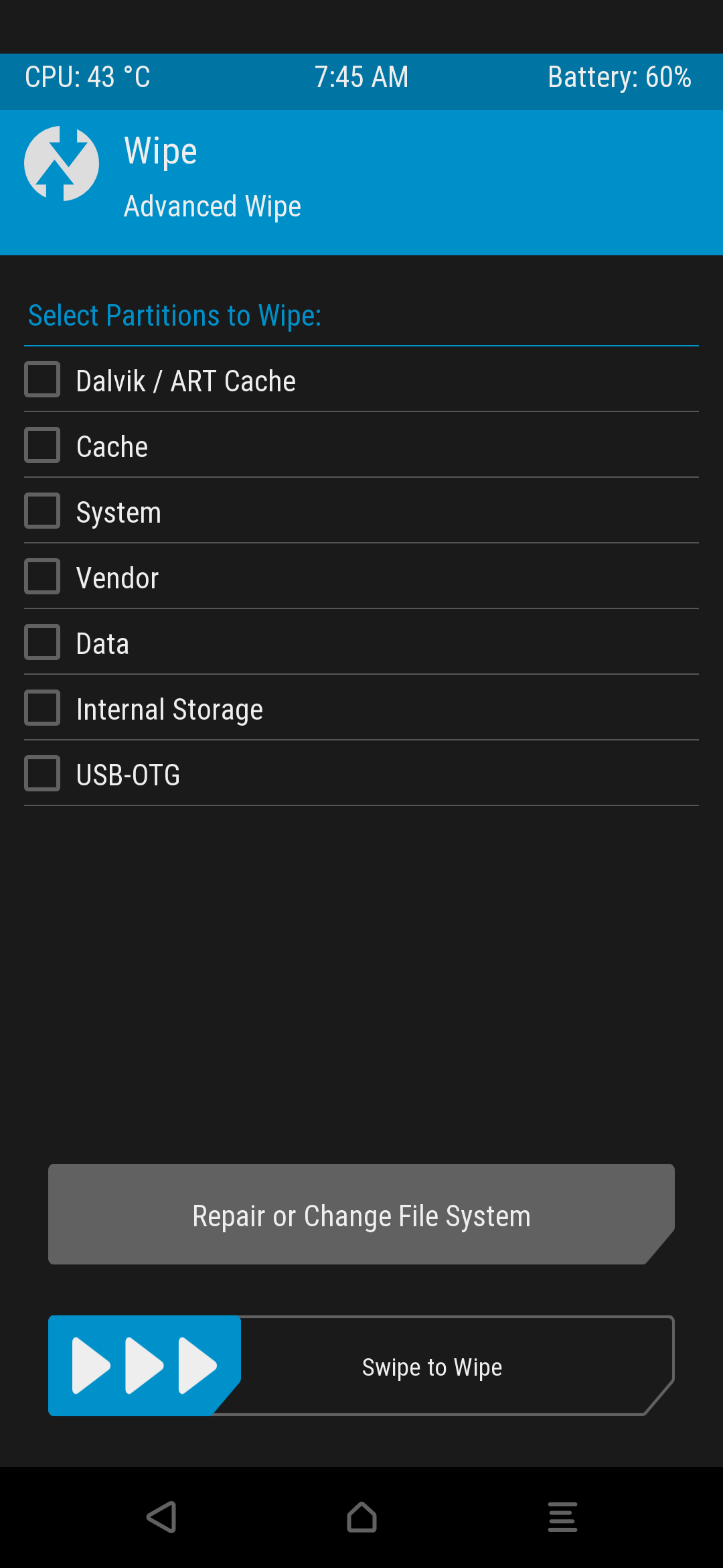

can i downgrade from weekly android 11 21.4.14_v12-11 to stable V12.0.6.0.QFACNXM_v12-10 android 10 through twrp Mi9 ?
if it possible what should i format ?
Format required.
Can you please tell me what partitions to format ?
