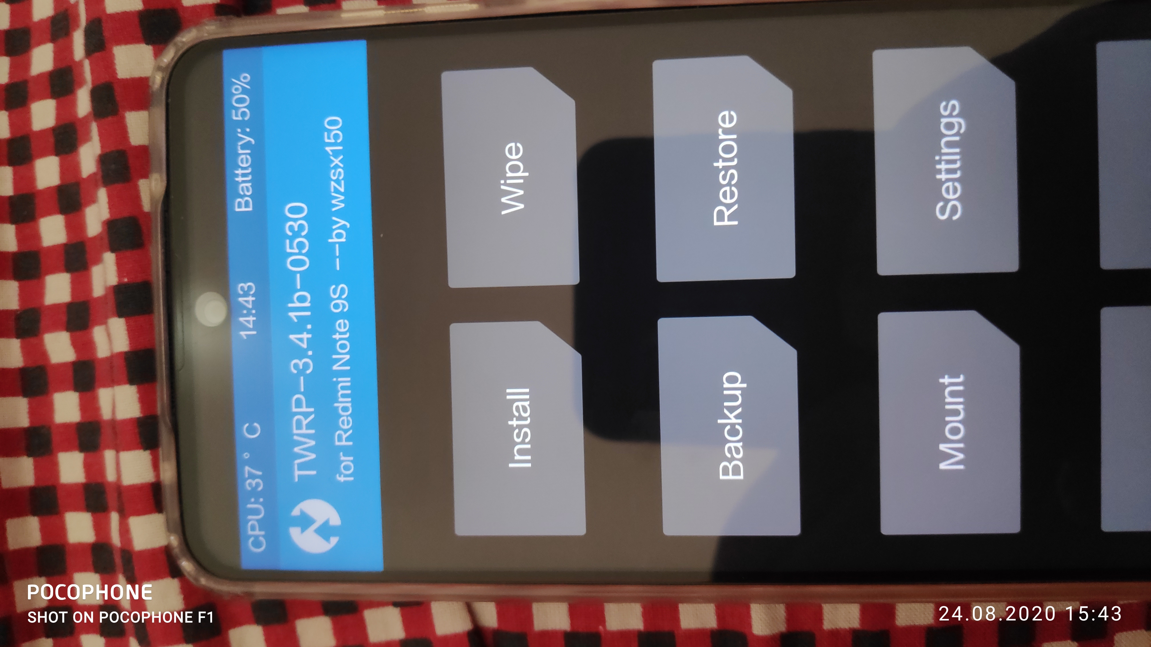

My wife's redmi note 9s has xiaomi.eu v11.0.10. When i try upgrade to v11.0.11 i got error 7 on twrp. I know i have to upgrade twrp. So my question is which version? I have twrp 3.4.1b.Thank you

EDIT: TWRP version is 0530

I have LWTWRP 3.4.1b-0530 already installed. When upgrade trought dirty flash from xiaomi.eu v11.0.10 to new version 11.0.11 i got error7. So I need upgrade my twrp. Do you now if 30th may version on this link works?
0530 is the latest from LR team. It must does the job. I've installed EU 11.011 rom with it.
May be something wrong at the rom download, check MD5.
A newer TWRP is Pitchblack 3.4.0-pb-v2.9.1 unofficial. I tested it but I feel it similar, only cosmetic.
Google it or have a look at t.me

I checked md5 after the download and was ok. Maybe the problem was the magisk installed, or not? What do you think? Thank you
