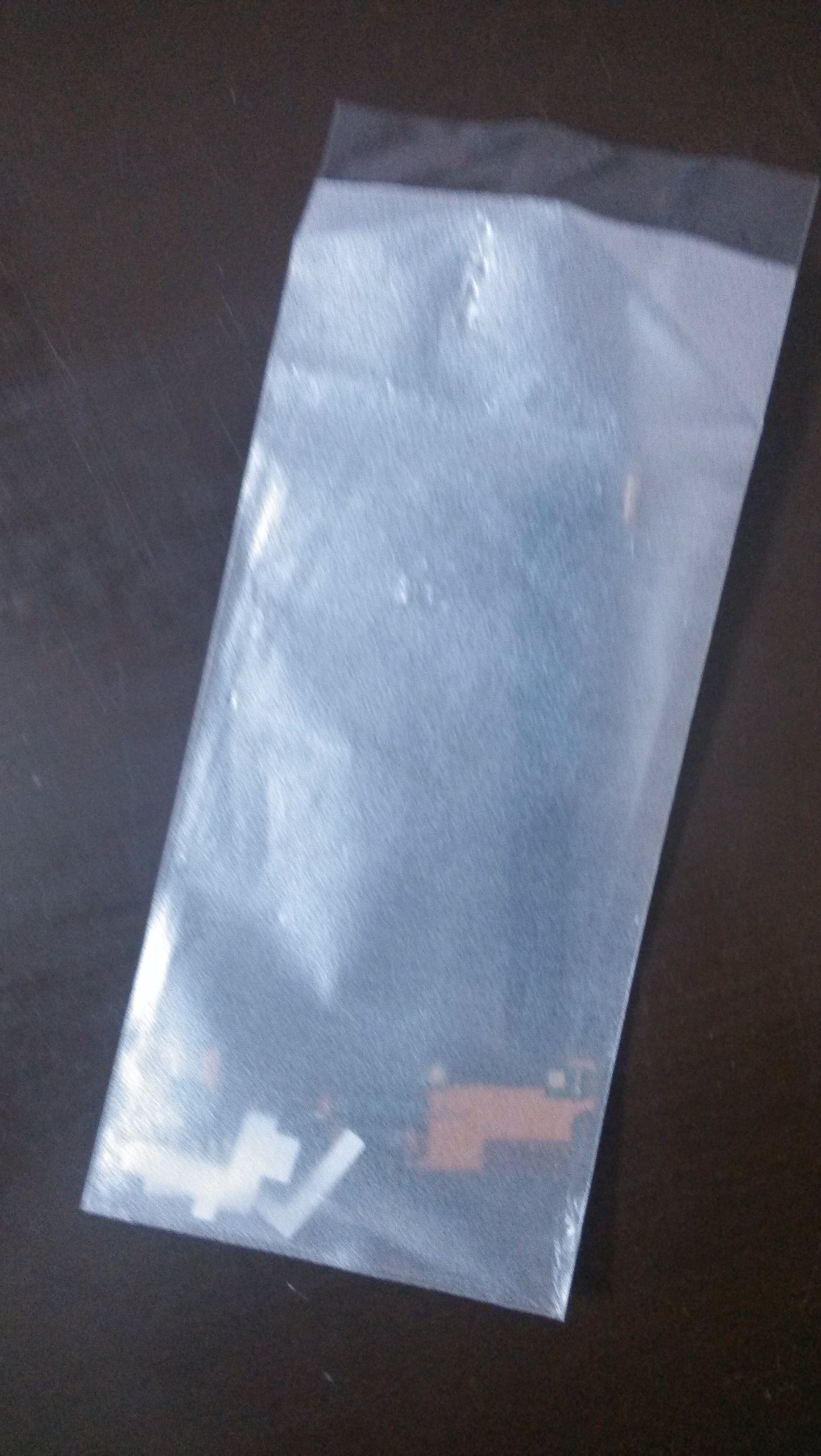

Exactly the same. There are stickers on the back that you need to remove for the glue to stick and hold inside the panel. That's how the replacement came. The white is the removed sticker.

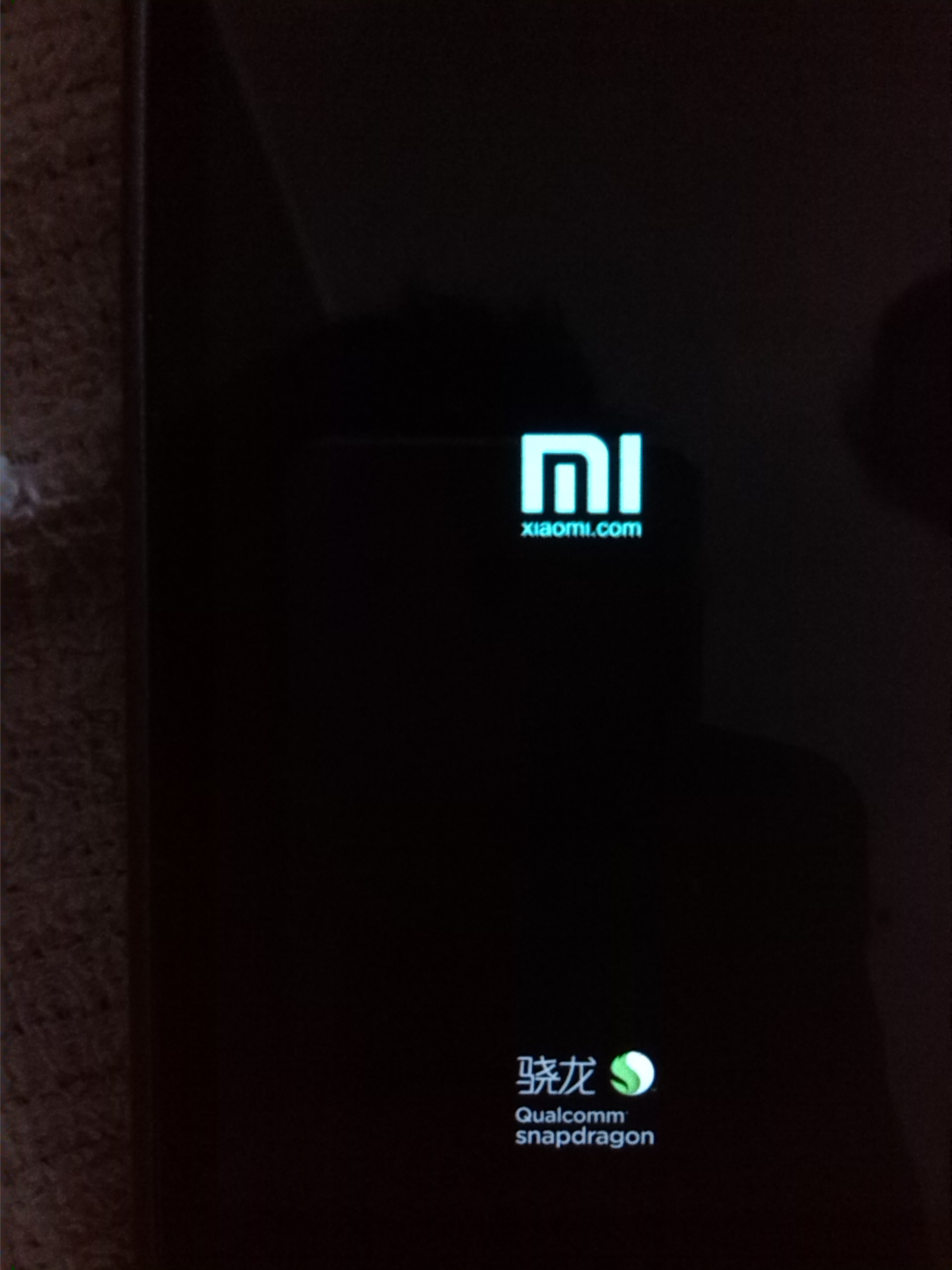

Oh and this is how the new start screen looks. :) Blue glow and new Snapdragon logo.
