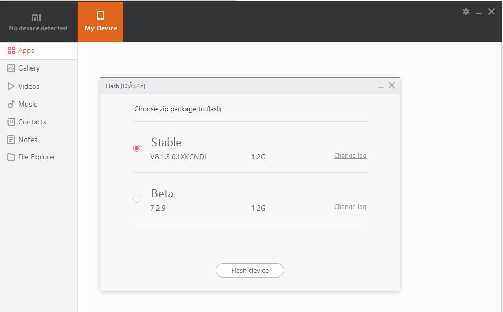

What I recognized. If I start fastboot mode and also the MI PC Suite. I can select the ZIP file to flash.
Stable version or Developer version. Would this work? Afterwards I believe I could unlock bootloader.
Also when I wait one week more, whill the update of the offizial version again lock my phone? Or can this be prevented in the future? Then should be better to remain at Android 6

Nah, it's works when you are using xiaomi.eu also! At least several users already reported that it does. Did you tried enabling the "OEM Unlocking" option in the developer menu? Try enabling this option and then you can try to unlock your boot loader once again without the need to wait until the information is updated in the xiaomi servers, but if this doesn't work, then you will need to wait until the information is updated in the xiaomi servers!
Dude i think that you are confused about a lot of things hehe! Every time that you flash an xiaomi rom, it will lock your bootloader if it's unlocked! That's how it has been going on from sometime already! You can't prevent it, at least i never found a way to! The problem now is that xiaomi.eu is also locking the bootloader, i just hope that they can't change this again like in lollipop where it didn't lock your bootloader. Also there is no android 6 released for the mi 4c by xiaomi or are you talking about custom roms(CM, ACIP and etc)?
