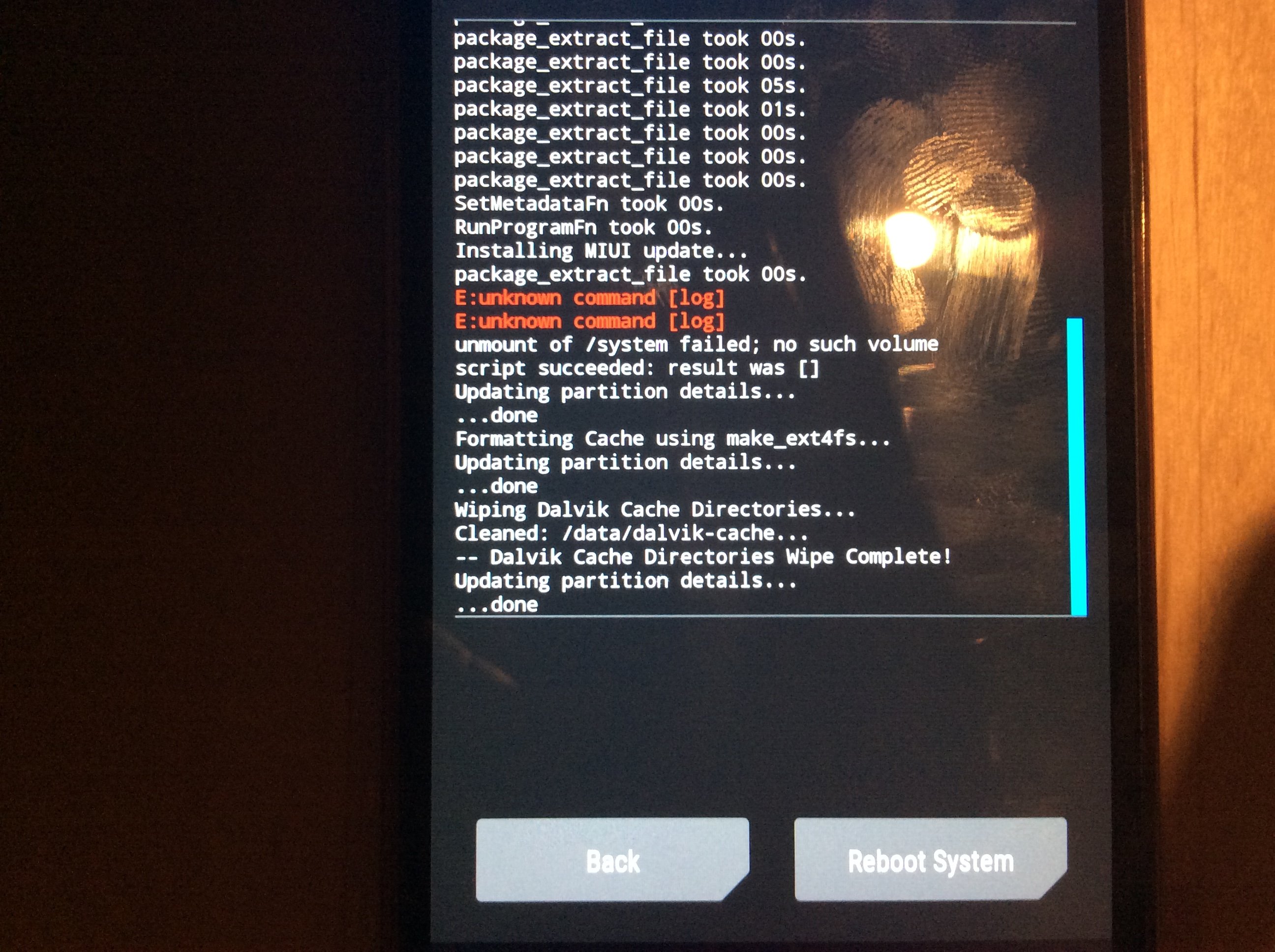

THIS is the error that appear when installing from TWRP:
Installing MIUI update...
package_extract_file took 00s.
E:unknow command [log]
unmount of /system failed ; no such volume
script succeded: result was []
updating parttion details...
...done
It says done. Now press back , wipe cache and dalvik and reboot to system
Ok, after 90 minute of waiting nothing change and no signs of installation, power off and restore the phone form previous version.

How long should I wait when I have the black screen with white Mi.com letters? I have updated to 6.12.12 via TWRP performed dalvik + cache clean and after I selected the latest zip from Updater app. TWRP screen appeared and after it reboots the screen freezes on the black splash. I waited ~15-20 mins with no progress, and usually there is something like 'installing updates' etc. Afterwards I was still able to access TWRP so Android 7 was not installed (thankfully) and I could reinstall 6.12.12. Any help?
6.12.22 is the version you need to be on...copy it to your device and reboot to TWRP select install... select the .ZIP ...swipe to install...afterward do the same for Android N...then unlock again and install TWRP Libra 7...
I made mistake when writing the message. Ofc I was on 6.12.22 not 6.12.12. But you say that I can install Nougat with TWRP as well? does the TWRP version matter? I have 3.0.2-0 installed
Unfotunately it does not work. When I install it from TWRP it's the same what @marciez mentioned, "unknown command. Unmount of system failed. No such volume" error. After that I cleaned the dalvik and cache and rebooted. I left the phone for whole night and still there was black screen with white Mi.com letters. Has anyone made update from MIUI 8 5.1.1 to MIUI 9 7.0 ? Maybe I should install MIUI8 with android 7 before and then update to MIUI 9?
There is a problem with direct installation on MI4C from version 6.12.22 to 7.8.17. You need to do a firmware update to 7.2.9 and then the system gets loaded. The same thing happens when you go from 6.12.22 to 7.7.20 and earlier, it looks like it must be installed first 7.2.9.
If anyone has a problem here is N firmware 7.2.9 to install in twrp libra-aqua_firmware_7.2.9.zip
This is a universal twrp for MI4C, works on both lollipop and nougat bootloader TWRP 3.1.1 for libra/aqua
EDIT:
@iamme729
I see where the problem is. There is no new bootloader in xiaomi.eu package. After updating miui is still the old 5.1 bootloader, the system does not load. In this package 7.2.9 is a new bootloader ;)

6.12.22 is the latest version of 5.1 and 7.2.9 is the first of 7.0, as you made the first update to this version 7.2.9, it should not be further problems. But as you skip 7.2.9 and you want to install eg 7.7.20 this is a problem, the bootloader does not boot the system. Just install the N firmware itself and the system will boot. I checked with curiosity because a few people on miuipolska.pl had a problem with it. I think this is the fastest way to go from 5.1 to 7.0.

I made the transition from RR to MIUI, I had to do a basic wipe. Then installed 6.12.22 and then MIUI9 7.8.17, the system did not start. After installing N firmware the system has started. The same I checked by installing the latest version of MIUI8 7.7.20 on 6.12.22, the system only started after installing N firmware libra-aqua_firmware_7.2.9.zip

@slimozis thank you so much. I have struggle for days trying to update last MIUI 9 over 6.12.22 version. I update TWRP with fastboot then install latest MIUI 9 and install 7.2.9 firmware. After reboot everything works fine. I dont wipe anything so now i have all my apps and data on latest MIUI.
