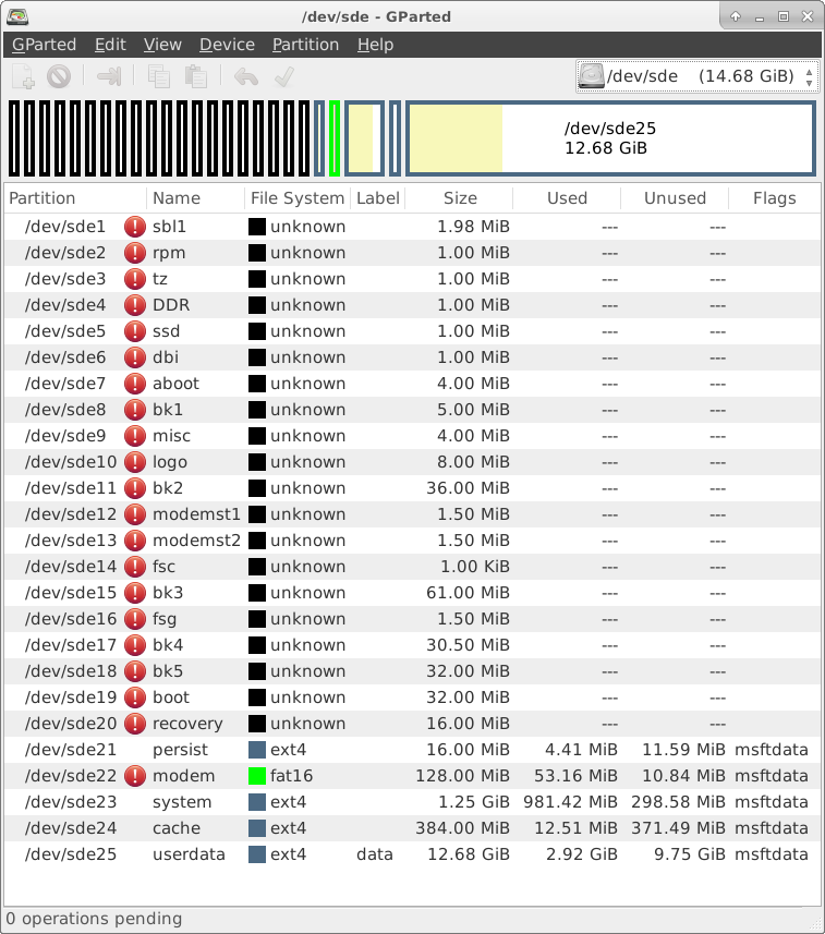

I checked phone in linux and it has total 25 partitions, last 5 I can access and there are files.
Now I need some expert what where to copy.
In win7 I tried everything I found in net, nothing works.
