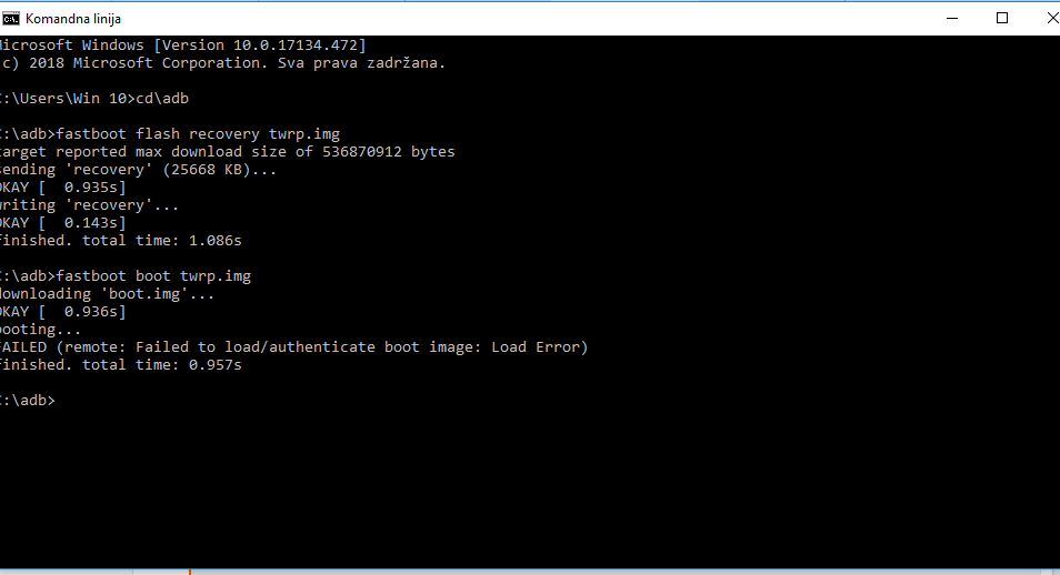

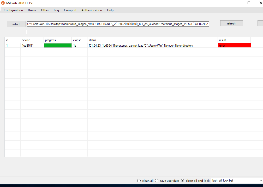

Hi, I need urgent help around my phone, I had it in the giggp, and I deleted it, as I do not know it myself, I started to reset myself last week, and I decided to return it to the factory settings and there is a problem now my phone stands in fastboot mode, I tried with this latest twrp 1227 I managed to install it, then I through twrp 1227 installed this latest ROM 9.1.3 did everything right but when I went to the reboot it will not boot the system only Enter the fast boot, have my phone help me know if, through myflash, I could not boot up a single firmware. if he knows something, he can call me, or if he can already see through me through the team wiewer where I'm wrong.

Normal because your rom flash failed.
From your pick I can't read the directory name you are pointing at.
make it simpler!
Did you extract the TGZ rom file and the TAR file as well?

You must give us more detail because your situation is unexplained.
What is your phone model?
What is your phone state? bricked?
What did you do before that?
What are you doing?

On bottom dont use "Clean all and LOCK" or you will list some hours...
I used the same version : sirius_images_V9.5.8.0.OEBCNFA_20180620.0000.00_8.1_cn
Maybe the issue is in the folder "Win 10" with a space.
Moreover, txrp.img is wich version ? with 1227 and 1217 same issue "FAILED..." just flash 1102 after MIUI CHINA and it's working
