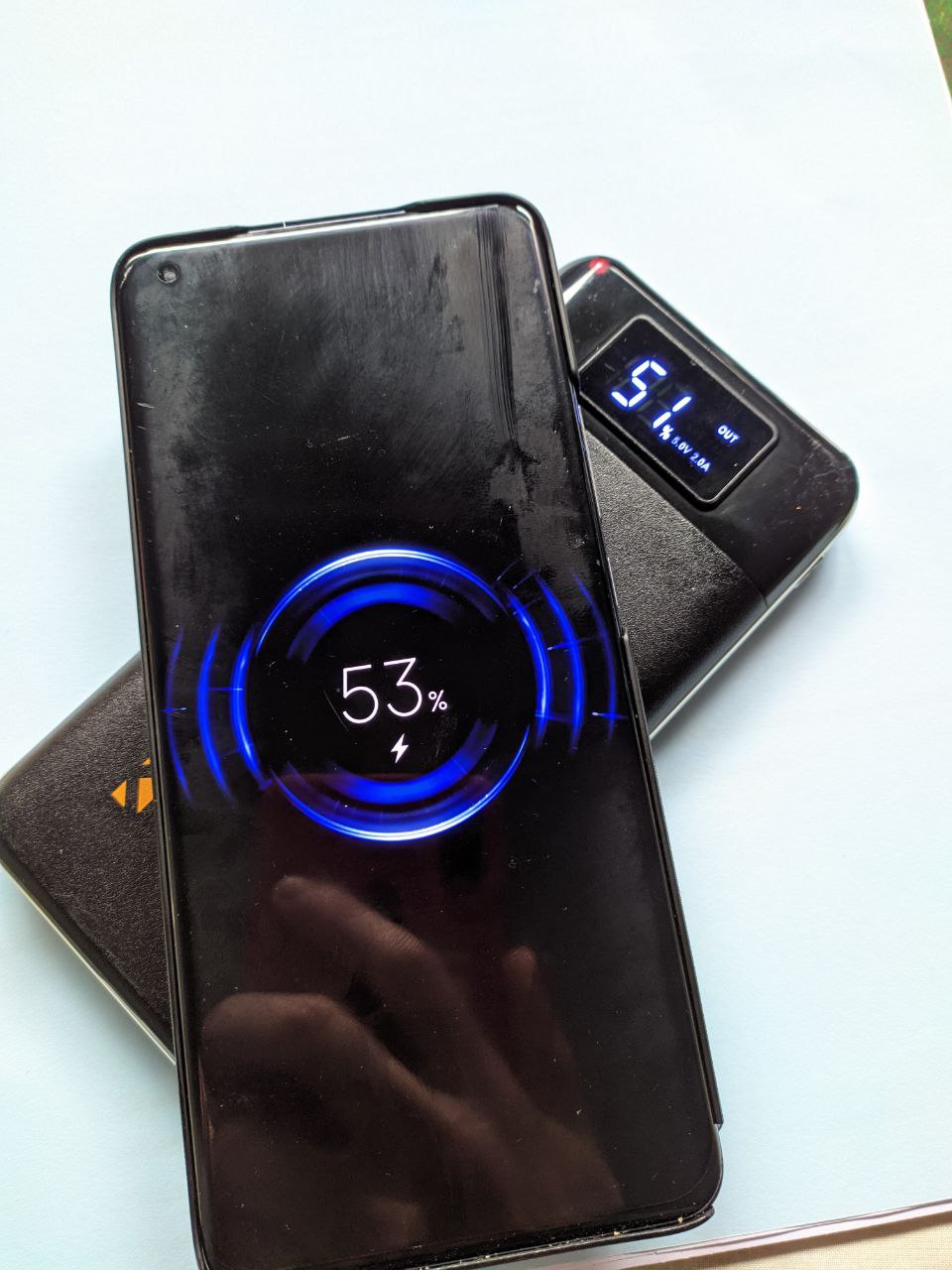

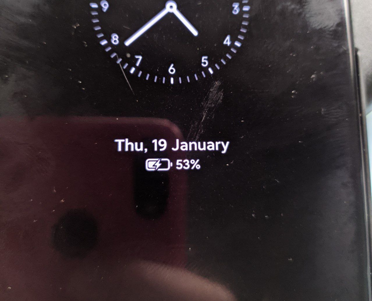

I don't know what is going on i understand all this but the thing is not happening to me
I just installed. 13.0.8.0 without data format or anything, wireless charging is still working
Reactions: Will197
Try higher power wireless charging, 20w, 30w, 50w. With a maximum of 5w it also charges with me, but it takes a month to charge, it has to be used according to its specifications.
That's the problem, i don't have higher ones and after what's being discussed here, i thought that the wireless charging is completely broken after all these updates, but it seem working and reverse wireless charging works too
