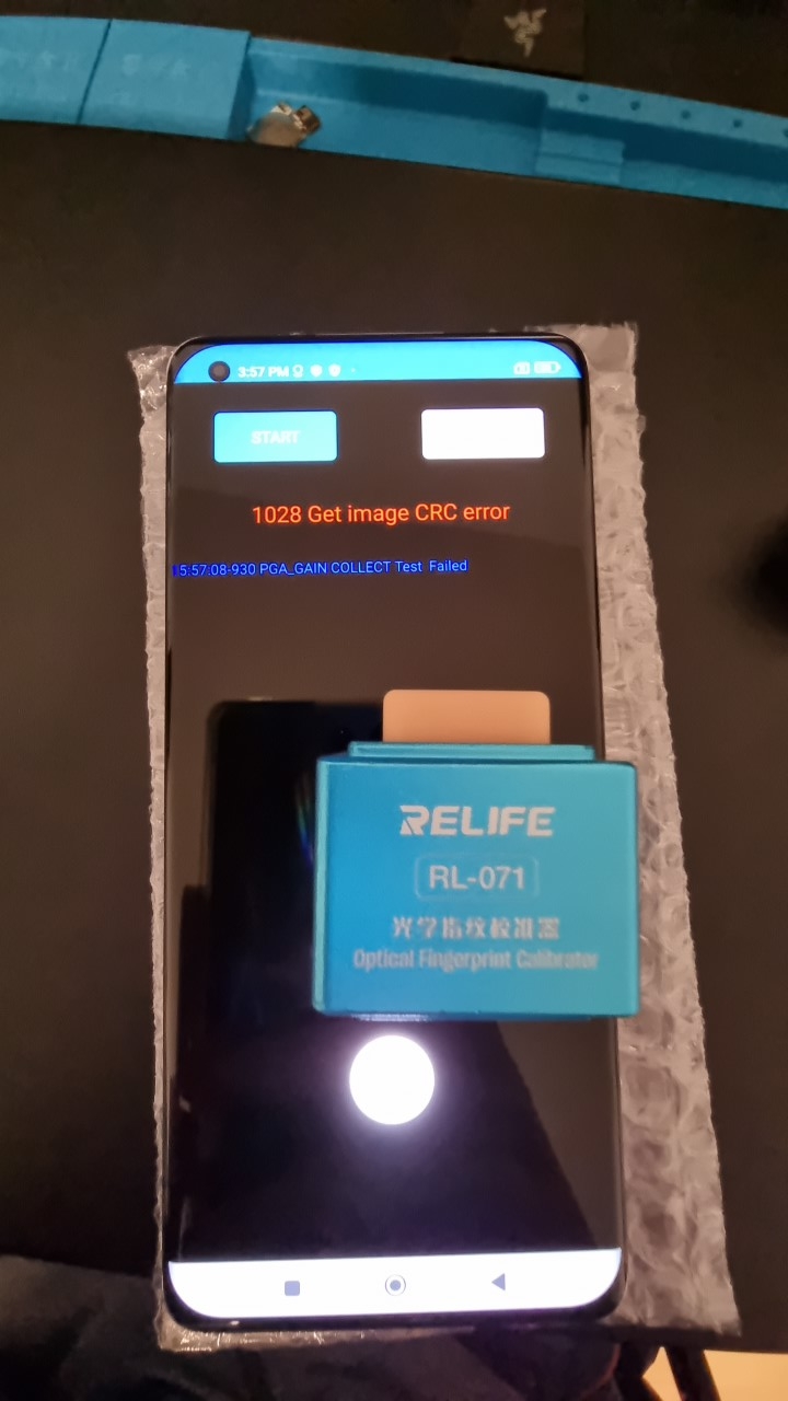

I broke my Mi11 Ultra the first week I got it, so I bought a replacement screen from AliExpress (since Xiaomi Support Germany didn't want to sell me one for my Chinese Mi 11...).
It was a screen unit with frame and buttons.
After putting the phone together Everything works except the fingerprint scanner.
I tried calibrating it like shown in other threads (I own a Relife calibration tool since I run a repair shop). Didn't work at all, failed at first step.

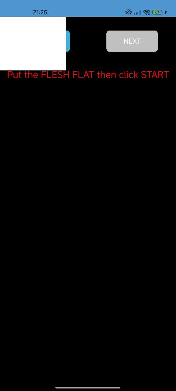

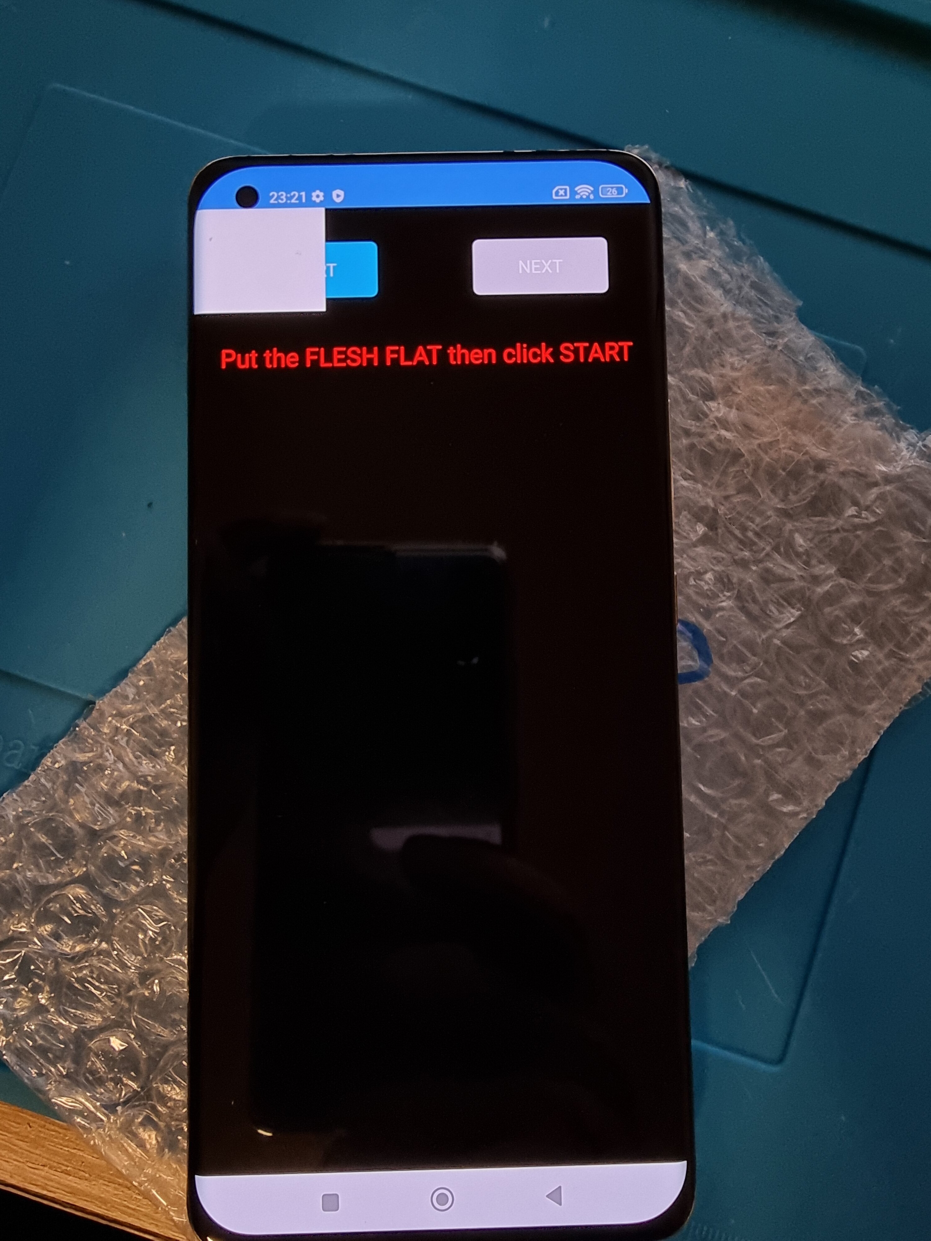

Then I rooted my phone, deleted the goodix folder and now my calibration page looks like on the pic.
I'm so done with this phone and Xiaomi after what I went through, I just want to get it fixed and sell it ASAP.
Please anyone, what can I do I'm so tired and done...

I calibrated it with a clear eraser cut out a square with a serrated knife cut straight through and it worked great
