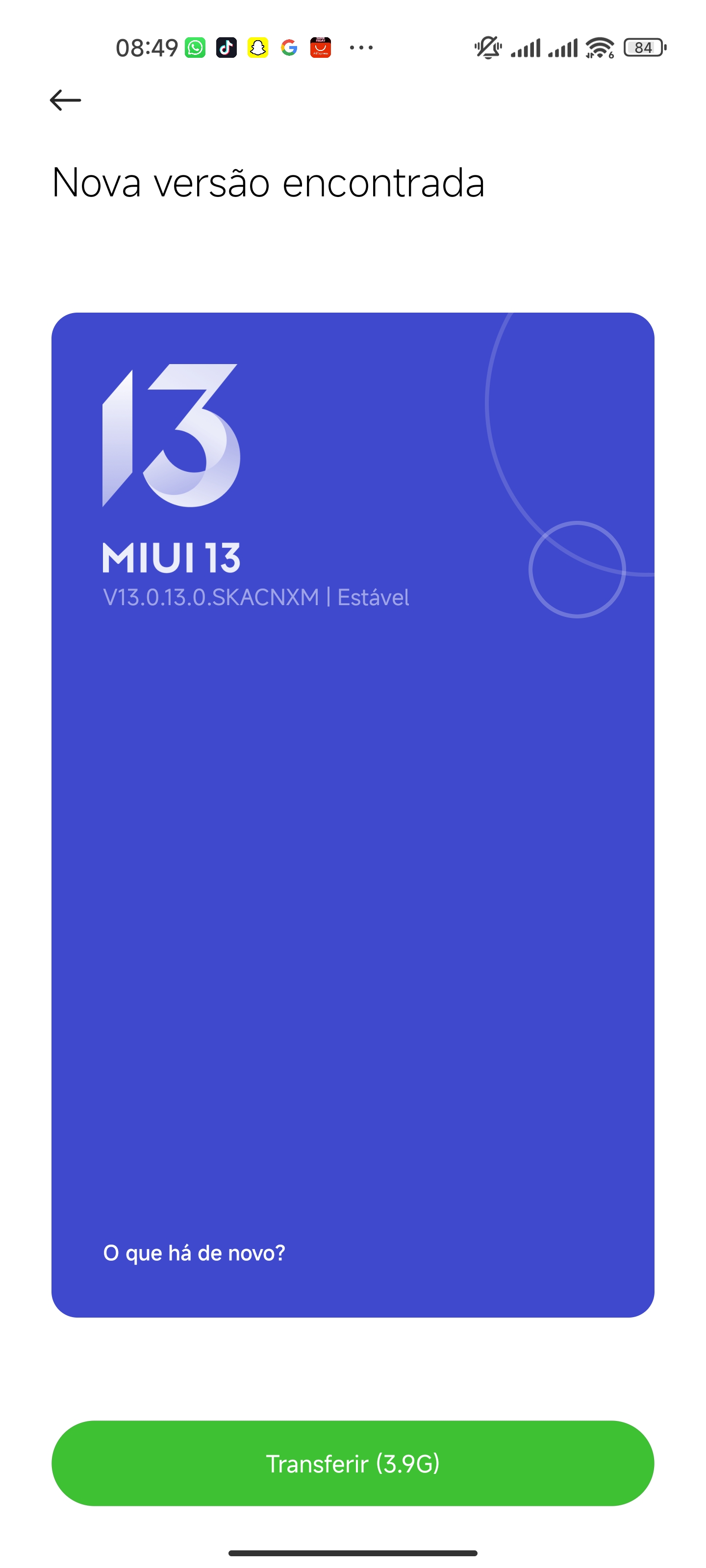

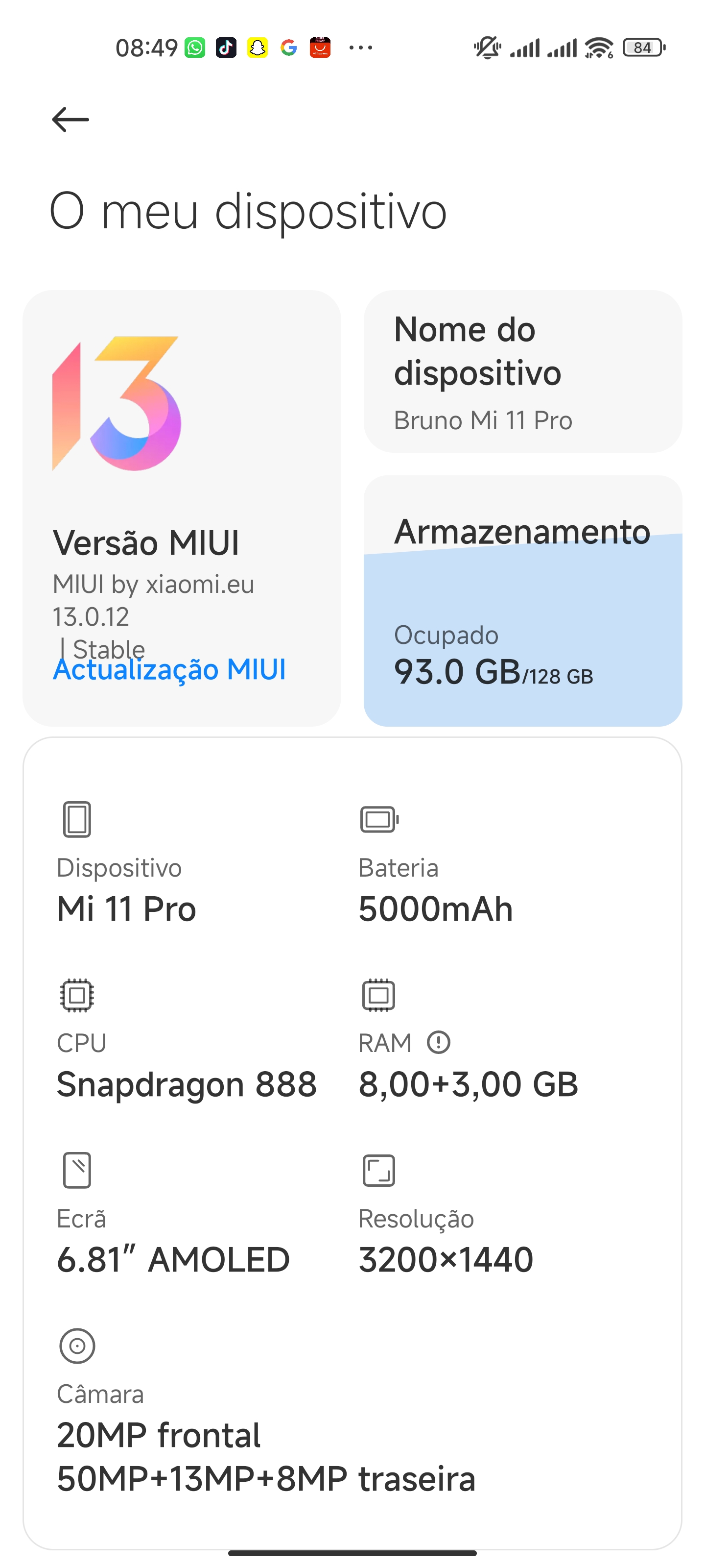

Hey guys, I received an update for Miui 13.0.13 the one that needs the recovery TWRP.
EU don't have that installed the TWRP, can I download the update and install or it can brick my phone?
Please see the attachment of what I'm talking about.

My Mi 11 PRO suddenly died after updating from Stable ROM 13.0.12 to 13.0.13 (first TWRP updating ROM after several fastboot updating ROMs). I don't know why, but I think my TWRP was not the appropiate one. Be sure that the TWRP is the correct one for your device.
Meu Mi 11 PRO morreu repentinamente após a atualização da ROM estável 13.0.12 para 13.0.13 (primeira ROM de atualização TWRP após várias ROMs de atualização de inicialização rápida). Não sei porque, mas acho que meu TWRP não era o adequado. Certifique-se de que o TWRP é o correto para o seu dispositivo.
Fo real? How that is possible?! Well I don't have TWRP, which one did you used? This is an update via OTA my last update was made through flash that's why I'm wondering if there is any problem if I try to update
@BrunodeSousa
The right TWRP for Mi 11 Ultra & Mi 11 Pro is:
https://dl.akr-developers.com/?file=skkk/TWRP/A12/v6.3_A12/[BOOT]3.6.2_12-Mi11Ultra-Mi11Pro_v6.3_A12-star-skkk_122188d9.zip
You must temporarily boot to TWRP (since it's an A/B device) with:
fastboot boot name-of-twrp.img
Soon it's booted you enter your lockscreen PIN, after decryption is successful, change language to your language, see picture
https://xiaomi.eu/community/attachments/bez-názvu-1-png.42793/
After changing language you can flash TWRP by using "flash image" and select the TWRP img (which must be placed on the internal storage) and flash it to Recovery_Ramdisk
Next step is to reboot to Recovery (instead to systém).
Then you can flash the Rom
The stable TWRP ROM (zip file) for your device can be found here:
https://sourceforge.net/projects/xi...files/xiaomi.eu/MIUI-STABLE-RELEASES/MIUIv13/
