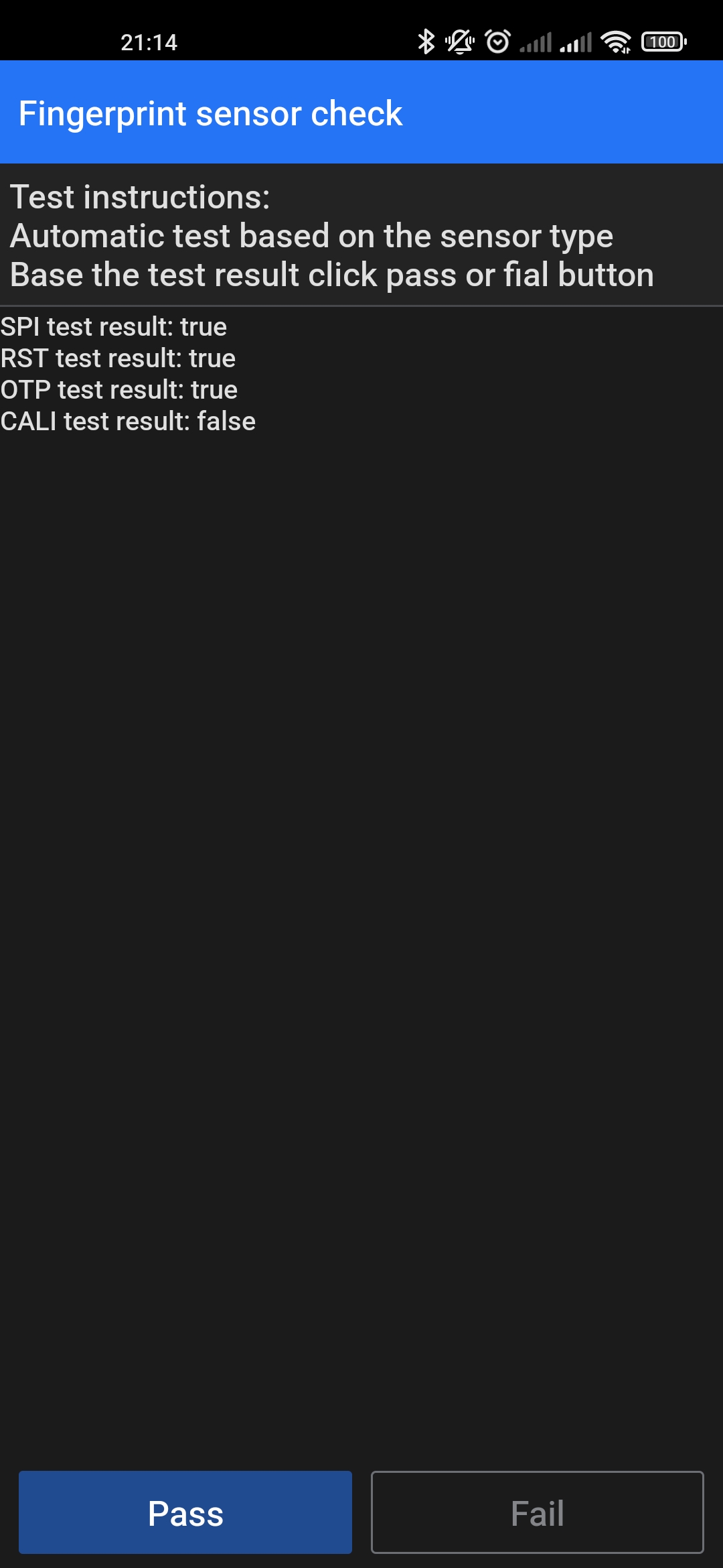

One ting to recall is that after the installation of your persist img i went to check the fingerprint for and for 1 or 2 seconds i thought it was going to work, but then the message that "couldn't add the fingerprint, try later"
i did the CIT test for the fingerprint and this is the result:

Is it only the fingerprint issue now. Do you have all other sensors working as well as signal levels, Bluetooth and WiFi? Of course it could be that you have a faulty sensor but may be try using my own files. Both I uploaded to my mega page and I would try the twrp restore first.

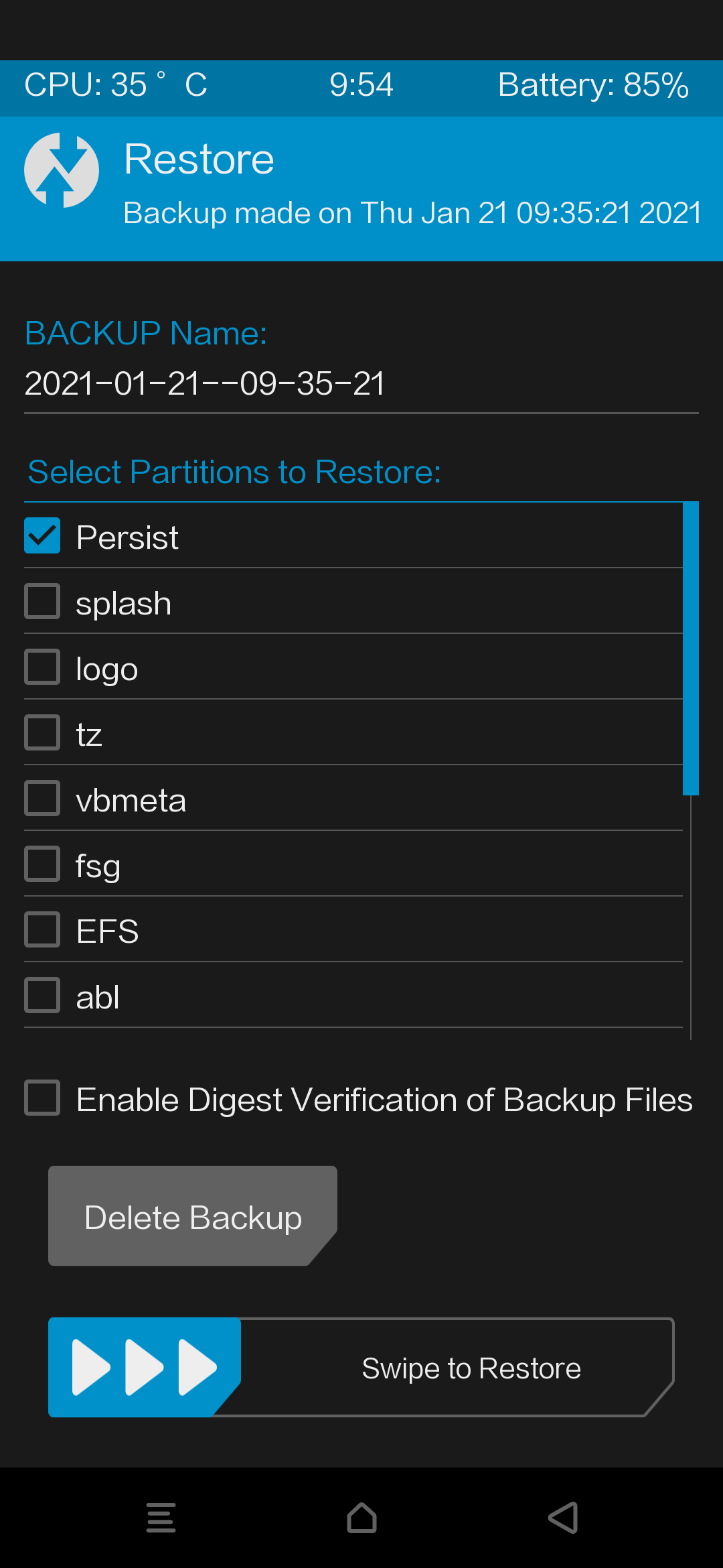

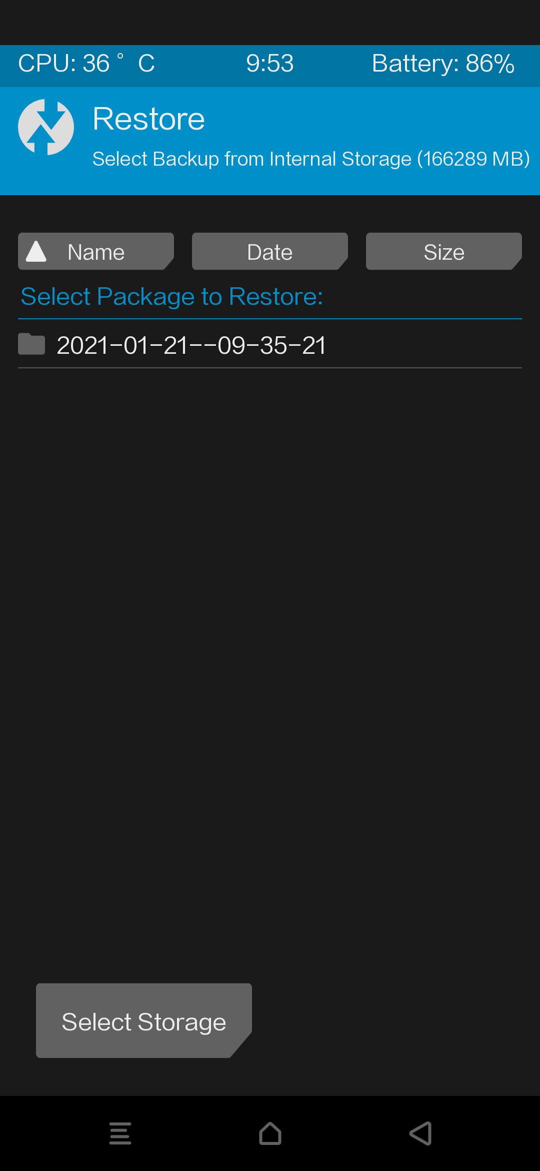

Download this zip file... https://mega.nz/file/vMhHzQJC#RsXAJ_ylAOGoMHXpbB6dRzFUqt23waIMqWHIwN1nh_A
It is a twrp back up of my persist.img file. Extract it to your storage and it should end up being twrp/backups/c3c35568b/....xxxxxx
Go to twrp and select the files to restore it back to your phone. If it's encrypted, use the pattern M . Screenshot below but ignore time name, I think the file is something like 9.59.
The second file... https://mega.nz/file/PAYFkCKC#gQoAxhwN9RBqSOqra91bMH6zqN23bLYsbLJS-ktKwdI
This is my own persist backup file that sits in the storage folder and gets updated now and again. You can may be restore this using info in the previous methods from yesterday using adb or terminal commands. I just thought, why not try my own files.

Yes Mark everything is working perfectly but the fingerprint.....ok i"ll try what you said, come back to yo asap

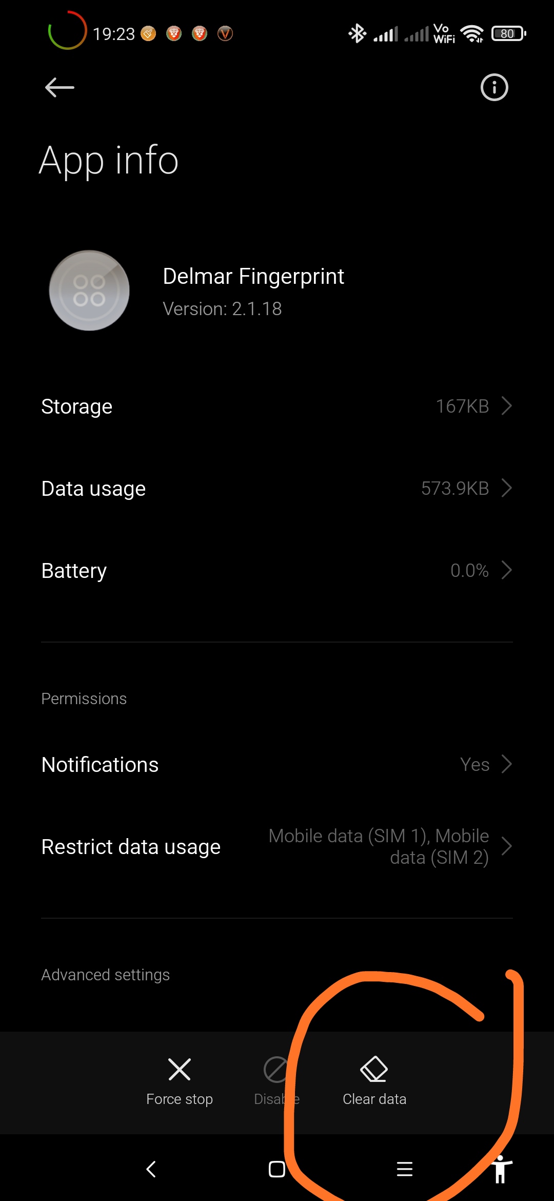

I can't find any app called FingerprintExtensionServicebut I did find the Delmar app and I'm able to clear data, see screenshot.
So Mark the Delmar app its the only one on the MI10 Ultra??? i thought there was FingerprintExtensionService app, because i watched in some vidoes but not for the ultra but others xiaomi.... and yes it has the option to clear data sorry my misstake, actually i just did it but still nothing. So i think there is no option to recover the option. so bad. thnks Mark for your reply

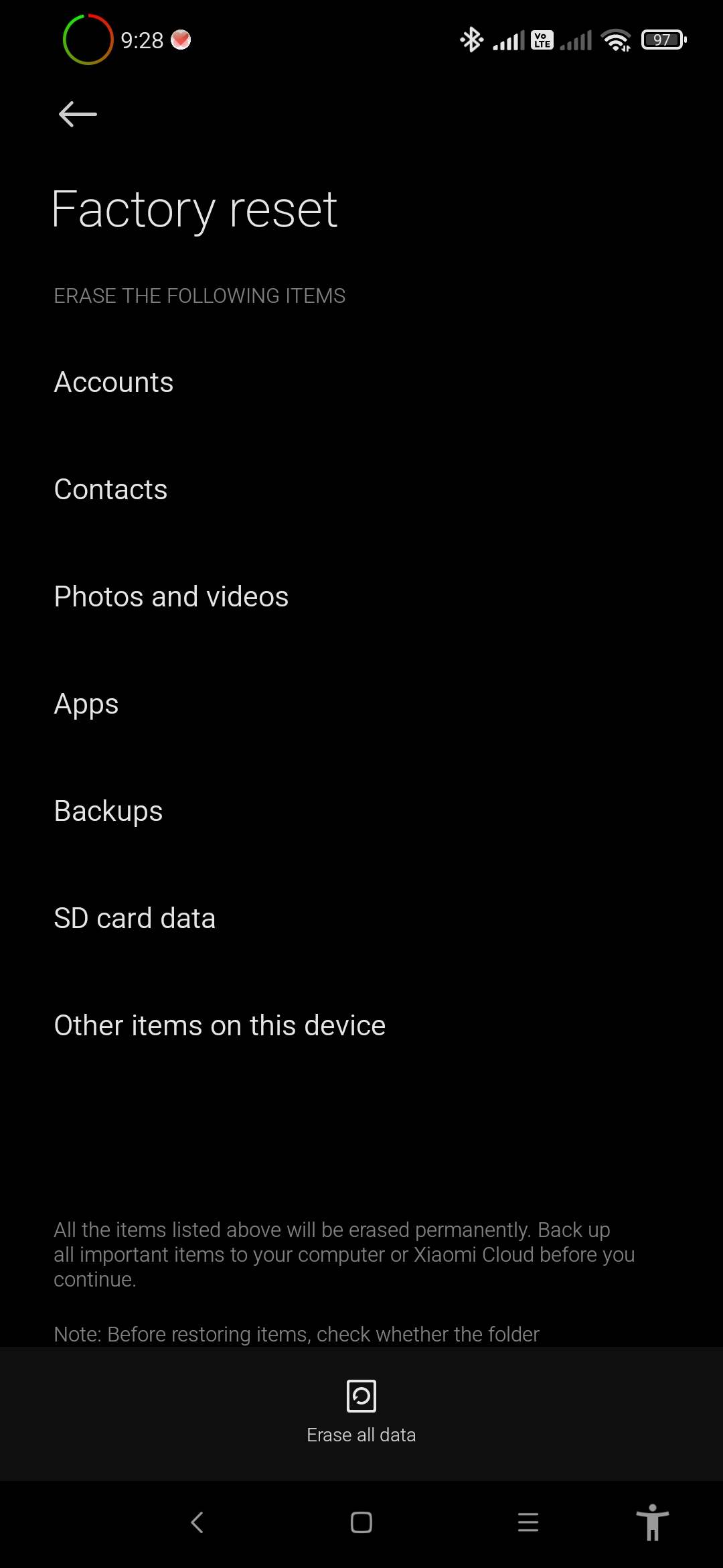

Are you staying in that original stock fastboot ROM? If you are and you probably won't have twrp, just go to factory reset and select erase all, see screen shot.
If you are going to update, then get twrp installed and once updated, you can select format from the wipe menu in twrp and then select format and type yes to confirm.

But this is not update, this is a fresh install, every time I set a screen password twrp is unable to decrypt the phone, so or you do a fresh install every week or keep your phone unprotected without a screen password...
Instead of clean flashing, you have two possibilities:
1) (RECOMMENDED) Set a pattern instead of a pin/password, for unlocking the screen of your device.
2) Remove your screen password just before installing a ROM update (then re-set a screen password after that).
