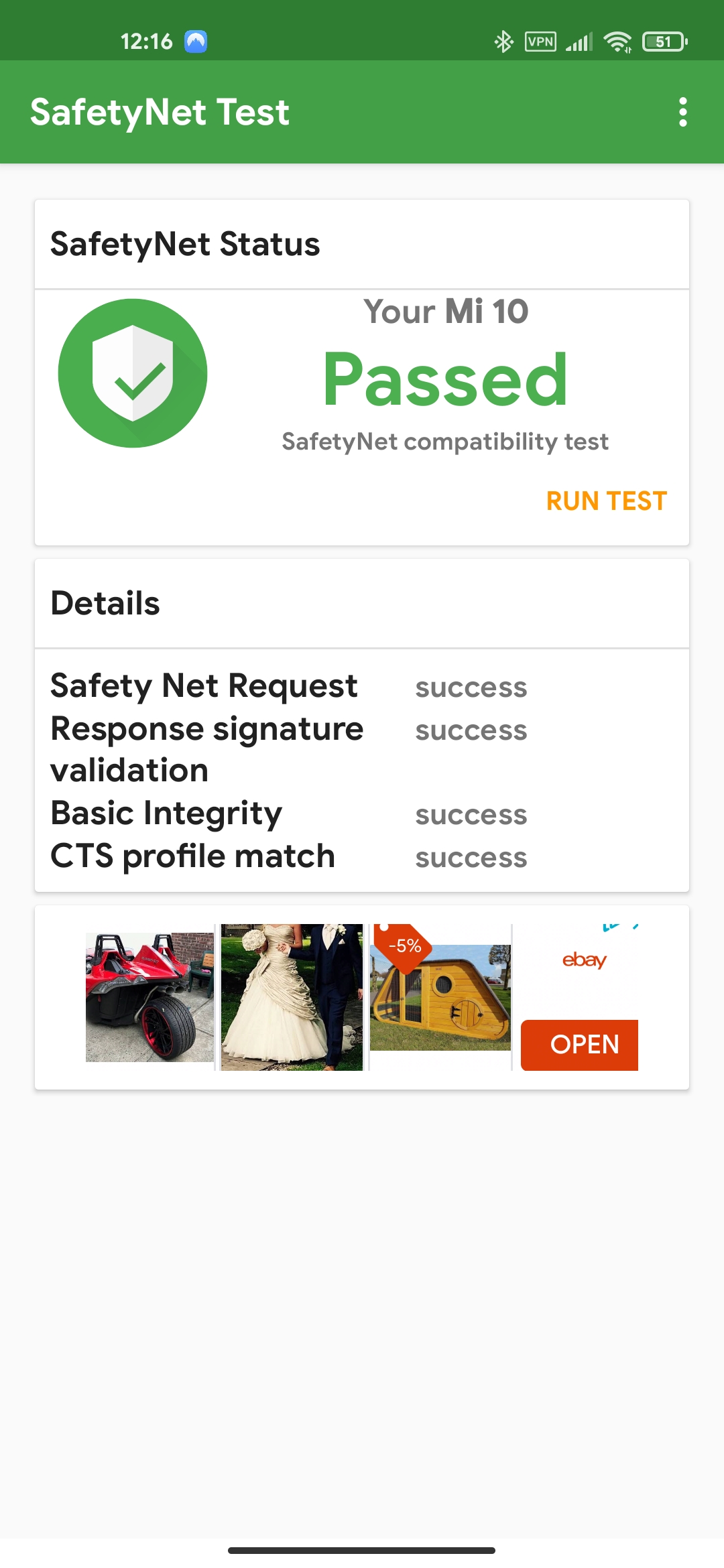

My usage with global mi 10 and Xiaomi.eu miui 12 dual sim

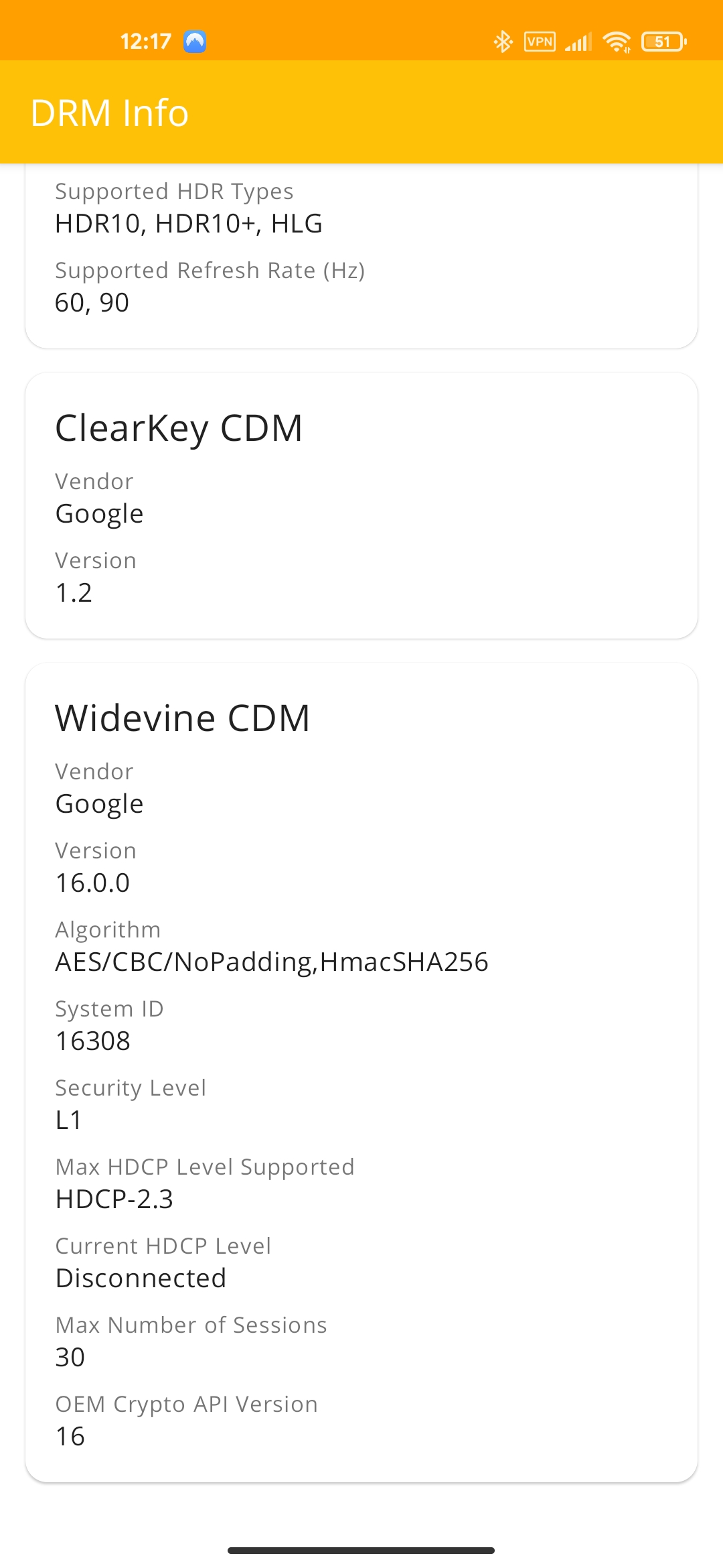

However, I can't pass safetynet with an open bootloader unless I flash persist.img (and this workaround probably won't work for long) - and even if I do this, I lose widevine l1, something I don't want to do.

Safety net and widevine L1 are available on xiaomi.eu. If your having problems it's likely that an earlier flash went wrong. You can try using the mi flash tool and go back to stock then flash xiaomi.eu this way you should get dual sim, widevine L1 and safetynet passed. I'm on the latest weekly build and have all three on my global xiaomi mi 10

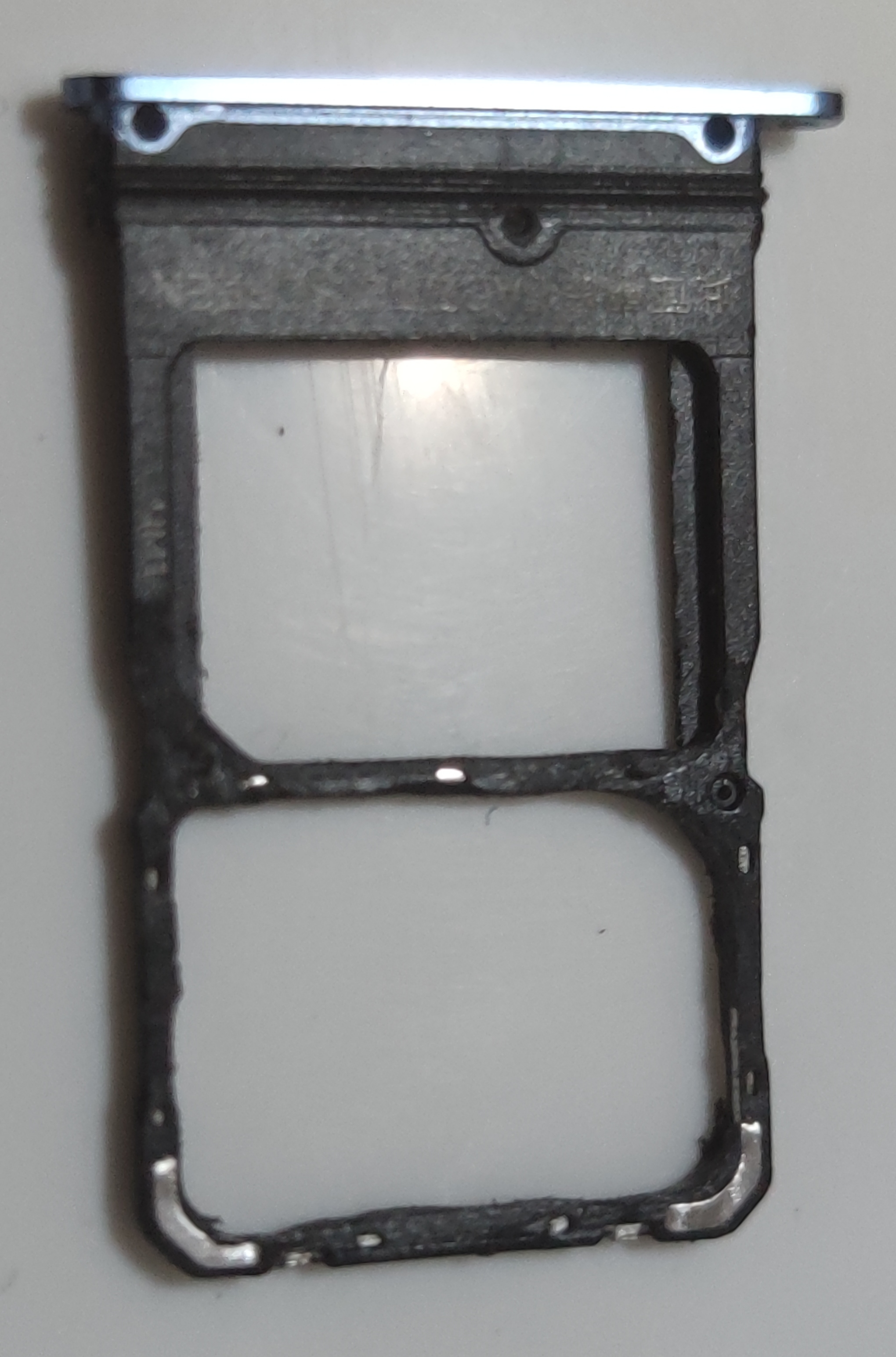

Does anyone know if sim tray can be used from another phone? Even with changes? For example the sim tray of oneplus 7 looks quite a lot.
You can try if you have a friend who can lend you one. Otherwise, just buy the sim tray for mi 10/pro (single or dual sim) online.
