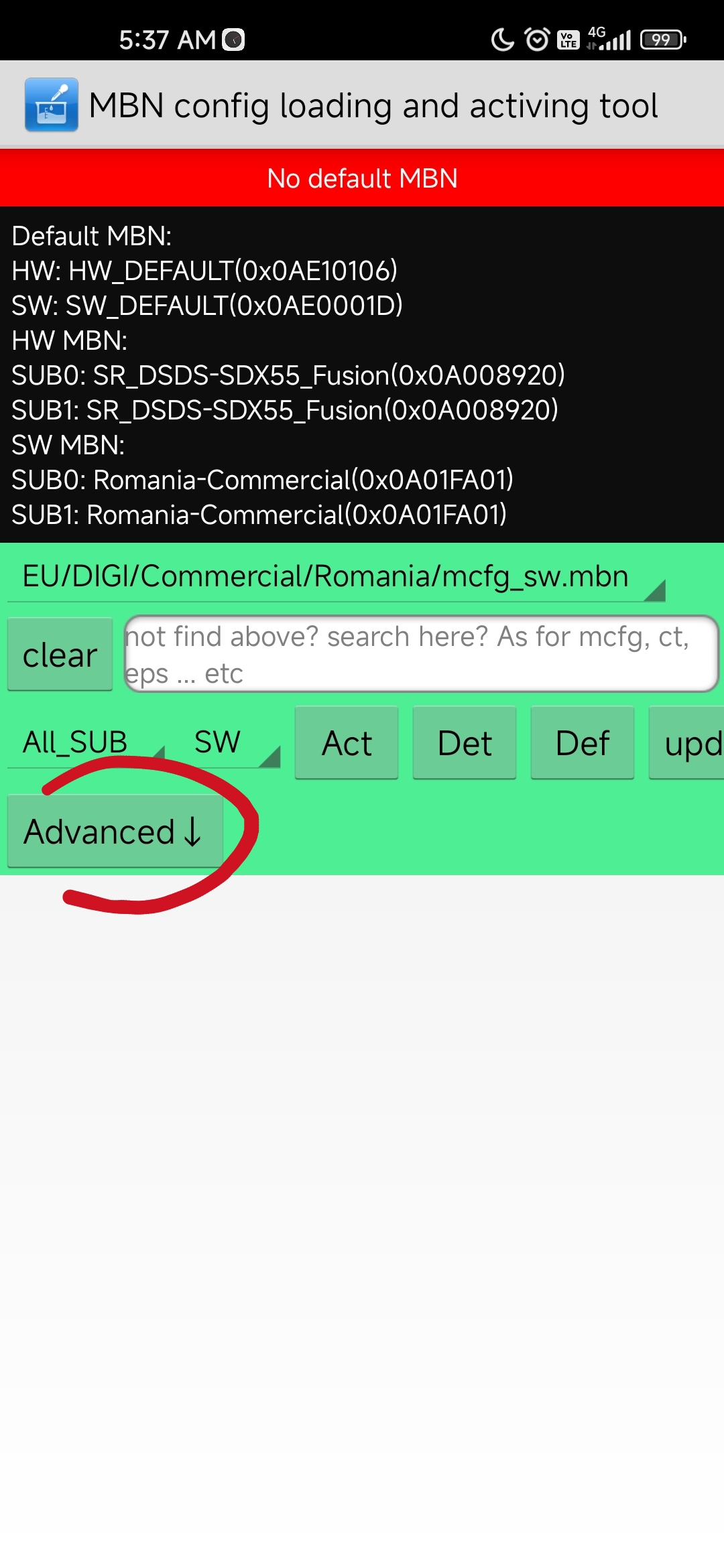

Seems not all Mi 10 5G models are supported by Nicaraguan mobile carrier, only the Chinese version seems to be compatible with all Nicaraguan mobile carrier bands.

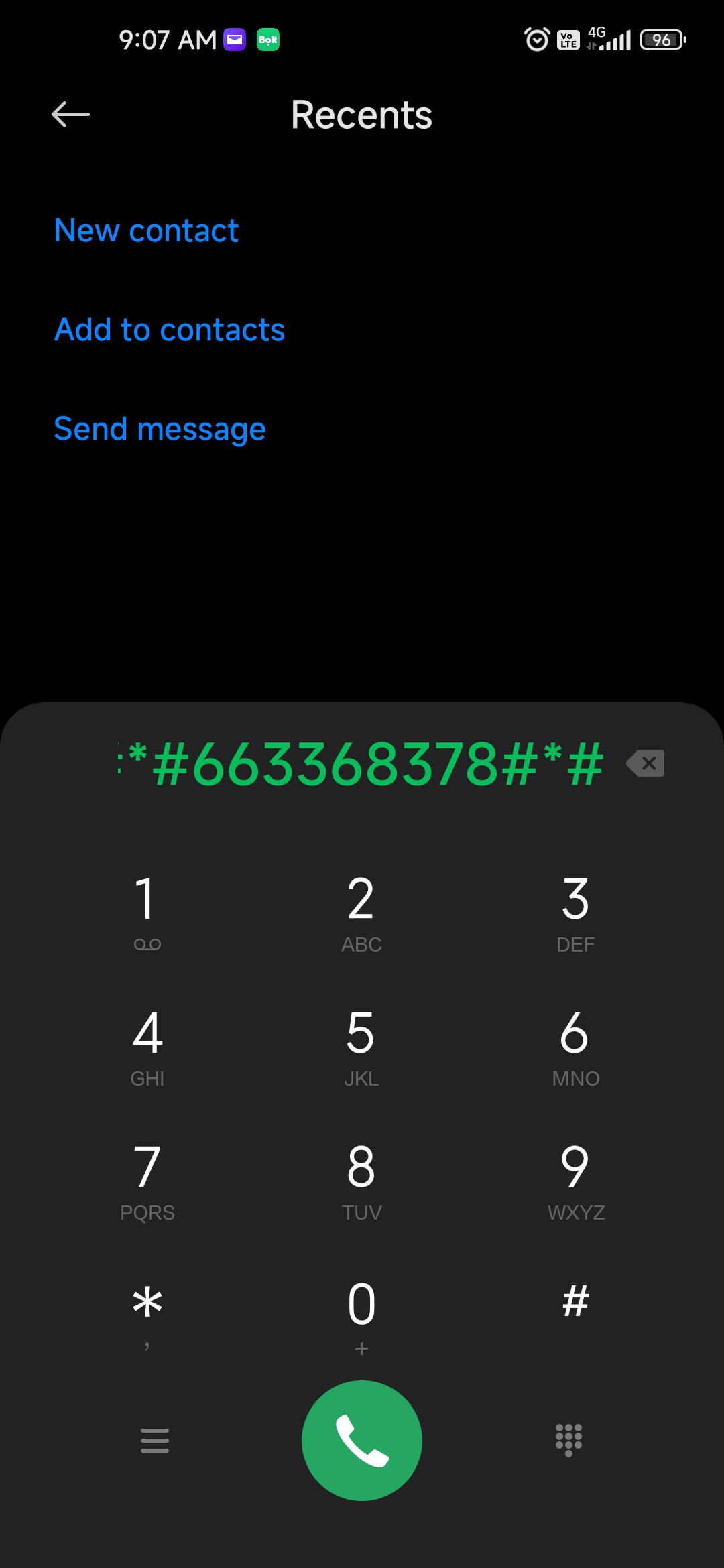

You also can try to modify the modem profile from "MBN config..." from "Modem Test Box" application, but unfortunately I don't know what to recommend you. This utility application can be opened by "dialing":
Code:
*#*#MODEMTEST#*#*
Code:
*#*#663368378#*#*

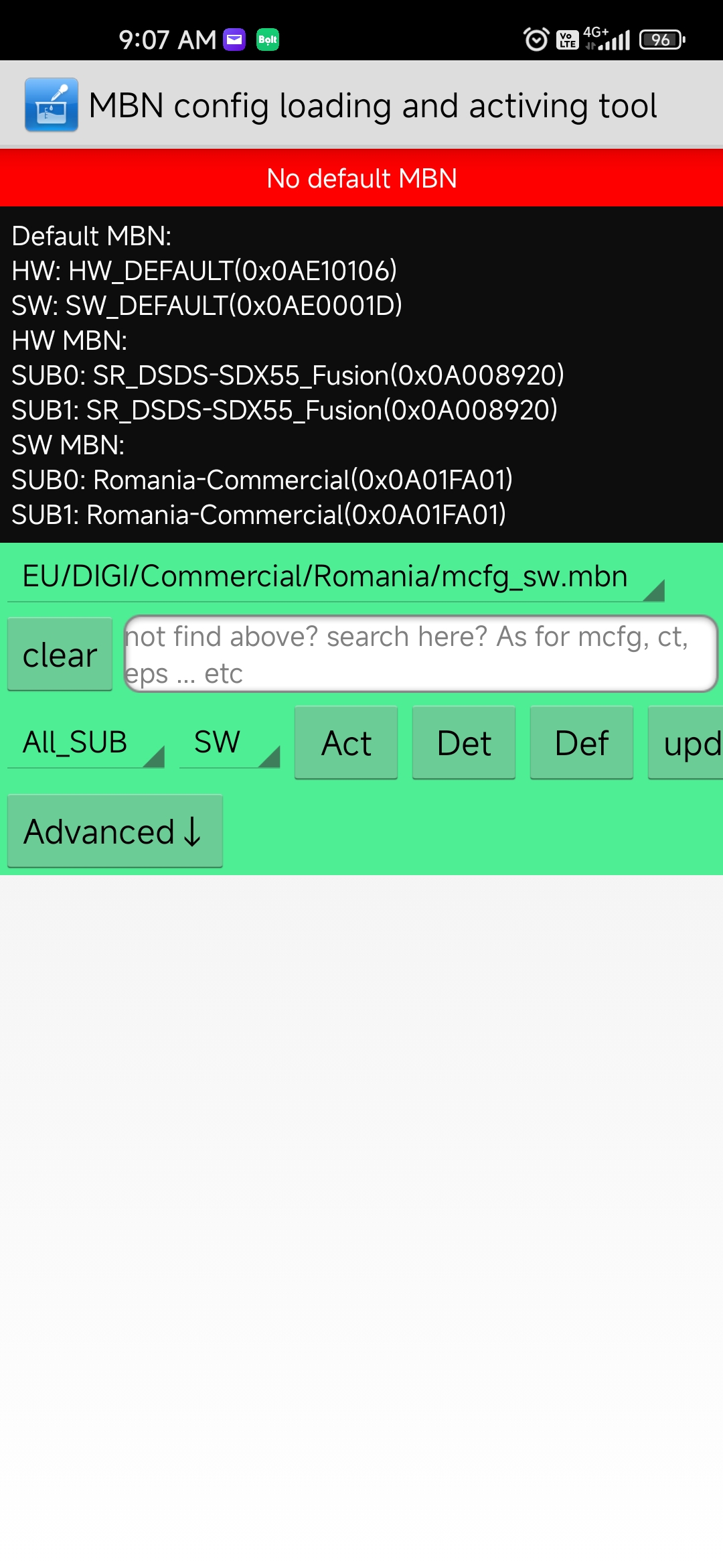

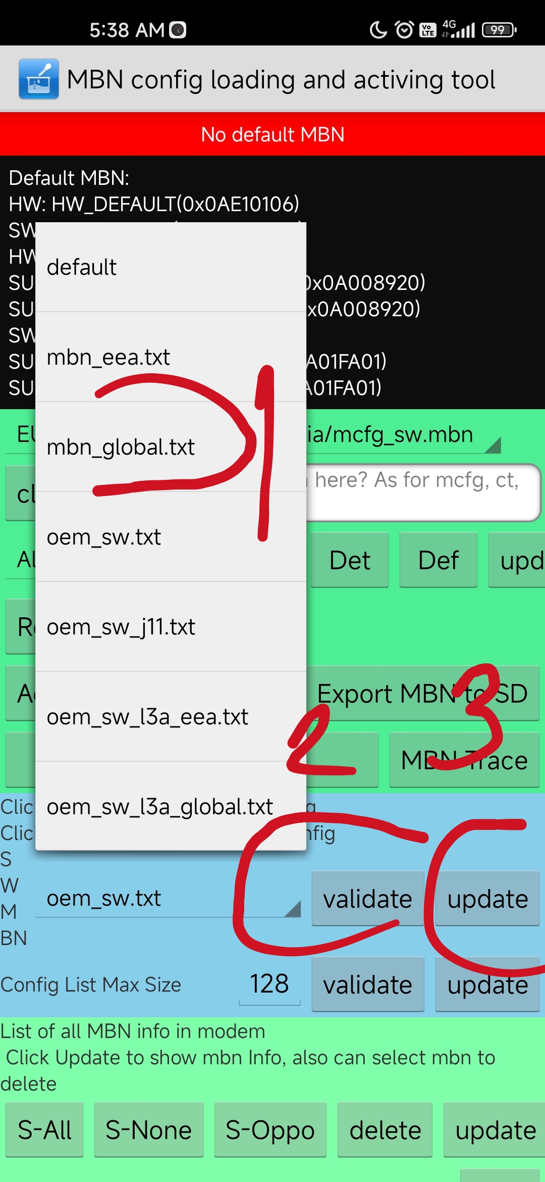

Thank you so much, the LTE works, but no LTE+ , however, my model is the global version with the EU rom. Also, the global ROM works well with the LTE+ it is only the EU ROM that does not seem compatible with the LTE+, I don't like the global ROM because I loose the dual sim capability. Any additional suggestion?
In that case is a modem configuration issue, most probably.

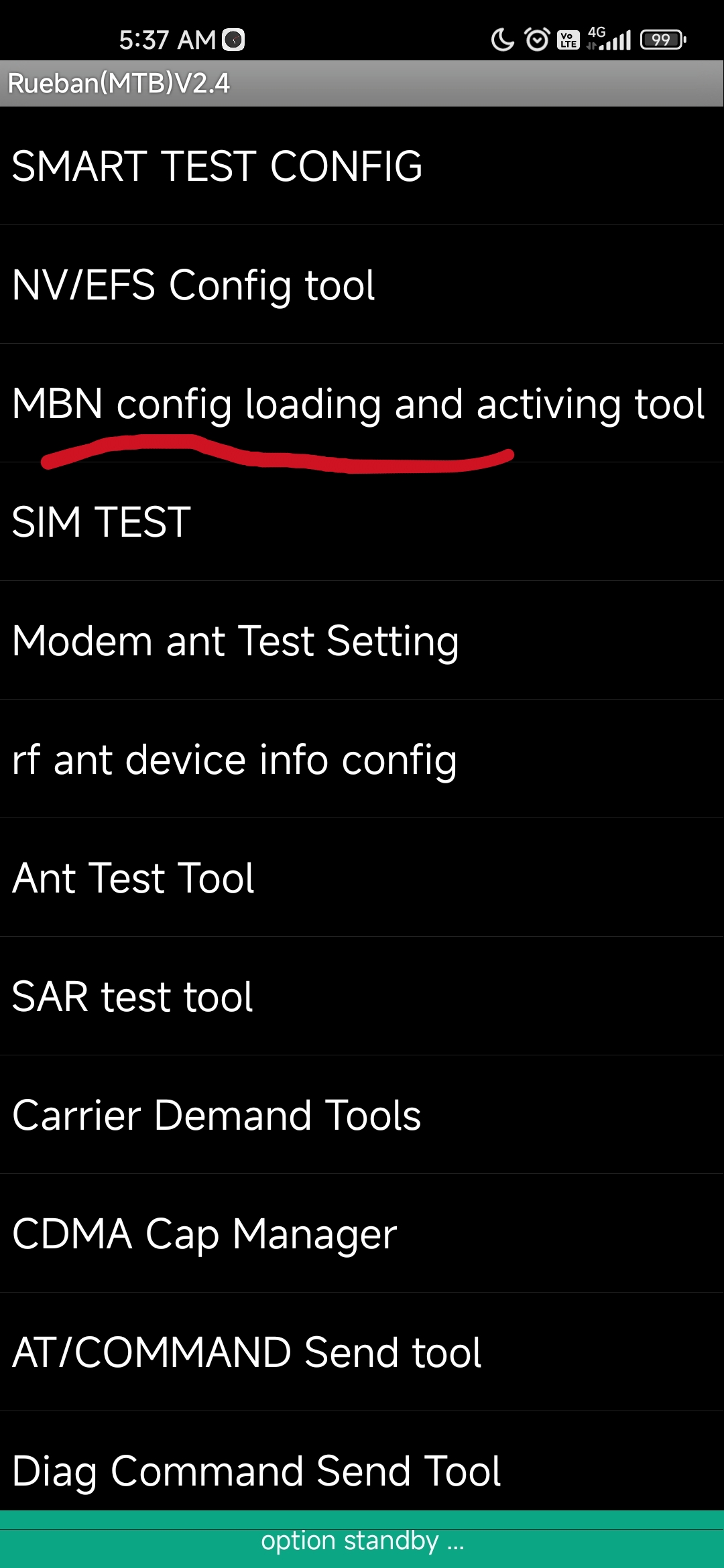

1. Launch the Modem Test Box application.
2. Go to the MBN config loading and activing tool
3. Click on Advanced
4. Select the mbn_global.txt from the list
5. Click on Validate
6. Click on Update
7. Restart your phone

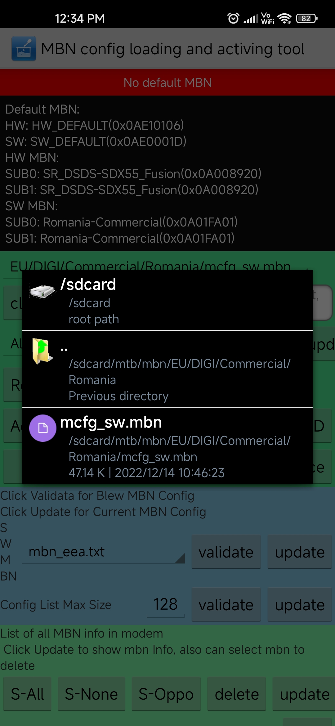

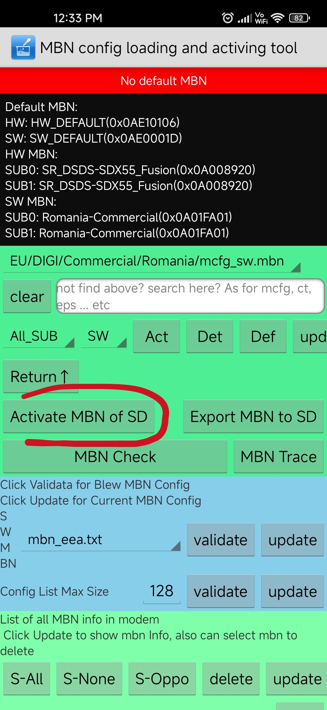

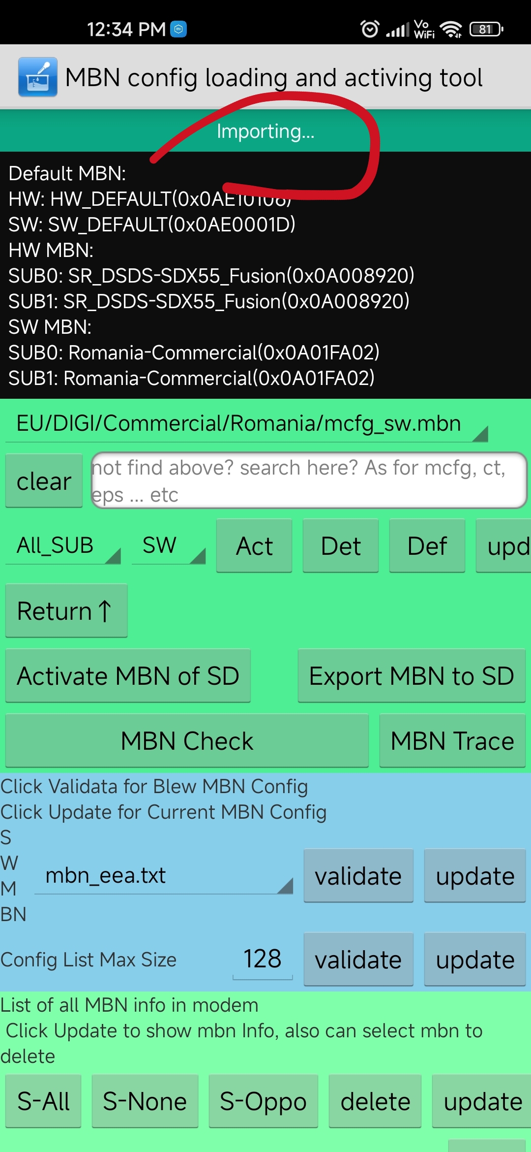

Thank you so much, I had tried this before, and tried once more and it still does not work, I had set it to global before, I even had tried to find my carrier on the list at the top, and tried with a different carrier and different simcard and it still does not recognize the 4g+, I had done this before to enable VoLTE. Was wondering if there is a way to load a carrier profile in the box at the top.,
It is possible to load (import) a carrier profile, but you have to obtain a MBN file for your operator.
There is a button which allow you to import this kind of file: Activate MBN from SD.
