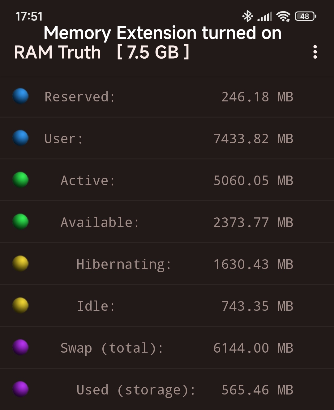

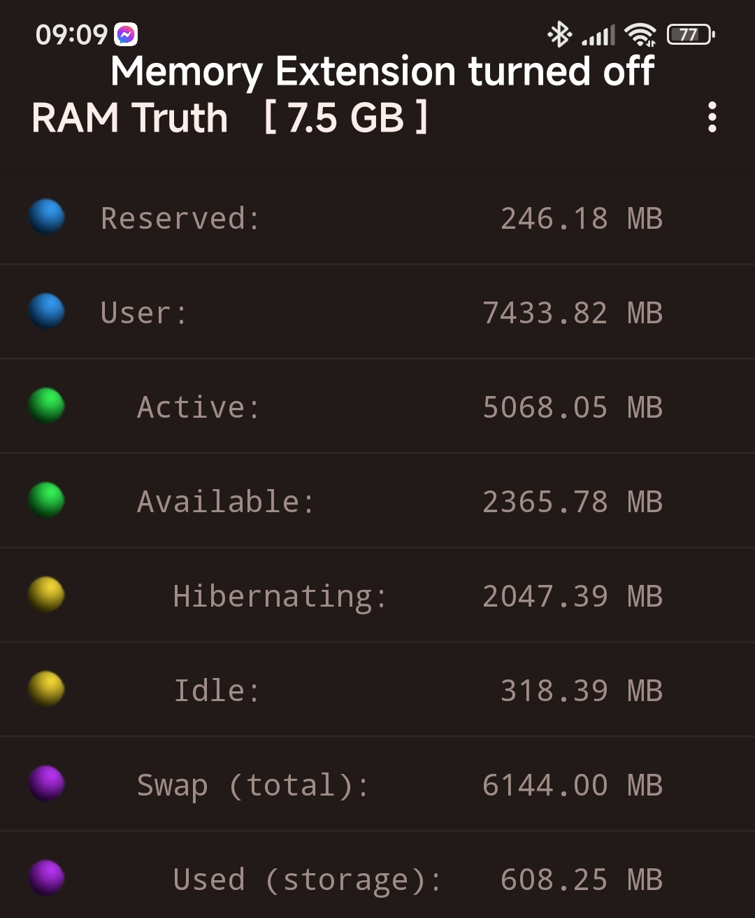

Well I tried both on and off and noticed that the phone feels less snappy when it's turned on. In the pictures below we can see that RAM usage is basically the same. That makes me believe that it's a gimmick, well at least for devices with 6+ GB of RAM.

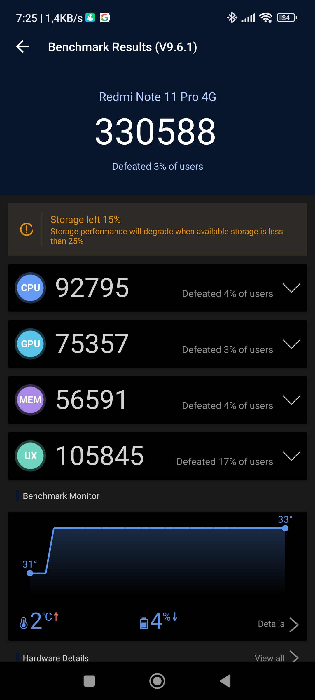

Hi, i have tested different solution, 0 3 and 5 ram extension with AnTuTu. Looks the pictures.

I mean AnTuTu is not really a real world performance test but there seems to be some kind of a difference.
I trust you but haven't "real" test, we need Xiaomi expert developer to shows us the way :)
Anyway i think in normal use (browser, email, social, ...) seems to be going well with any options, 0 or 3 or 5.
Using games i see a little lag sometimes in 0 ram configuration.
At moment, I'm using 3ram.

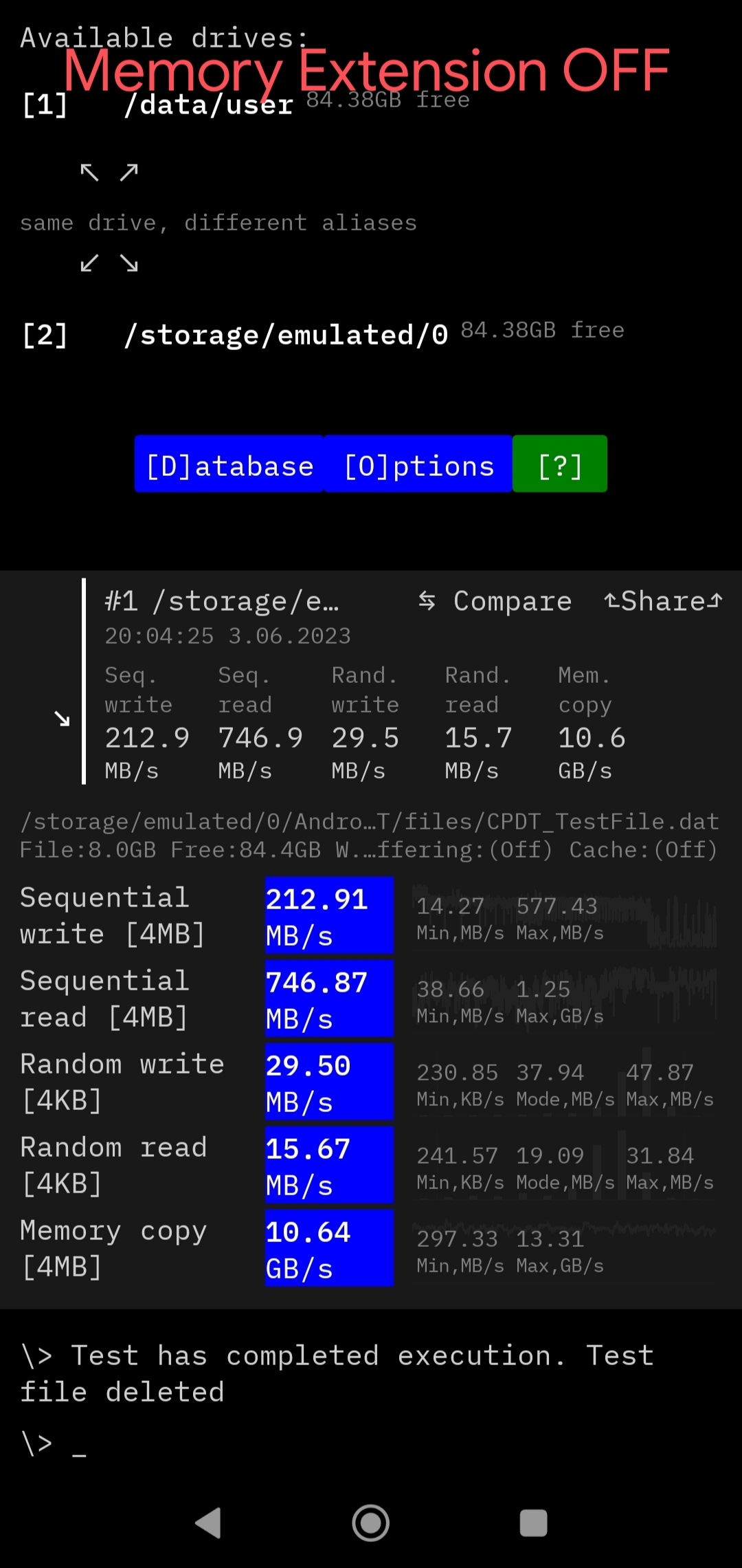

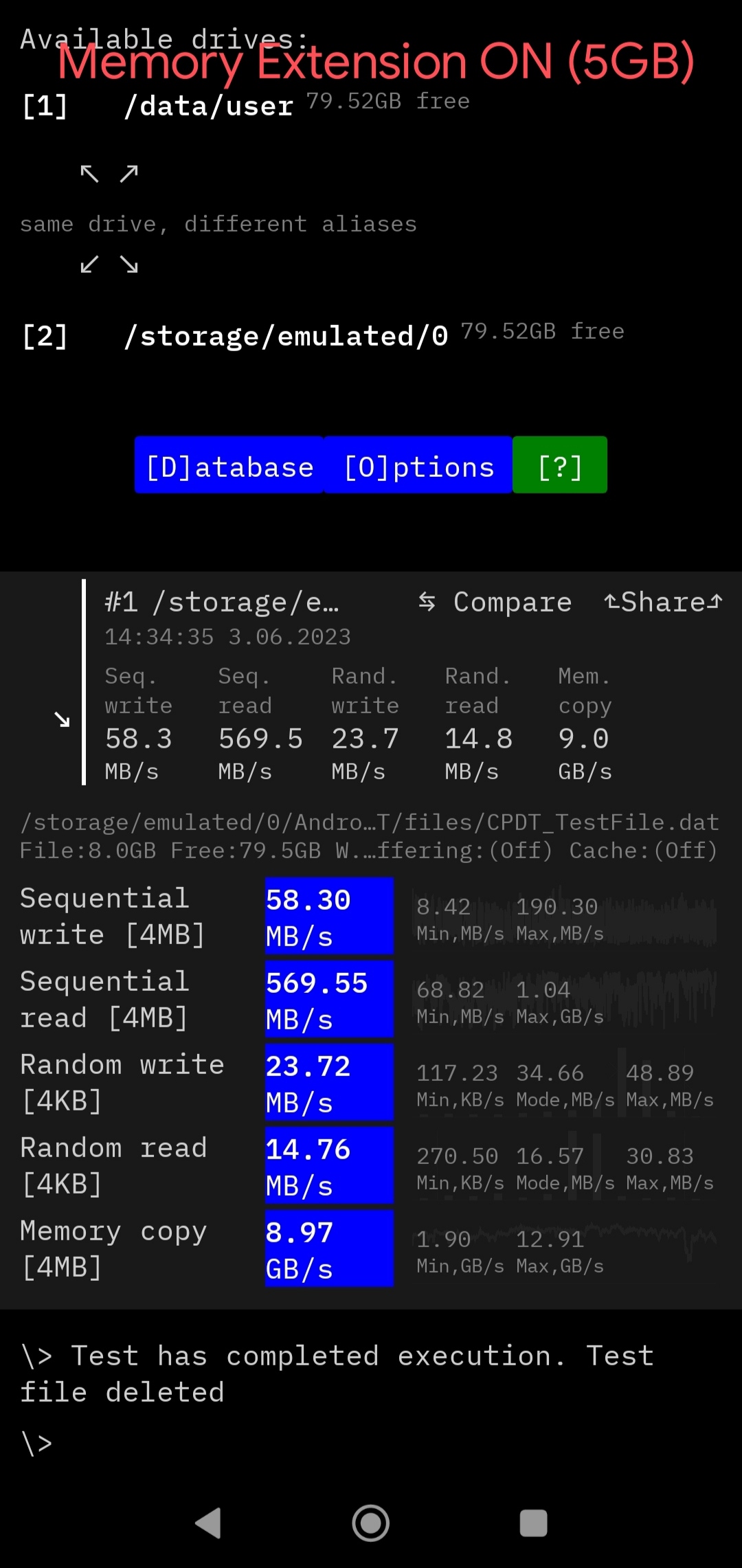

Hello. Memory extension makes my device slower specially in read/write operation of the storage. I confirmed this using the storage benchmark app CPDT. Just look at the pictures for results. With Memory extension enabled the sequential read and write operation of the storage significantly reduced by up to 70%. I repeated these benchmarks several times and I almost got consistent results. I also noticed the loading time of some games is faster when OFF. I'm using a Mi 10T pro with 8GB of RAM.
Also, turning that feature ON will cause your flash storage to wear out more quickly and reduce the operational lifetime of your flash memory.

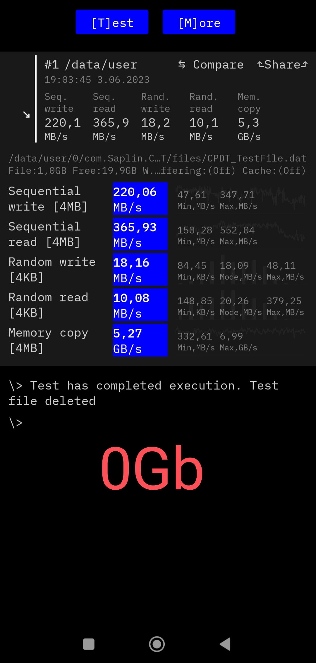

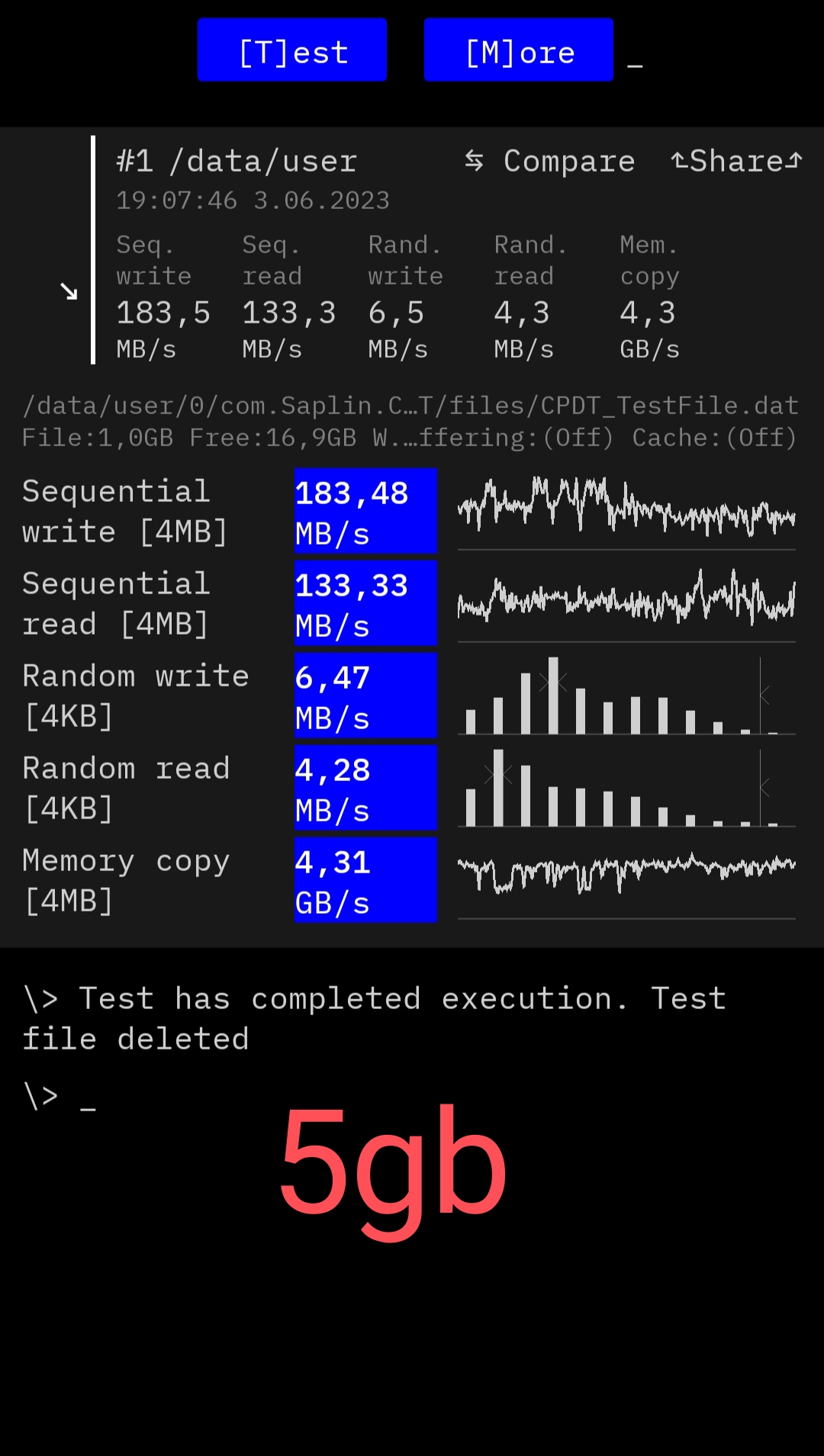

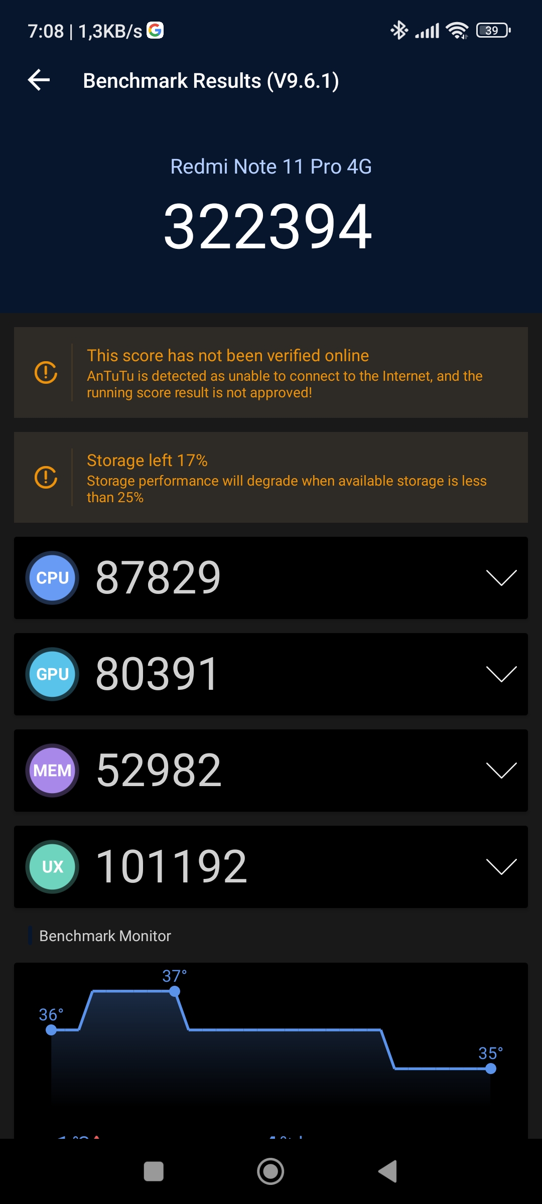

Ok I have made same test, Redmi Note 11 Pro, 0 and 5 Ram+
