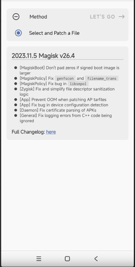

I have install the magisk app, and i am here. if I click on install, its asking me to select a path a file, which file do I need to select ? can you please guide me.
Follow the guide, you need to patch the boot.img file of your device rom that you installed.

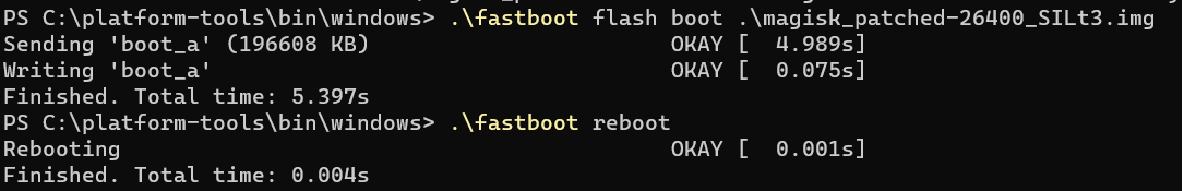

Move generated image to the PC. Run device in Fastboot mode. If you've unpacked ROM on PC, you can use it to flash an image (if not, use platform-tools); go to the ROM directory > bin > your host OS dir. Paste image there (the best solution present on the screenshot), then right-click anywhere on the directory > run Terminal (if option doesn't show, use Ctrl+Shift+RMB - for Windows lower than 11).

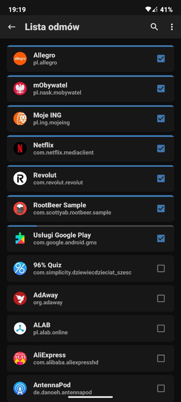

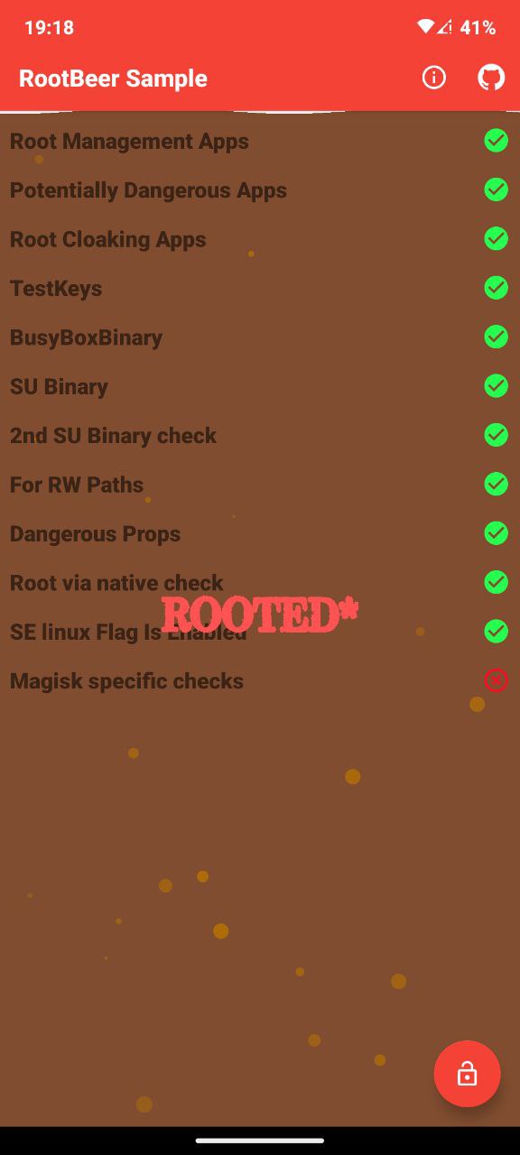

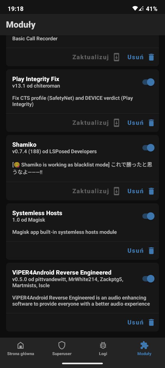

Hello, does the latest version of mObywatel work for you?
Everything else works.
mObywatel: 4.20
Magisk: 26.4( Magisk is hide)
It worked until recently.

@Kacper Skrzypek
mObywatel: 4.20
Checked just now on Xiaomi 12, works (but 1. I don't use this device daily, checked only app launch, 2. I had to enable Enforce DenyList).
Redmi note 10 pro, did it exactly like recomended on the first post. The only command that worked for mewas " fastboot flash boot magisk_generated_name.img"

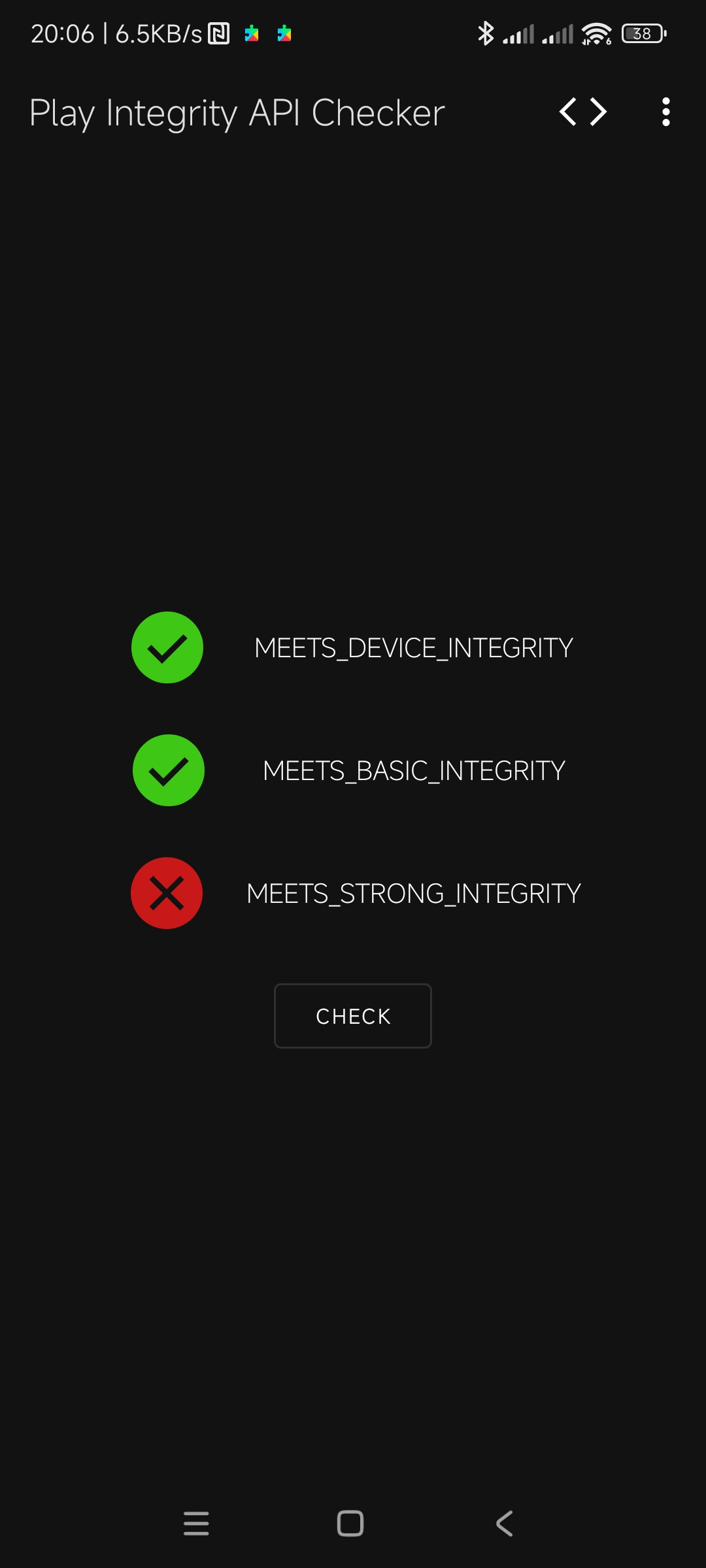

My Poco F5 in the current latest rebuild and play integrity fix (13.1)
Do I need to have strong integrity in order to use wallet (gpay) or if I get the message, to ignore and pay anyways?
Thanks in advanced
