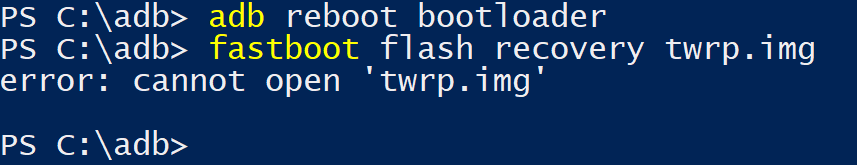

Bonjour,
J'ai un problème pour installer le TWRP sur mon MI 11 ultra, j'ai beau suivre le tutoriel, je reste bloqué sur erreur : ne peut pas ouvrir twrp.img (voir image jointe).
Le téléphone est déverrouillé, déboguage usb, reconnu en mode adb et fastboot....j'avoue ne rien comprendre. Pour info c'est la première fois pour moi que j'entre dans les "entrailles" d'un téléphone.
Peut-vous m'aider avec des mots simples que je peux l'installer afin d'obtenir les mises à jour OTA (je n'ai que le TWRP à installer, pas de ROM à flasher).
Merci pour votre aide, j'avoue être au bout de mes recherches.....HELP !!!!

Ehh not sure which tutorial you followed but don't flash the image just boot it.
Of course, you need to either rename the TWRP image you downloaded or use the name of it.

First of all, make sure the twrp you downloaded is the right one for your phone. Make sure you can read file extensions in windows because that ".img" must be the file extension not in the name. You don't need to flash the recovery but just boot it. Use this command "fastboot boot twrp.img". Phone should boot automatically in twrp. Oh one more thing, obviously you have to open your cmd as administrator into your adb directory and have the twrp image in the same directory

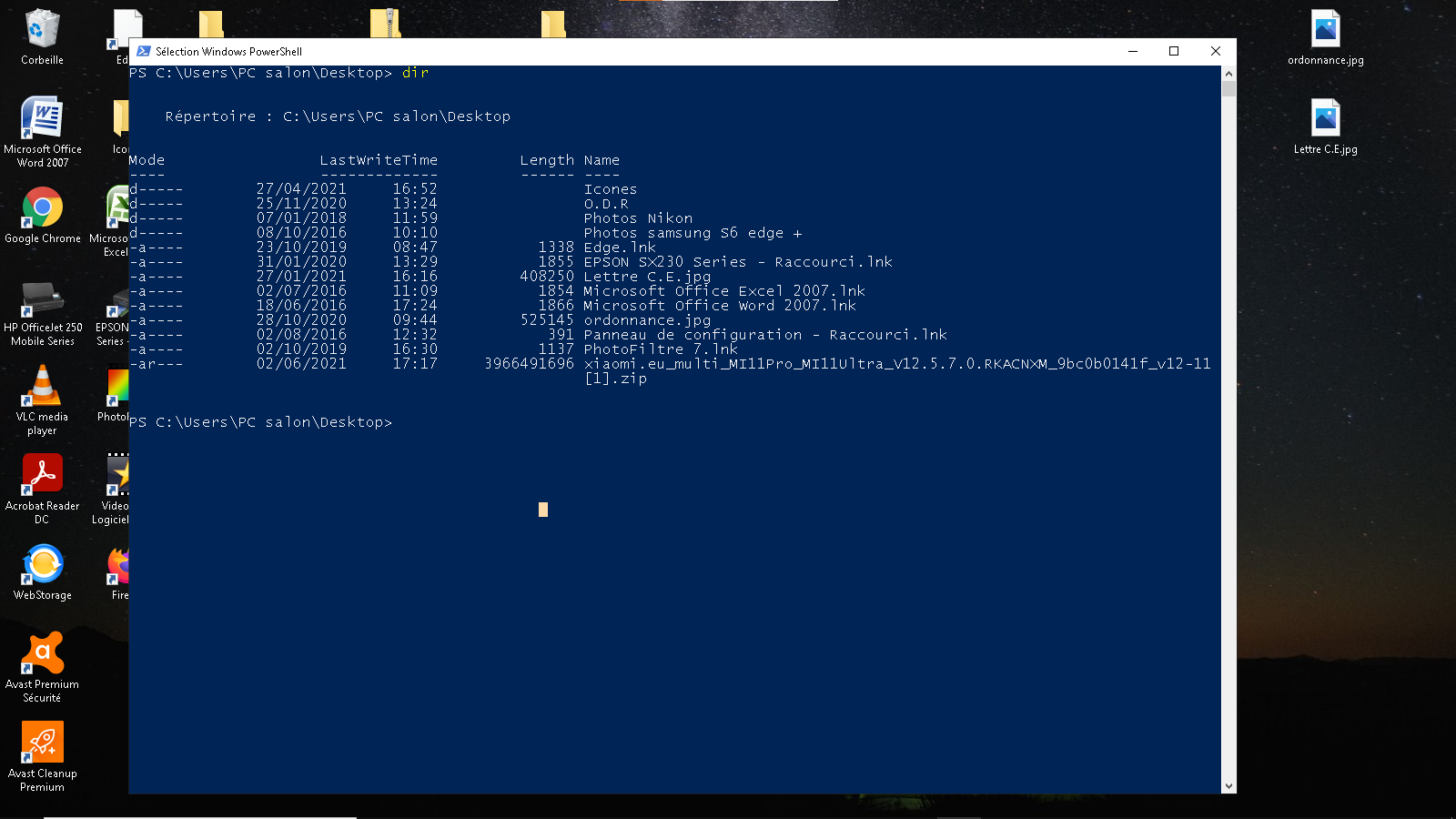

Sorry, I put in adb.exe and fastboot.exe the TWRP adapted to my phone but nothing happens I have "no such file or directory"
Type "dir" command in PowerShell to display files/folders of your current location. :)
If you see the "twrp ... .img" file, type: fastboot boot twrp then use the TAB key to auto-complete the filename of your TWRP (before using "Enter" key). ;)

No TWRP file......img when I type the "dir" command in powershell

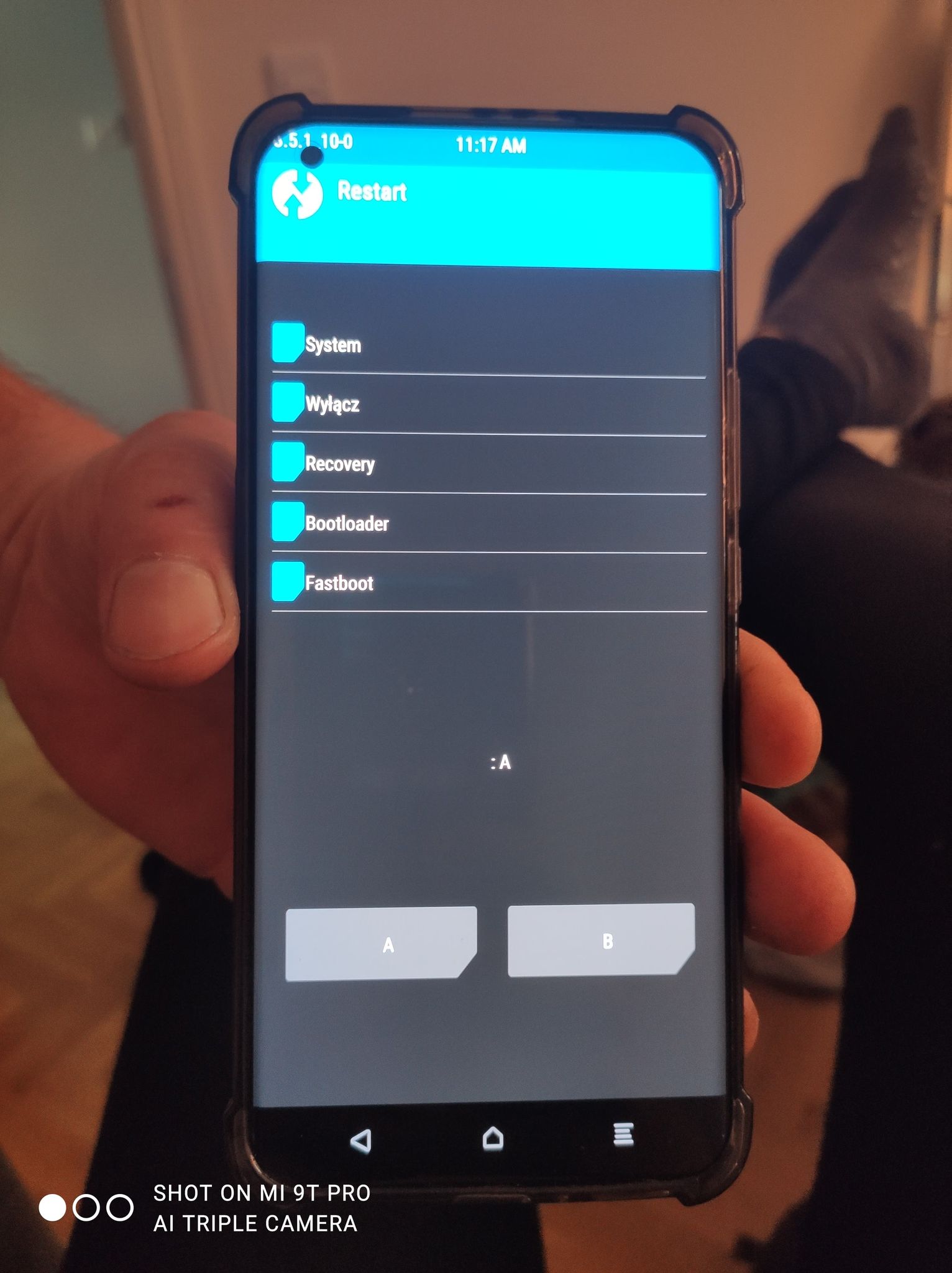

is this normal? I think I did something wrong. please help
I wanted to upload xiaomi.eu via TWRP but something went wrong. from TWRP position I cannot wipe my memory

Don't you have any basic knowledge about computer and filesystems?
Create a folder on c:
Avoid spaces in the name
Copy the twrp image and the Fastboot.exe into that folder
Alternatively use the adb folder from the latest Fastboot Rom zip.
Open an administrative shell (cmd) in this very folder.
Then start typing the commands (fastboot.exe boot twrp.img
It's not to hard, you can make it!
