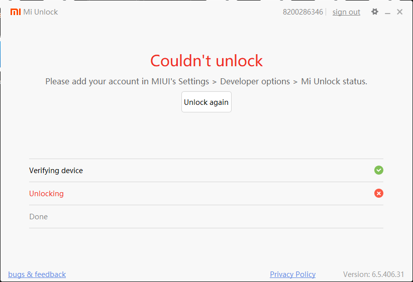

Bought a 12S Ultra and followed the bootloader unlock process. However, MI ulock after verification states that it cannot unlock. The only instruction is to add the phone to the account in the developer settings; there is no 168-hour wait time displayed. Despite that, I waited for 7 days with no luck; any assistance would be greatly appreciated.
Make sure the phone is bonded to your Xiaomi account on the phone and on the Xiaomi web page account or you won't be able to unlock.

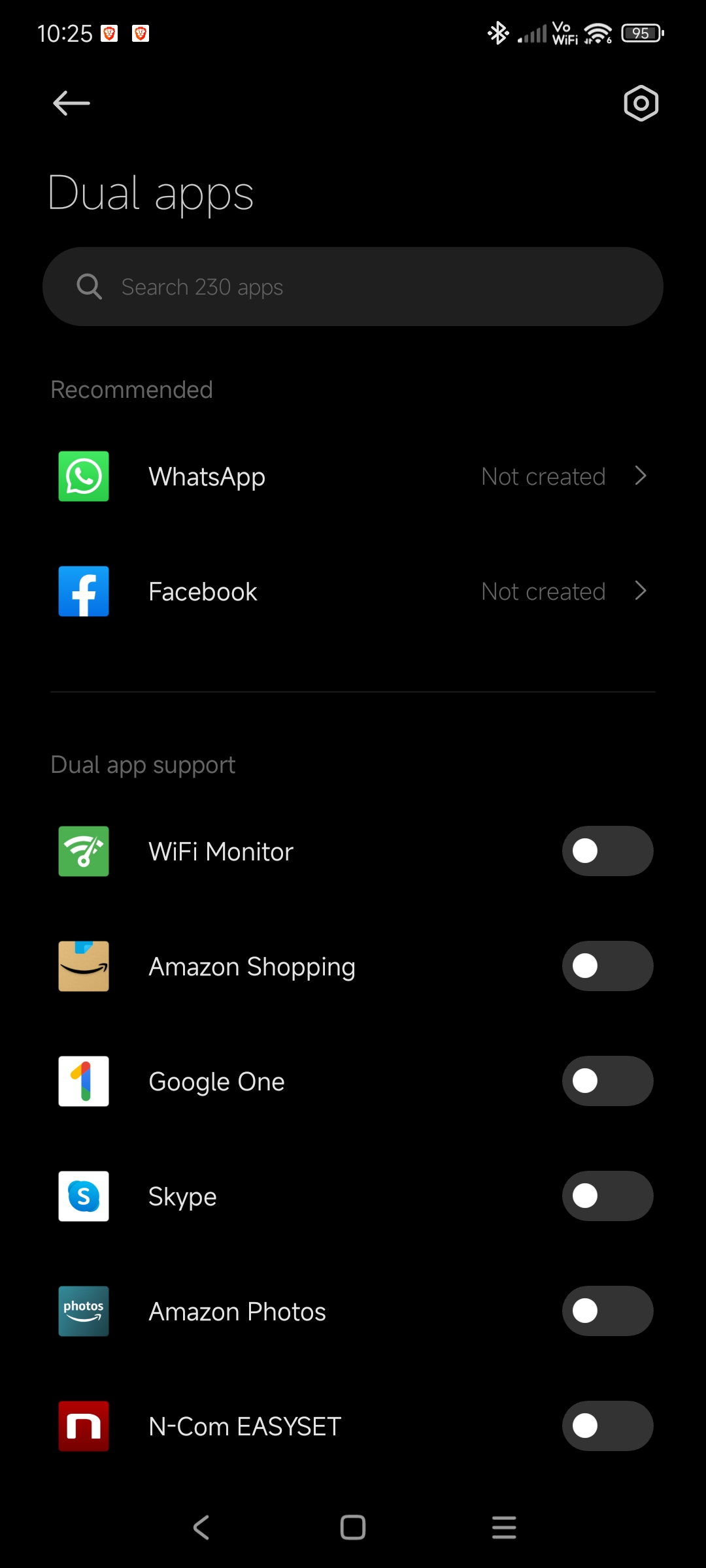

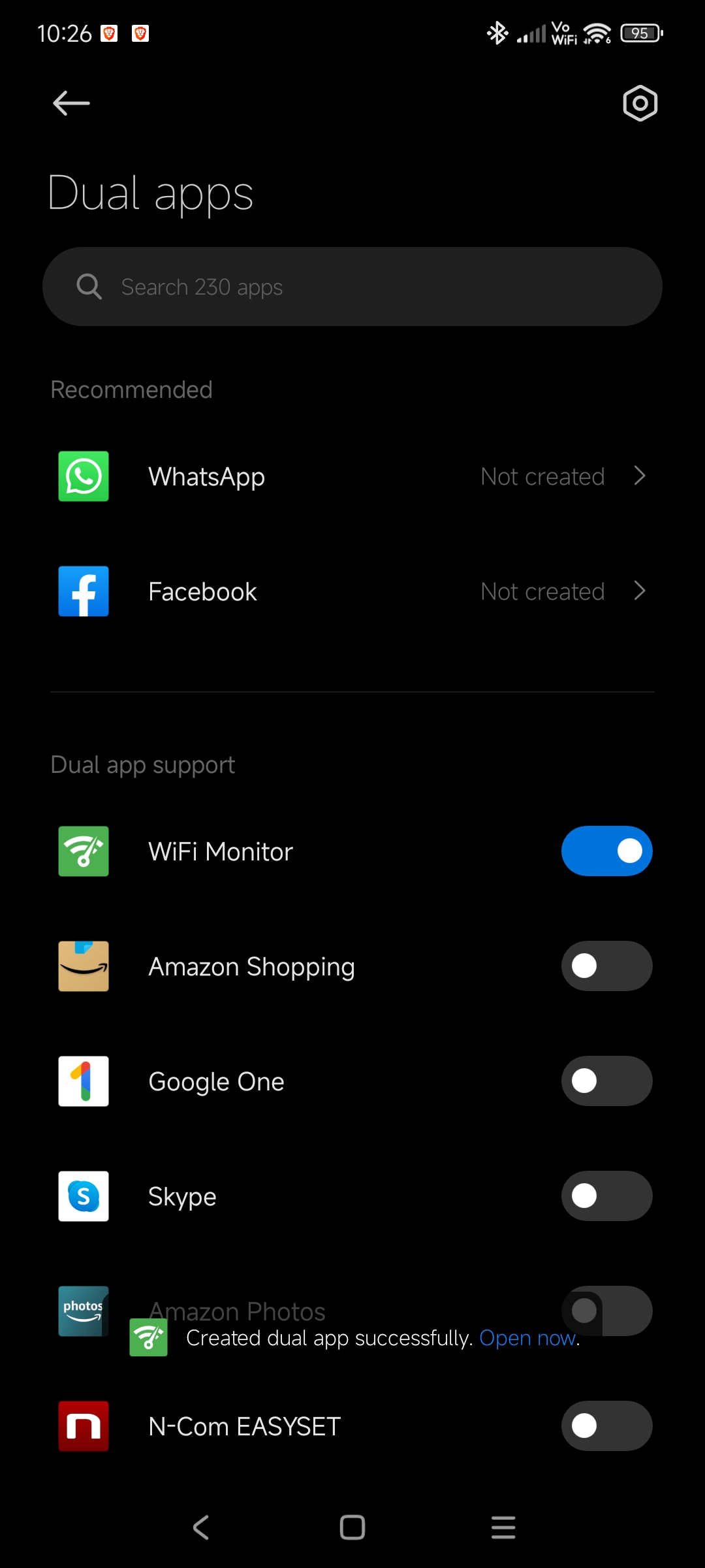

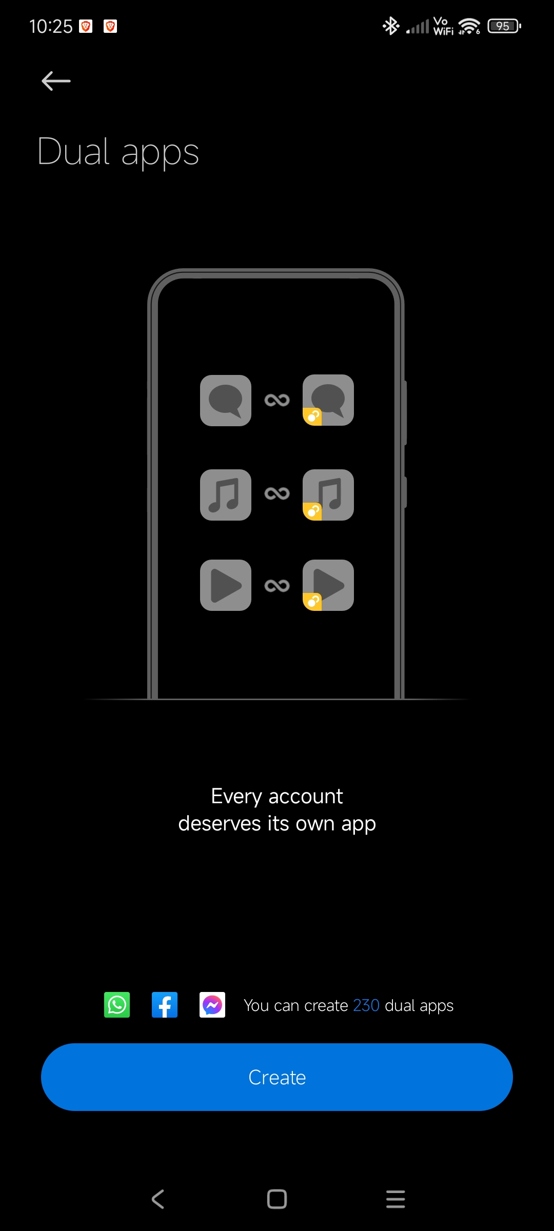

hi , i have 1 problem.. on my xiaomi 12s ultra on mi14. no working for dual app system. any help?
Works ok on mine using most recent eeu ROM.

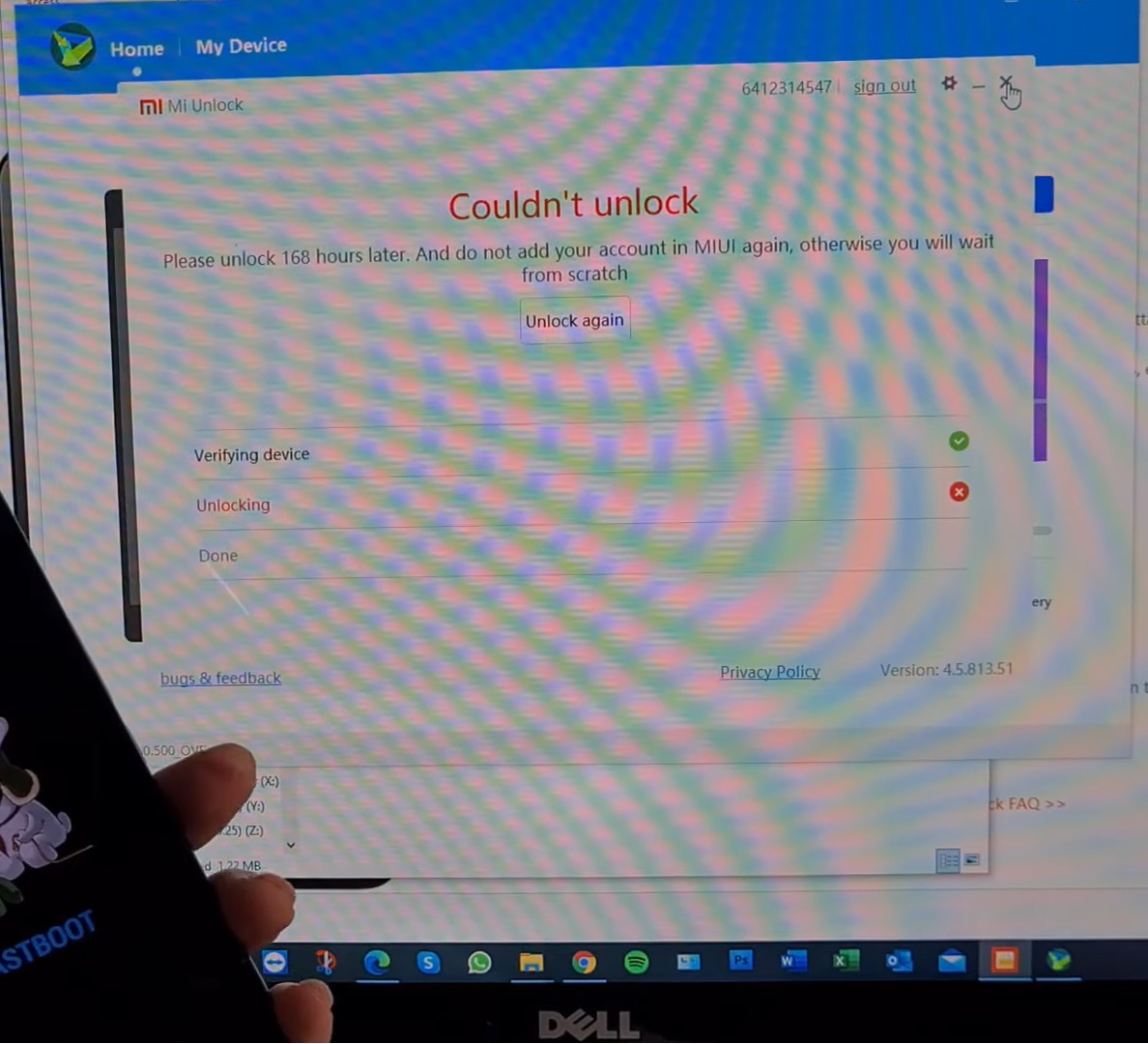

Despite my best efforts, the MI Unlock continues to display the same message. Can you elaborate about bonded to Xiaomi webpage? My phone is displayed when I log into my Xiaomi account online. I've also added it to the developer options in unlock status but it doesn't work. I am utterly frustrated because the MI unlock indicates there is no wait time. Don't know what to do; anyone help please if they are aware of what appears to be happening.

When you say - login to Mi account in developer settings, is that in the unlock status option? Because I've done that a couple of times and its the same message displayed on MI Unlock on my PC. I tried just now and its said - Couldnt verify, sign into your account and start again. After this I logged out and logged back in on the phone then in the unlock status and its successfully added. Howveer Mi Unlock still refuses to unlock.
Do you have WiFi turned off and mobile data turned on in your phone when you log in to the Mi account in the developer?
You must follow the procedure exactly.
I am not even getting the message to wait to unlock.

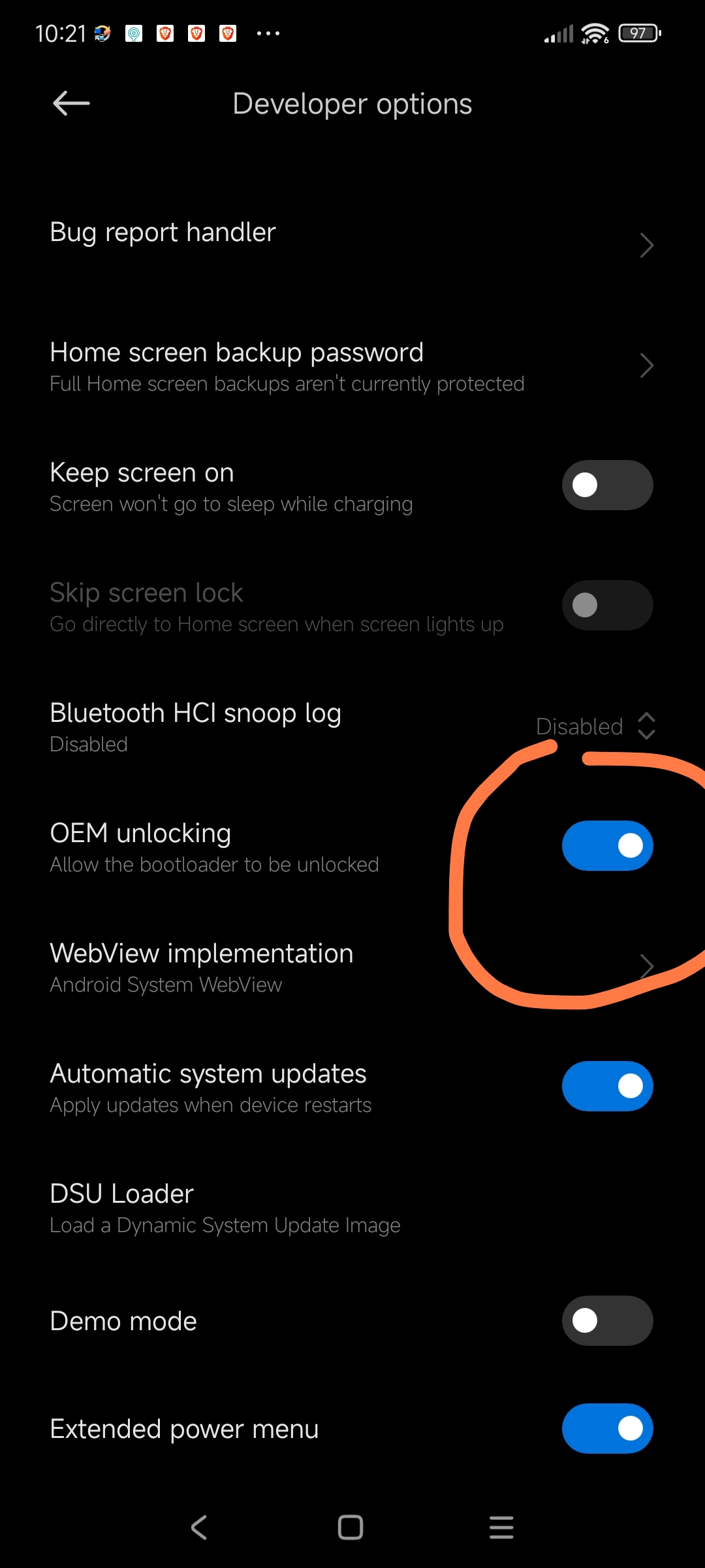

Fisrt of all, thak you for replying, really appreciated. Yes, Wi-Fi turned off, and connected to mobile data. Unless there is a different way of adding my account to the unlock status in developer options, I've already done it at least 8-10 times. It confirms that the account has been added succesfully but then when I connect to the MI Unlock on my PC, it just displayes the not unlocked message (screenshots shared already). It seems the registration is not going through. Despite all of that, I've waited close to 2 weeks now but nothing.
I only have the one radio button in dev options, nothing about anything else,
