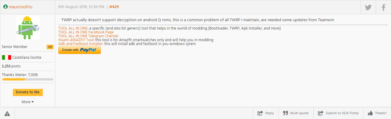

This is the official statement of the TWRP Creator for the Mi 9.
- Versions 37 and 41 have added Android 10 UNENCRYPTED SUPPORT, but no statement has been made about Android 10 ENCRYPTED SUPPORT.

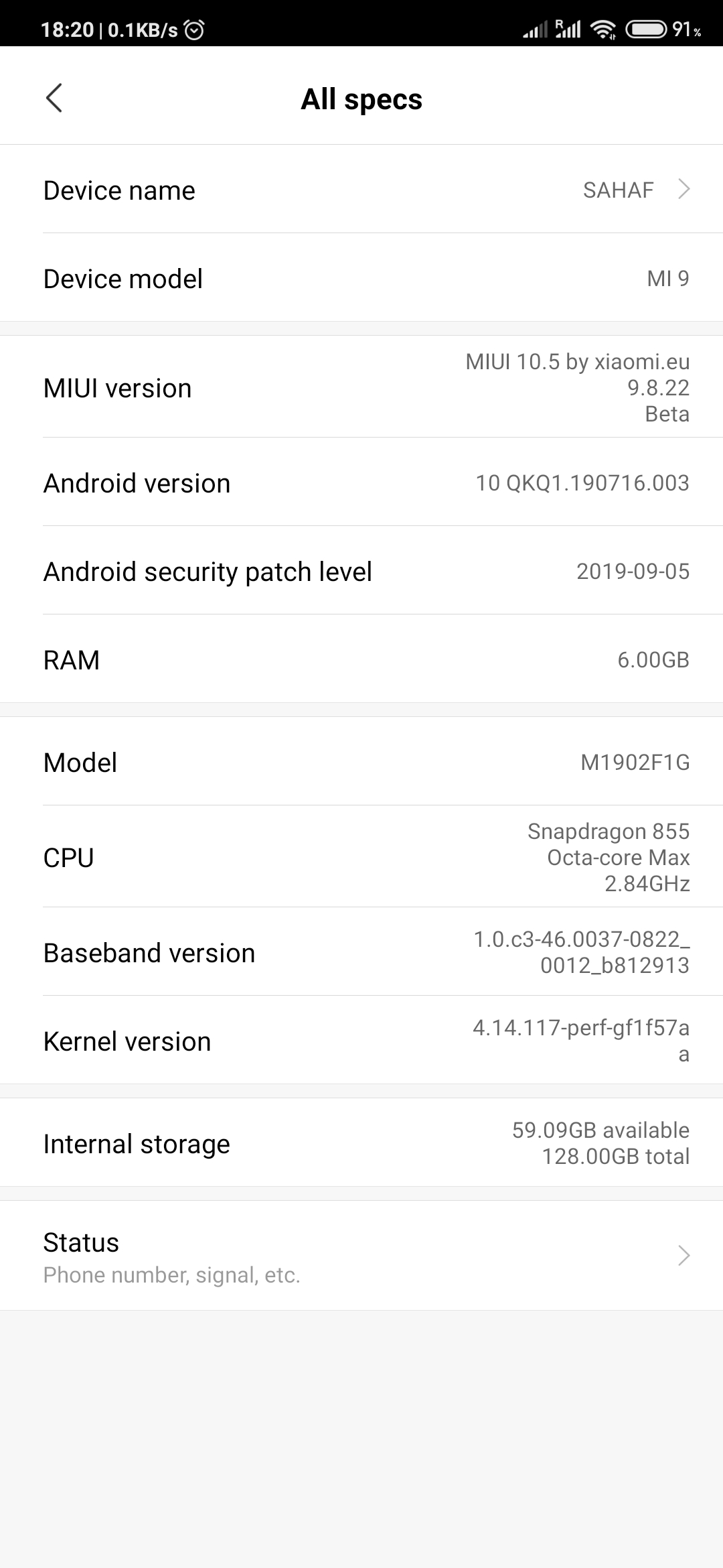

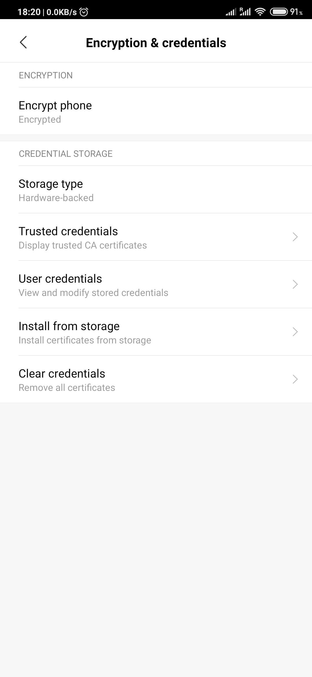

Pls check below image, everything works fine encrypt and decryption.

Ok?? I flash the last version of xioami.eu from internal storege with 3.3.1.41...
This rom seems to have the trwp version 3.3.1.37, this is installed when the rom flashes. The flash is fine except for the error message of partition mounting after the flash ... Tried to do even full wipe .. Equal, the phone however it works well
I repeat with this version xioami.eu and trwp (37/41) I insert the combination of wipe to decrypt the internal memory .. It works well
