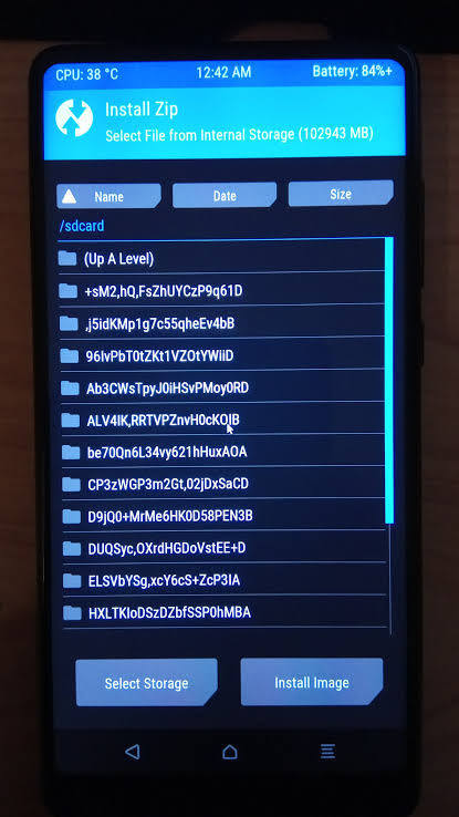

This is how my device is encrypted after installing Eu rom. EU rom does not update Redmi Note 8
C canicet Members Jan 30, 2021 6 3 Jan 30, 2021 #1 This is how my device is encrypted after installing Eu rom. EU rom does not update Redmi Note 8 Attachments images.jpeg 51.3 KB · Views: 247
C canicet Members Jan 30, 2021 6 3 Jan 30, 2021 #3 Actually there was no such problem but after 20.12.9 update I encountered this error
Poney70 Donator Oct 3, 2019 5,490 337 Jan 30, 2021 #4 Try with this new TWRP version => https://androidfilehost.com/?fid=17248734326145713990 Flash it via fastboot.

C canicet Members Jan 30, 2021 6 3 Jan 30, 2021 #5 I installed twrp with xiaomi tool, it must be the newest version
Poney70 Donator Oct 3, 2019 5,490 337 Jan 30, 2021 #6 No, different TWRP developper exist. Also, Official TWRP doesn't mean it's the better TWRP.
C canicet Members Jan 30, 2021 6 3 Jan 30, 2021 #7 is there a possibility that the device is bricked? Will my data be SAFE?
Poney70 Donator Oct 3, 2019 5,490 337 Jan 30, 2021 #8 canicet said: is there a possibility that the device is bricked? Will my data be SAFE? Click to expand... No, it's safe to flash this given TWRP . Reactions: geoanto555
C canicet Members Jan 30, 2021 6 3 Jan 30, 2021 #9 thanks i will try. Is the link you dropped for redmi note 8?
C canicet Members Jan 30, 2021 6 3 Jan 30, 2021 #10 and can I install this twrp you sent with xiaomitool v2?
Poney70 Donator Oct 3, 2019 5,490 337 Jan 30, 2021 #11 canicet said: thanks i will try. Is the link you dropped for redmi note 8? Click to expand... Yes, it's for Redmi Note 8 "ginkgo" (codename) canicet said: and can I install this twrp you sent with xiaomitool v2? Click to expand... I never used XiaomiTool v2 but if it can flash the "recovery" partition of your device it's fine.
