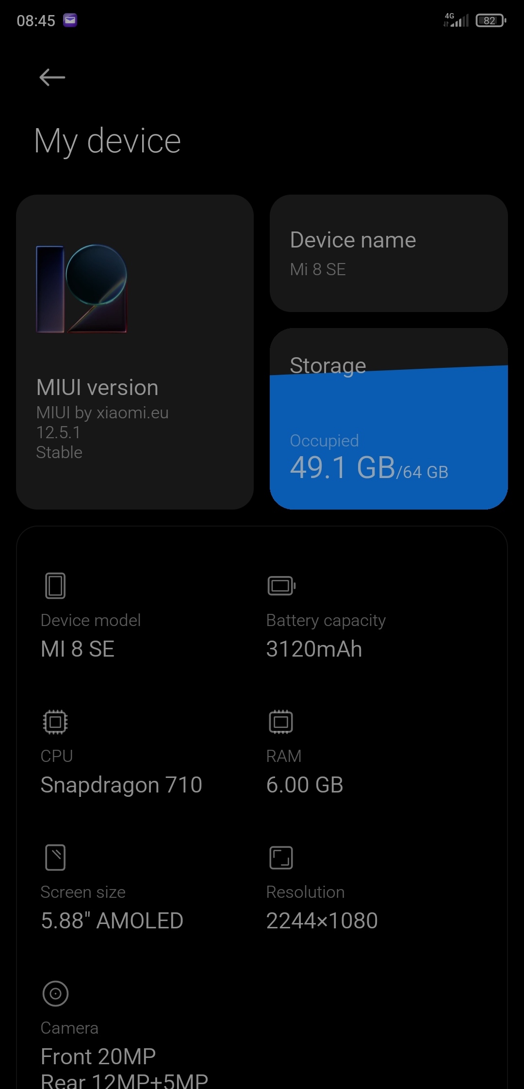

I can't install the XIAOMI EU ROM

Follow these instruction in 24/6/2023, finally my phone works as expected, after one week works as an expensive brick
thanks for your value contributions for Mi8SE community,
I think the main problem is when we are using the XiaoMitoolV2 which is an awesome tool, to unbrick our phone,
it unintentionally upgrade to the latest china rom (12.5.1) and that make conflict with the EU rom we flash later.
That's why we have to follow these instruction above to degrade the system as before:
