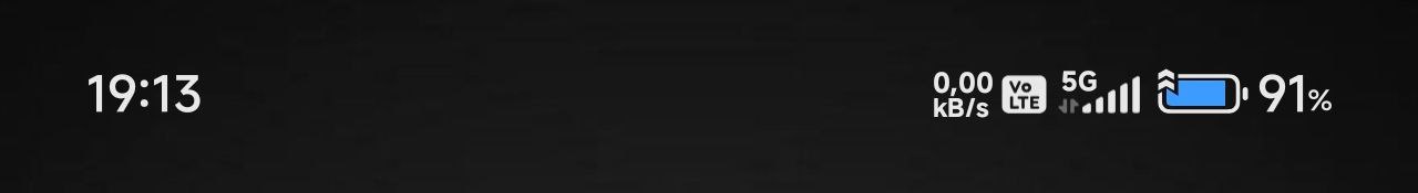

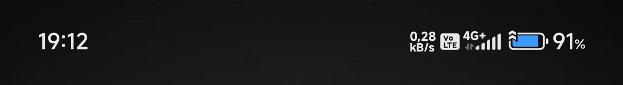

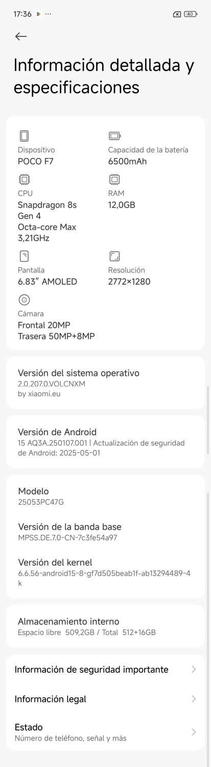

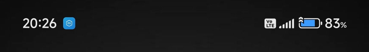

Good morning, does anyone else NOT have internet with the Poco F7/Onyx? I have data on the Xiaomi 15ULTRA and S25ULTRA, but not on the F7.
Need to change this:
modem.bin
modemfirmware_ww.img
If you notice on my network, there is no data connection.
@Igor Eisberg @gogocar62

Would make more sense if you didn't flash Global modem (NON-HLOS.bin), but rather modemfirmware (MODEM-FW.bin) to modemfirmware_ab instead.

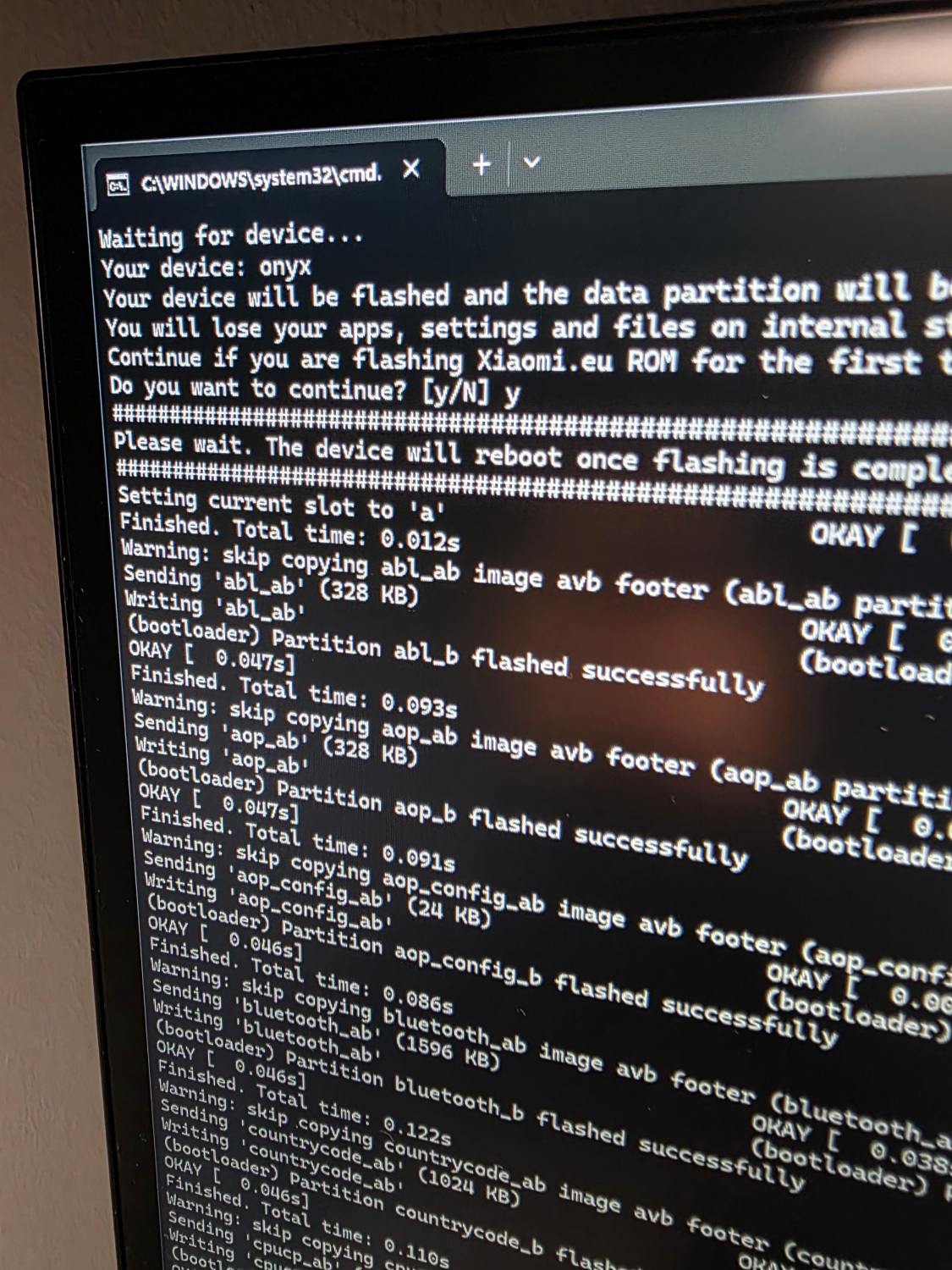

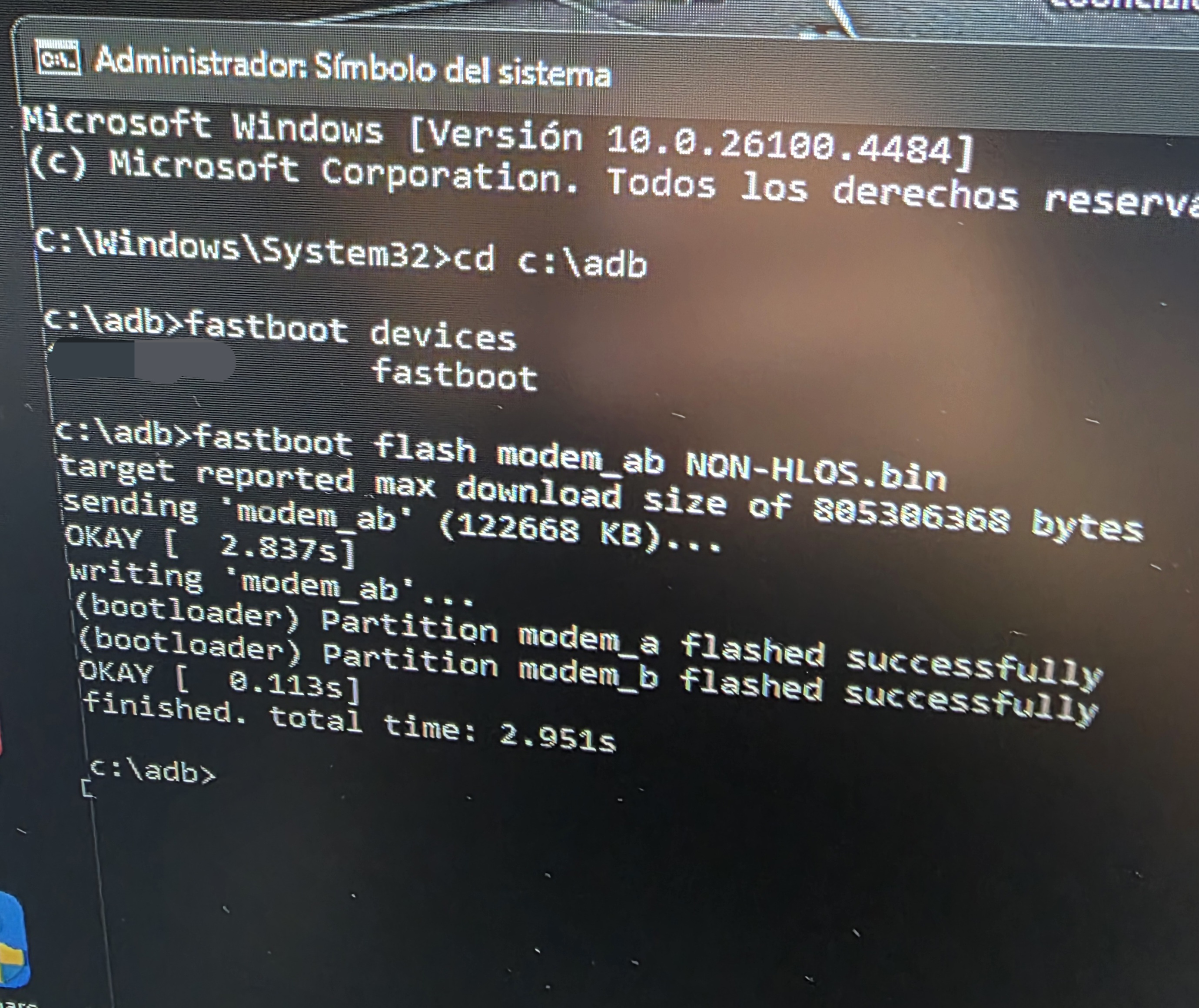

Good morning, I am marked with:
NON-HLOS.bin and Work
Flash_all
fastboot $* flash modem_ab dirname $0/images/NON-HLOS.bin
There was no data signal before.
Before doing that, it didn't mark and there was no data. I already reported it to my beta tester, but he said it didn't happen to the others. I doubt it. I refer to the successes.
Flash_all
Yes, you already said that, and I'm saying that testing modemfirmware.img instead would be more productive, because we're not going to include modem.img in our ROMs and it's not related to cellular network.
Reactions: Marcosuper7
I'm sure you know better what to add than I do, I leave it in your hands. I've done what I could to make this work, but you are the masters.
In addition, as it was also integrated in its day into the 15Ultra which I also have modemfirmware_ww.img
