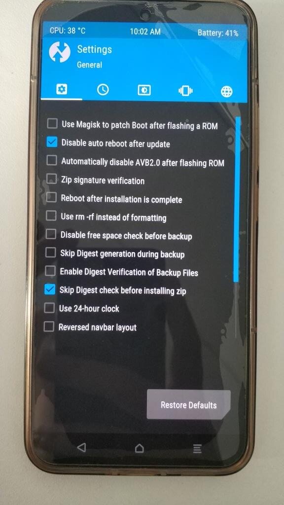

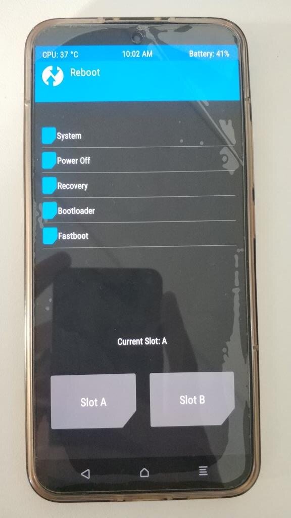

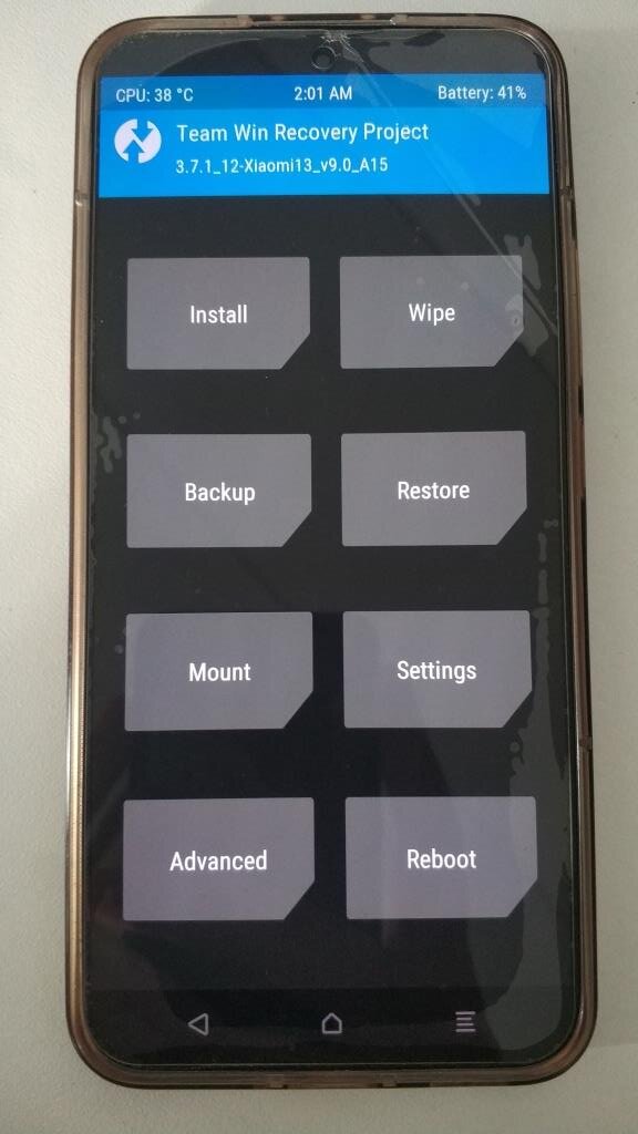

Hey guys, Xiaomi 13 (fuxi) OS2.0.107.0 xiaomi.eu is now installed. A fresh OS2.0.108.0 xiaomi.eu has arrived
Who can tell me why, when updating via the standard updater, it just redirects to TWRP and that's it? The installation process does not start automatically, but in theory it should, isn't it?
The latest recovery is installed: twrp-3.7.1_12-v9.0_A15-fuxi-skkk
Screenshot and photos attached.
Because skkk broke path to /cache partition, so TWRP can't read command sent by Updater as it doesn't exist in TWRP made by skkk.
