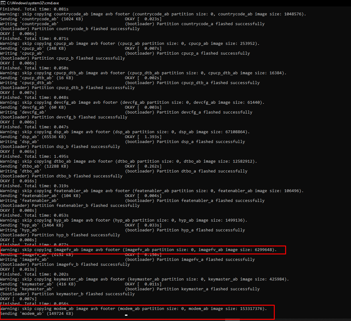

I have a problem with installing HyperOS Stable to my Xioami 14 Ultra phone.
Im trying install windows_fastboot_first_install_with_data_format but as you can see in the pic. It says warning skip copying... My device stuck in fastboot screen.
Can you help me?

Was the same for me . I had to flash the Stock Global with MiFlash first .

Guys i need help. I cant use my phone, device stuck in fastboot mode. Is there any TWRP published for Xioami 14 Ultra I cannot find any.
As I told you before . Download Stock-Global-Fastboot-Rom (aurora_eea_global_images_OS1.0.6.0.UNAEUXM) and install it with MiFlash . Be carefull not to lock your phone . Than boot and switch usb debugging on . Boot in Fastboot and flash Xiaomi.eu
Thank you bro, i did what you said. First flash stock rom and switch USB debugging. Also tried change USB port. In developer settings there was 2 USB debugging setting, I was switch only one. After all, I can flash EU rom my phone. Thanks for help me.
