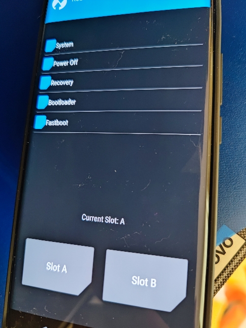

Hi, Im about to update. I have an 12s ultra that is A/B.
According to pictures I shall choose "system" and not "A" or "B" but the phone says that I shall choose "A" after installation.
Skall I follow this instruction in the thread or the instruction the phone gives me?
During install I got error messages in red text, does that affect what I shall do now? See picture.
