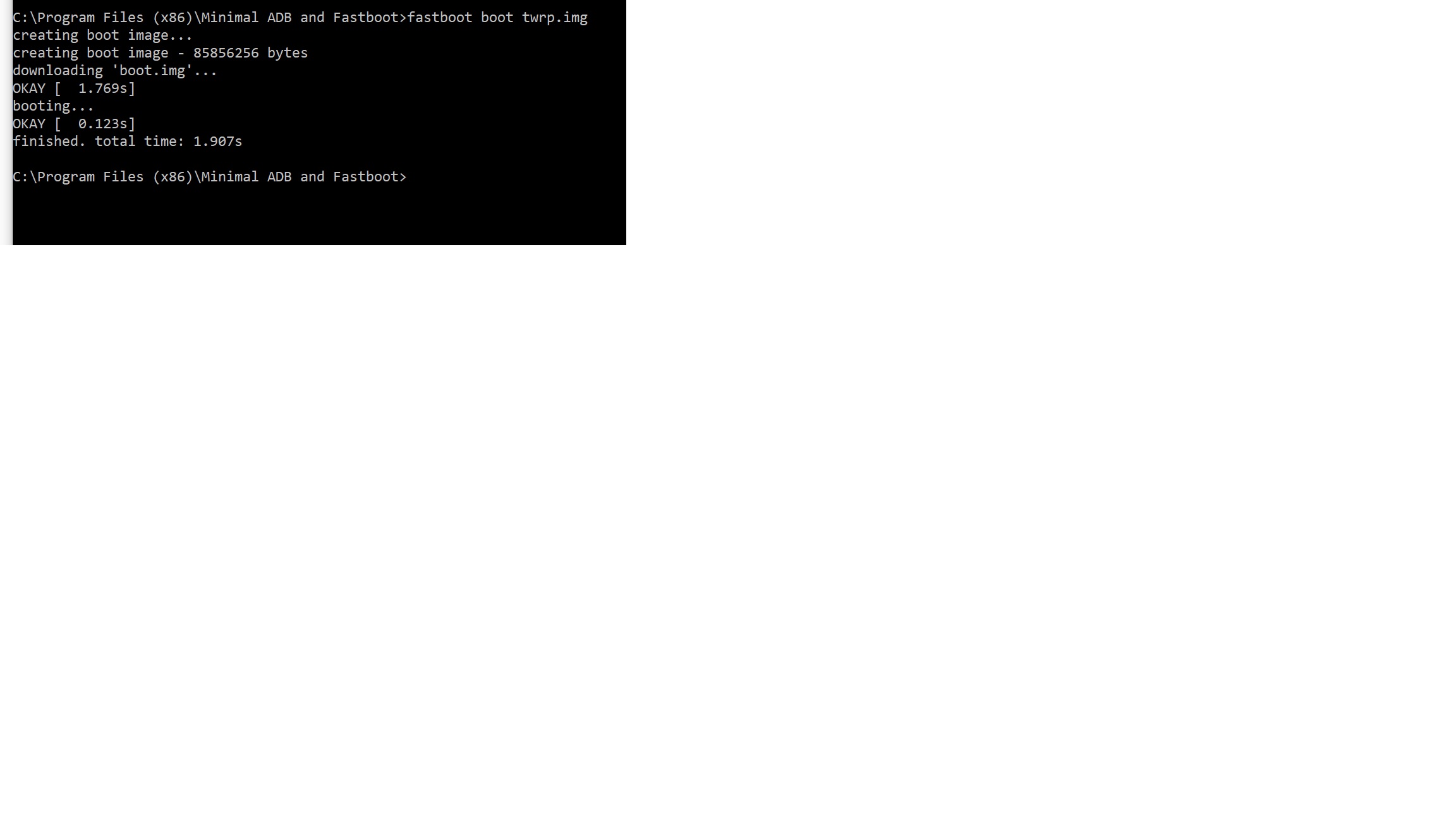

Can someone please help.. 12 Pro here with xiaomi eu v13.0.36 firmware. Im trying to install twrp so I can flash the 13.0..37 but when I run the command in fastboot boot twrp.img ( it says sucesfull) but all I get is the black screen. I cant get TWRP to load at all. I have try all fastboot commands and still black screen. If I reboot the phone, it just opens as notmal phone..
Ideas, help? Thanks

Yes thats the one I used . v5.6 for 12 Pro.
I changed the zip file to twrp.img.
In fastboot i ran command fastboot boot twrp.img
It says creating boot image
downloading boot image
OKAY Booting
Finished!
And thats it, black screen only. I have to reboot to phone to restart it.
So Im basically stuck in unable to flash new firmware cause old one was glitchy and with a few issues.
Any other solutions please?

You still didn't say which TWRP you used (BOOT) or (REC) ?
You can also try the older TWRP 5.1.
PS:
Such a huge picture is really unnecessary. You could only crop the black part with the text.. ;)

Im such a fool, I have it sorted. I used the full twrp zip file rather them unziping it first and then renaming to img, as I just renamed the .zip file first.
Its working now hopefully!
