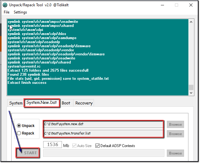

  • now we have to extract the "*.new.dat" files with "IMG_Extractor"
    • open "IMG_Extractor" and change to the tabulator "System.New.Dat"
    • choose your "system.new.dat" and the file "system.transfer.list" and click "Start
    • 28831
    • your "System" files are extracted

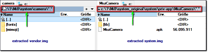

    • copy folder "/system/camera" to your pc
    • 29146
  • now copy the extracted files to your phone
    • folder: /camera/fonts -> /vendor/camera/fonts
    • folder: /camera/mimoji -> /vendor/camera/mimoji
    • folder: /MiuiCamera/lib -> /system/priv-app/MiuiCamera/lib
    • file: /MiuiCamera.apk -> /system/priv-app/MiuiCamera/MiuiCamera.apk
