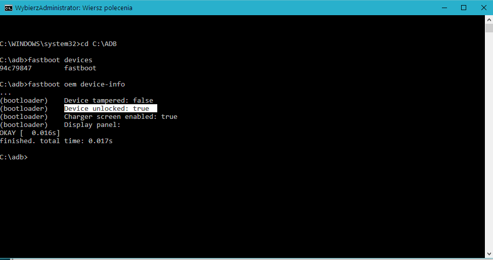

Very good guide, but I have a problem with flashing TWRP my redmi Note 3 Snapdragon pro.
I do everything according to the handbook, but I do not have to filnale TWPR?
Posted scrennshot coincides with my after following the steps in this guide, one difference is sending 'recovery' - here I have less value KB after that, all the same.
I unlocked bootloadrer, I'm ROM China Dev kenzo_images_6.3.31.
I would like to zainstlować rom xiaomi.eu_multi_kenzo_6.3.31_v7-5.1 but I can not przebronąć by the installation TWPR?
Please help in this topic.
Thank you.

@Rafaello sorry mate but I do not understand what you are trying to say here...

Sorry, I don't understand both of you, please try to explain your issue in a comprehensible english. By the way cofface is a reliable developer and you could try his TWRP. You can change default language to english easily.
