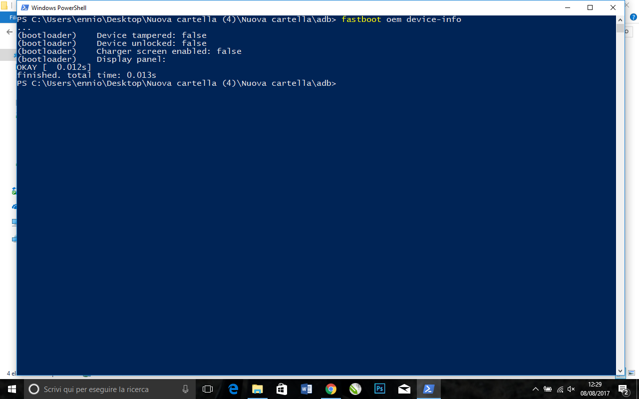

- I started the phone in fastboot
- connect the phone to the pc
- open a command window where you have the adb and fastboot drivers and the following command:
Fastboot oem device-info
and result is?
that doesn't mean its really locked.. if you can boot TWRP by fastboot, means not locked BL...
Reactions: Laplaz
^^ that's the point.
I don't care "she" locked/unlocked as long as she has twrp :p
