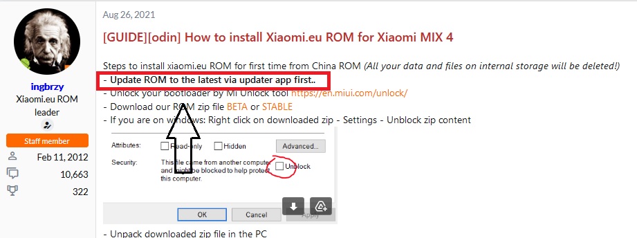

Hi, this might be a newbie question but I´m trying to figure one thing out.
Got myself the mix 4 today and already started the unlocking process so hopefully in a week I can start the installing the stable version from xiaomi.eu but in the instructions first in this thread it mentions that I should "update ROM to the latest via updater app first" (see attached picture)
Is he talking about updating the phone itself to the latest android available OTA or something else? I see the phone is still on MIUI 12 and 13 is now available, but I´m looking to install the newest stable version from xiaomi.eu (12.5) and I´m just wondering if it makes any difference if I update the phone first or just leave it as it is.
Yes, while it's still on China rom, run updater
